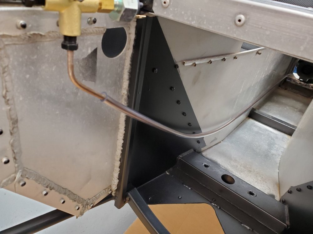

Here is the mount area in the tunnel. The trans is at the builders and I don't have a pic of the mount area, but the Pinto mount that was on it used a single bolt in the center -
