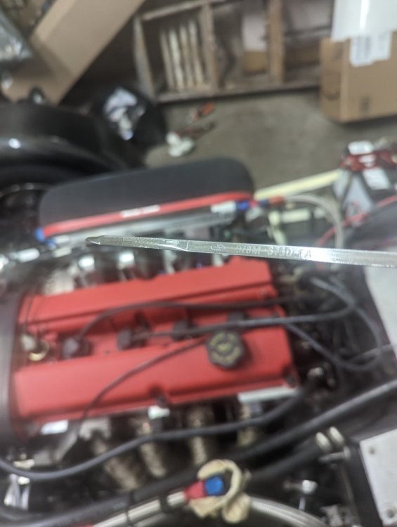

Here is the new scribe mark for the raceline oil pan with 5L. Right through "L" on "full"

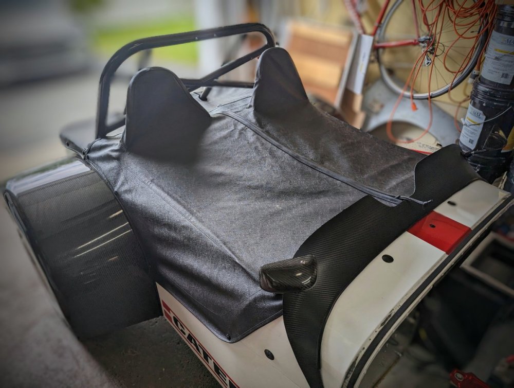

Took only about 3 years but now I'm weather resistant!
Ordered tonneau in 2020 and between everything else going on was reluctant to be punching holes and making it fit.
In the end with the right tools wasn't too bad at all

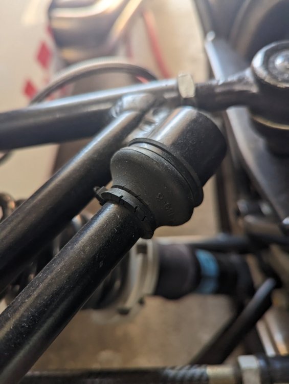

Started doing the headlight move down to lower brackets and already despising the job.

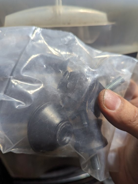

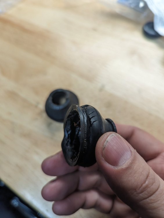

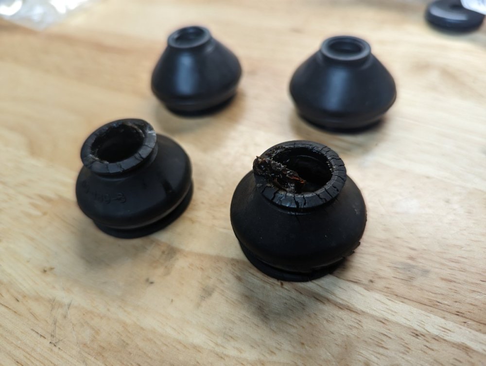

With that said the front sway bar has to be unbolted and since my boots were falling apart I already had replacements in stock

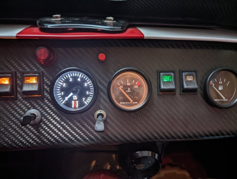

New oil pressure gauge looking good
Now just have to swap the rest of lights on dash to match the brightness
I see the new gauge is back lit led where the others are flood lit. I fit leds to replace the bulbs and provide a more white light. The led replacements are polarity sensitive so they only work when plugged in one way. Should have a number on the bulb you can cross reference. The leds are not dimmable.
Edited by MV8
1 hour ago, IamScotticus said:
What oil pressures are you expecting?
Don't know but I hope to see the needle move up a bit and be in direct ration with the revs.
Old gauge barely moved during regular use and started to freak me out on the highway when it would ready 0 or near 0 for prolonged periods of time late last season.
I've send the oil out to Blackstone in the meantime.
Running the soft line was a huge PITA I'll say that. Maybe I should switch to some sort of braided connection is the results are good and I keep this gauge.
Turns out its a very obscure light bulb. K5632. Looking at options now.
