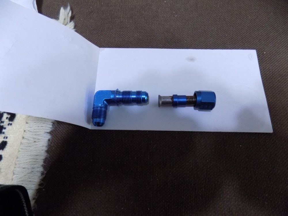

those banjo fittings are for AN       cut the bubble off and use a AN nut + sleeve
I have never seen a banjo for a double flare
Hmm my ignorance showing again.... if you cut the bubble off, then there's no flare at all? It just goes straight into the banjo fitting?
cut the bubble off
slide on an AN nut, then the sleeve
flare the end
pic is some -6 bits from my stash
