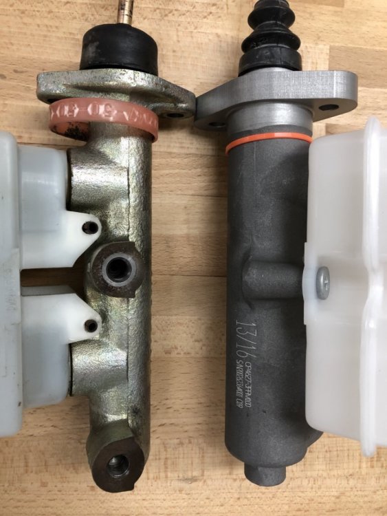

JohnCh Posted May 29, 2021 Posted May 29, 2021 I replaced both master cylinders today. The clutch MC had developed a slow leak which revealed itself a few weeks ago when visiting Bruce Beachman's shop (I suspect the Westfield was punishing me). Whereas the AP Racing brake MC was a planned upgrade. This is the same MC used by Caterham in the R-spec cars, but with slight differences to the lugs to allow more clearance in the Westfield installation. Compared to the stock Girling MC, the AP has a much beefier case, slightly bigger bores 60/40 split vs. 50/50 and each MC is individually shimmed to remove all slack. What a difference! Firmer pedal and much easier to modulate. Highly recommended! -John

Rosteri Posted August 8, 2022 Posted August 8, 2022 (edited) On 5/30/2021 at 12:40 AM, JohnCh said: I replaced both master cylinders today. The clutch MC had developed a slow leak which revealed itself a few weeks ago when visiting Bruce Beachman's shop (I suspect the Westfield was punishing me). Whereas the AP Racing brake MC was a planned upgrade. This is the same MC used by Caterham in the R-spec cars, but with slight differences to the lugs to allow more clearance in the Westfield installation. Compared to the stock Girling MC, the AP has a much beefier case, slightly bigger bores 60/40 split vs. 50/50 and each MC is individually shimmed to remove all slack. What a difference! Firmer pedal and much easier to modulate. Highly recommended! -John John, where did you get the info on the 60/40 split on the uprated AP Master? And are you referring to fluid output or a bore difference? My refurbished standard Girling started leaking at the base of the fluid container and I don’t think the plastic will survive another removal, so I’m figuring out what my options are. Edited August 8, 2022 by Rosteri
JohnCh Posted August 8, 2022 Author Posted August 8, 2022 60/40 split is what was widely stated about that MC in Westfield circles, but AP later confirmed to Westfield Parts Dept and a few others that it's actually a 50/50 split. The bore size is 13/16" and the information about shimming comes from AP's site. -John

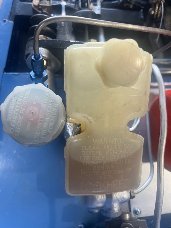

NSXguy Posted August 10, 2022 Posted August 10, 2022 This is the brake master on my 84 cat. Got a rebuilt kit from the UK and just now realized it’s still leaking a little. Very much interested in replacement at this point…
MV8 Posted August 11, 2022 Posted August 11, 2022 I don't think anybody is still making the original reservoir design which I believe is identical to the late mgb original reservoir. I think the replacement master square reservoir from a late mgb would fit the Caterham master (res PN 6505-06041911) and the price should be around $15. I'd probably replumb to fit the 13/16" bore AP replacement from Caterham or use a standard spitfire master.

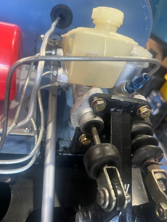

Vinman1 Posted August 11, 2022 Posted August 11, 2022 NSXGuy, This is the AP I got from Caterham on my 79 Seven. All seems good, but I have not driven the car yet (still waiting on Engine). I did fit a clutch m/s next to it, with no problem, as the bowl landed right at the narrow part of the brake m/s. V
