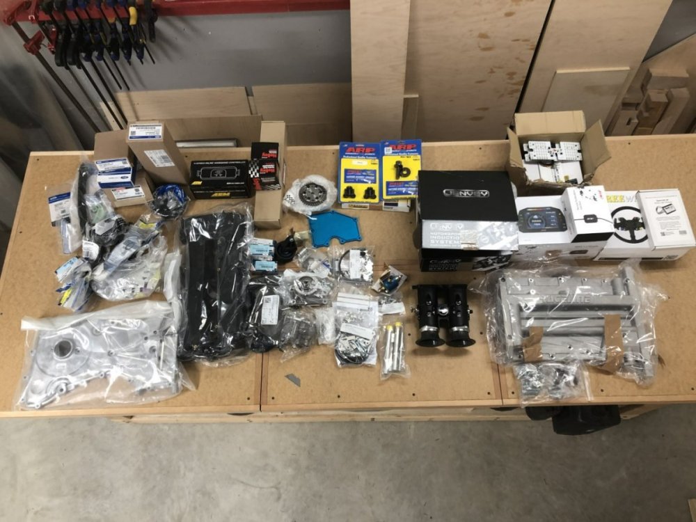

Now that my order has reached the stage where it's locked with Caterham, I thought I'd post an update before the engine build thread begins (hopefully) later this month.  The spec has evolved just a bit from my initial plan.  Changes and decisions include:
  • Heated carbon fiber seats.  Yes, on the surface, heated seats may seem incongruous with a Caterham but they weigh a lot less than a heater and should take the edge off on Fall drives.  Also, the heat helps my back should the Tillets prove less comfortable for me than the Westfield's MOGs.
  • No Track suspension upgrade.  A big concern for this car is the ability to put down power on less than ideal pavement; I don't want to get sideways on a narrow back road when passing a rolling pylon.  After a lot of research, I've decided to go aftermarket with shocks and springs and have ordered a set of CORE dampers from Meteor Motorsport.  The fronts have a digressive valve with linear springs while the rears are normally valved but with progressive springs.  Simon believes this combination will give the best performance.
  • Stock 3.92 rear diff rather than the longer 3.64.  Bruce wasn't convinced Caterham would honor the diff swap request and given I'm unsure on the shape of the torque curve on the new engine, staying stock for now seemed like the better bet.  If the traction control doesn’t work well, then swapping to the 3.64 may be on the winter upgrade list next year.  Or I'll finally need to make progress on exhibiting self control (who am I kidding?)
  • I've decided to stick with the Emerald K6+ native Traction Control rather than use the Race TCS system.  Although I have more confidence in the latter working better, I might as well start with the no-cost option.  Emerald is building the custom ECU loom now.
  • Jenvey 50mm DTHTB vs the larger 52mm.  Dyno tests from Raceline and Esslinger show the smaller set flow more than enough for my power targets and should have a slight edge on idle and low-mid range given the increased air velocity.  As for velocity stacks, there are only two choices in this size: 40mm and 93mm.  I'd prefer to use a cold air box and not cut the bonnet, so I'm starting with the shorter set but reserve the right to make dramatic changes here based on dyno results and how I feel about the torque curve after driving the car.  Longer is definitely better for all but the top of the rev range, but I'm not yet sure I'll need improvements down low.
  • I've opted for the Esslinger Stage 4 cams over the Raceline RDL 270.  They should more than meet my power target and I do like they are an asymmetric setup vs the symmetric for the Racelines (interestingly, their more aggressive RDL 300 cams are asymmetrical.)  The downside to this choice is COVID supply chain issues.  When I placed the order in mid-July I was told they were out-of-stock and would take 4-5 weeks to ship.  Five months later and I still don't have an ETA on when Esslinger's cam grinder will have the blanks for my set.  It's beyond frustrating.
Parts continue to arrive and fill my layout bench.  The next big shipment should be the short block which I'm hoping will ship by the end of next week.

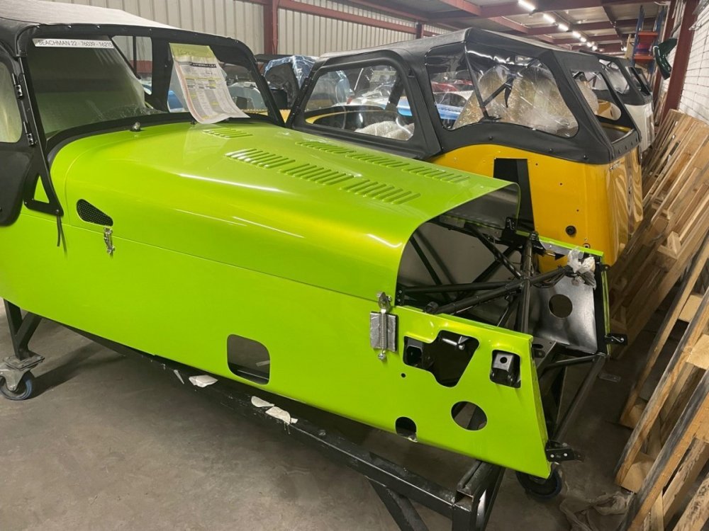

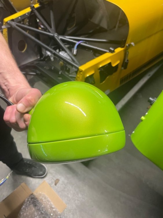

Bruce sent a few photos of my car this morning.  It's complete but still waiting on silicone hoses and the 620 grill before it's ready for pickup by the shippers.  If all goes well, the crates should be in my garage by mid June.
I've seen a number of photos of cars this color in various lighting conditions that reveal it can go from a very bright green in direct sunlight to a little goldish in shadows and indirect light as in the factory shots below.  I suspect it will prove to be a love/hate color.  I'm just hoping I love it.  If not, I suppose I can always keep the Westfield ;)
