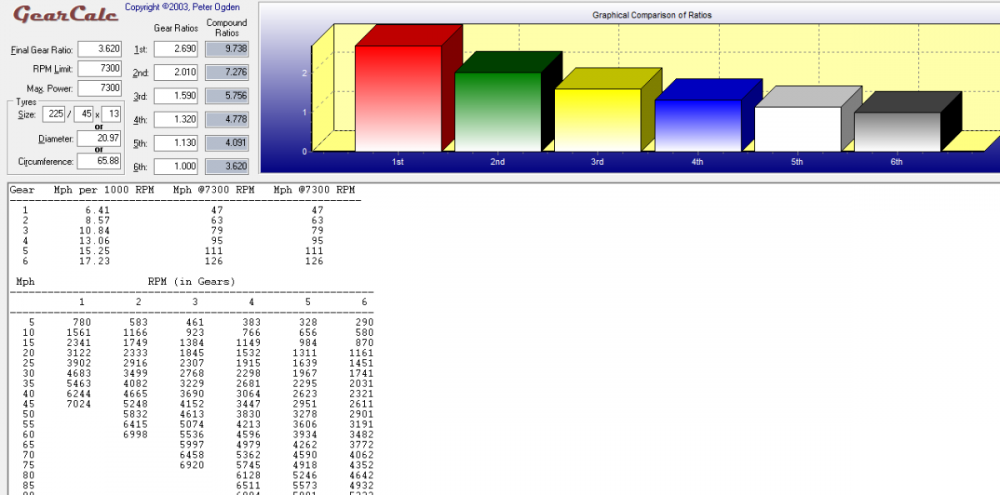

Curiosity got me looking into the gearing so I plotted up the shift speeds to get a sense for how the gears were spread... It wasn't completely clear what the stock T9 gearing was since it depends on the T9 version, but Tom checked the teeth. Didn't want close gears because I'm not racing and want lower rpms at highway speeds for cruising. And I didn't want the tall first gear because of previous posts saying it can be a nuisance for stop/go type driving.

I'd do a little more research on this.  The stock 1st gear is absurdly short on a Se7en, particularly with a 200hp Duratec.  I'm not sure what options Tom has available, but a common gearset upgrade is often referred to as the Long 1st Gear box.  First is 2.98 and the remaining ratios are the same. There are closer ratio sets available that have an even longer 1st (BGH offers 2.83, 2.75, and 2.66), and taller 2nd-5th, but those gear sets are generally better when coupled with a shorter diff ratio.  Speaking from experience, and having run 190hp, 210hp, and ~225hp Duratecs, 2.98 is not too long for street driving, is actually usable, and puts you back in the sweet spot after the shift into second.  I will caveat this by stating my car has a 3.62 diff and 205/60-13 tires, so my gearing is 3.6% shorter than yours, but I'd still get more input before locking that aspect of your order.

I don't know the possibilities of achieving this with a 5 speed but my 6 speed is very well balanced as long as you're not worried about crazy top speed. I personally gladly make that sacrifice.
My first goes to almost 50mph and then very short gears after

My standard short 1st gear isn't quite as bad as it could be because I have larger wheels and a longer diff gear than both JohnCh or Vovchandr. But yes, I could get even longer (actually the longest of all) by choosing the long 1st gear option (long 2.98 rather than 3.65). I had decided that the money for a long 1st wasn't worth it for me, but maybe I'll regret the decision later :( ? My taller tires and longer diff gear also make highway cruising rpm a bit lower which I had read some people whish they had for a quieter experience. Interestingly for comparison, at 75 mph Vovchandr 6th gear shows 4,642 rpm and my 5th gear shows  3,186 rpm. Vovchandr's top gear (6th) is a 1:1 and my top gear (5th) is an overdrive 0.82:1.

When calculating shift points, i.e. how fast the car goes in a specific gear when getting to a specific rpm and needing to shift into the next gear, three factors are used.
  1. Transmission gearing (a different ratio for each gear)
  2. Rear differential gear (a constant value while driving)
  3. Tire/Wheel size (a constant value while driving)
short - refers to a large gear ratio, which results in slower speeds at same rpm
long (tall) - refers to a small gear ratio, which results in faster speeds at same rpm
I ran some scenarios using JohnCh and Vovchandr numbers as well as my own using my own spreadsheet (so hopefully they are accurate).
I have slightly different gear options since my Birkin transmission and differential aren't the same as Caterham.
My setup:
Ford T9 transmission with standard gearing: 3.65 (1st), 1.97 (2nd), 1.37 (3rd), 1.0 (4th), 0.82 (5th)
Subaru R180 Limited Slip Differential: Choice of short 3.90 or long 3.54
By the numbers I'm in the middle of possibilities as my overall gearing is made longer by going with 225/45 - 15" wheels and I opted for the longest rear diff gear at 3.54 (as opposed to my other option of 3.90 with the R180 LSD). But I'd be much worse off with Vovchandr's 13" wheels and my other option of a shorter 3.90 rear diff.
For comparison sake, I assumed a spirited shift point from 1st to 2nd is 6200 rpm. The results of the different scenarios are:
So, if had wheels like Vovchandr and didn't choose any long gearing options, I'd be down at 27.2 mph shift speed. Since I have larger wheels and a longer rear diff gear, my current build is at 32.8 mph shift speed. If I did go with a longer 1st gear option, I'd have the longest overall gearing with a shift speed of 40.2 mph.
Maybe incorrectly, but I decided the optional cost for upgrading to a long 1st gear wasn't worth the 6-7 mph change in shift speed. If I'm wrong, then I'll have to live with it for a while until I can upgrade the gearing :(

There is no universal right or wrong, there is simply what's right for you.  Couple of additional points to consider.  If you are going with a Duratec with cams, you will likely use 7000rpm or potentially 7500rpm for the redline, not 6200rpm (even Ford sets the limiter at 6750rpm for the stock engine in the Focus.)  Although for peace of mind I'd upgrade the rod bolts to ARP for that higher figure.  Tom and his engine guy can provide recommendations for your engine.
The problem with the really short 1st gear is usefulness.  When I first built my car, the 2.0L Duratec had stock cams and Jenvey throttle bodies, a 3.92 open diff and the stock Type-9.  If I eased out the clutch, then nailed it, the rear tires went up in smoke and I was banging off the rev limiter within 15-20 feet.  Next, I swapped in a 3.62 diff with limited slip.  Now I could make it a bit farther, but anything close to 3/4 throttle in 1st was still pretty pointless.  It simply couldn't put down the power.  Next I went to a BGH gearbox with the 2.98 1st.  Yes, I could still get a little wheel spin in 1st, but it was entirely usable and it has never felt remotely tall.

I chose 6,200 rpm as just an arbitrary value and not redline.
I did verify with Tom, and you are correct in that he sets the redline for 7,000 rpm. Here is the same analysis with redline 7,000 rpm, instead of the arbitrary 6,200 rpm. Of course the shift speeds go up, but still the same relative differences.
