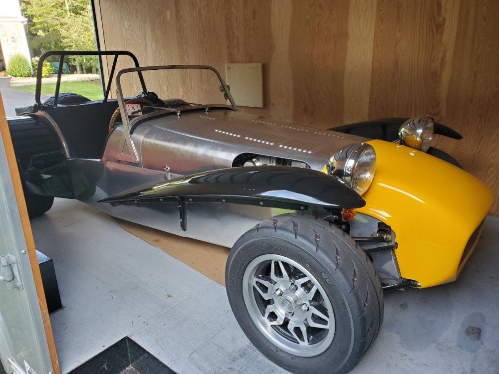

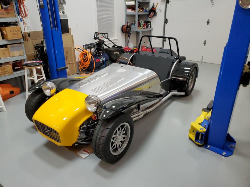

Vinman1 Posted December 11, 2022 Author Posted December 11, 2022 (edited) Hope all are doing well. Had the "reveal" day for the Seven with Lars family, friends and fellow car addicts. It was a great sunny day with a good time had by all and only tears of joy! Having got to this point, the best advise I can give to anyone who takes on a car build project is to: 1) Seek out the best clubs and join them. In this case, could not have done it without all the help from USA'7s, Simple Sevens, and the Cape Cod British car club. Cheers to all and hope to pass on some lessons learned to pay it forward! 2) If you don't know how to fabricate either learn quick or find someone close by who can, you will need to fabricate some items from scratch, in my case it was brackets for fuel pump, fuel filter, throttle linkage, cooling fan mount, radiator mount, alternator mount, clutch feed hose bracket, cover, roll bar mounts, fuse box mount, and transmission mount, etc. Many thanks to all, hope to meet swap stories in person! V Edited December 18, 2022 by Vinman1 2

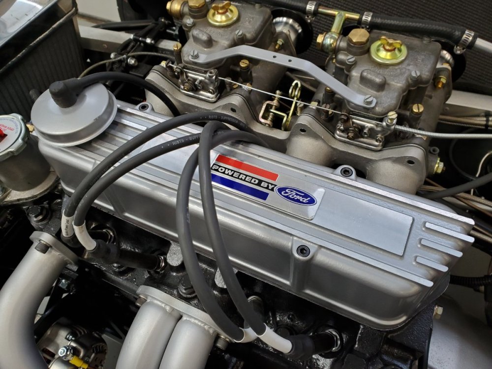

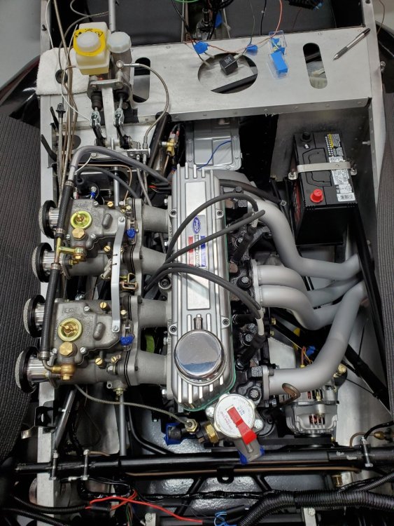

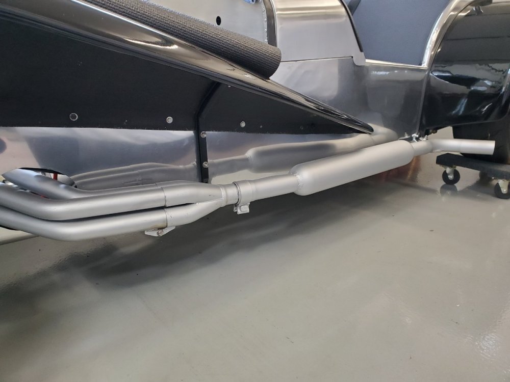

IamScotticus Posted April 15, 2023 Posted April 15, 2023 (edited) V, Are those pipes packed? where from? And that rocker cover? Edited April 15, 2023 by IamScotticus
NSXguy Posted April 15, 2023 Posted April 15, 2023 1 hour ago, IamScotticus said: V, Are those pipes packed? where from? And that rocker cover? I'm eyeing that rocker cover as well
Vinman1 Posted April 15, 2023 Author Posted April 15, 2023 Hey guys, The pipes in the photo you have seen are not packed, that is the "track day" pipe. I have a a road pipe as well. The valve cover is a Burton item that they sell only in Red or Black. Did not like those colors so, I sanded the outside, masked off the bare aluminum raised areas, and painted with silver engine paint. The powered by Ford badge is an Ebay or Amazon item.

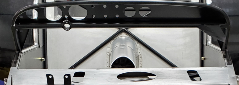

Vinman1 Posted April 18, 2023 Author Posted April 18, 2023 Scott, I have been pondering how to go about that, and now have to get to it before putting the windscreen on. Toldfield, thank you for informing me of a tool I never knew of. Will search info on how to use it, and hope it solves the issue of drilling in the wrong place. Chris, thank you for the compliment, greatly appreciated.
Vinman1 Posted April 18, 2023 Author Posted April 18, 2023 Scott, My body does not have the holes in the skins either. I have not looked at any drawings, but I take it there should holes under it in the frame? V
toldfield Posted April 18, 2023 Posted April 18, 2023 YouTube to the rescue. If Cape Cod Gateway airport is handy find the EAA chapter there and you will find people that are knowledgeable and likely very helpful. https://www.youtube.com/watch?v=DLpXnykw5dA tom
Vinman1 Posted April 18, 2023 Author Posted April 18, 2023 Watched the video, pretty slick! Just have to figure out what is under the skin that was already on the car. From frame drawings, and web search, perhaps the scuttle tab bolt go through the outer and inner skins, in the corner where the square down tube meets the horizontal round tube? Scott, not sure what you mean by rivnutting the fronts? The only other attachment for the scuttle I have is are the four vertical studs welded to the frame, which use steel u channel brackets to clamp down on the formed U channel of the scuttle. Here are the U channel brackets sitting on the four studs.
IamScotticus Posted April 20, 2023 Posted April 20, 2023 (edited) Vin, its a common mod for ease of access under the scuttle to drill out the rivets securing the front edge to the bulkhead, inserting rivnuts to the bulkhead, then attaching the scuttle with screws instead of rivets Edited April 20, 2023 by IamScotticus
