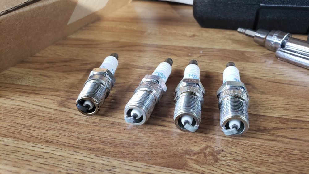

KnifeySpoony Posted June 12, 2022 Author Posted June 12, 2022 Also I didn't put any fresh dielectric grease on the new plugs - is it important enough to make a difference?
Croc Posted June 12, 2022 Posted June 12, 2022 Originals look fine. The recent switch in also look fine except for 4 which is a little carbon fouled. That would indicate a rich mixture or weak spark not getting optimium combustion. Seems to line up with the issue of not getting consistent or a weak spark. I would not worry about the dielectric grease. Its fine for now.
KnifeySpoony Posted June 12, 2022 Author Posted June 12, 2022 Will the datalogging show the location of misfire(s)? Or will I need to swap things around and read the plugs?
Croc Posted June 12, 2022 Posted June 12, 2022 Swap around and read plugs. However, I think you found a likely candidate with your spark plug test.

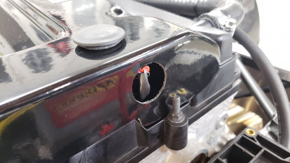

Austin David Posted August 12, 2022 Posted August 12, 2022 Catching up on this based on our chat yesterday. The problem you described (and showed me) seemed like a potential issue for *all* duratec cars, mine included. Could you describe the fix and maybe a shot of the wiring under the coil cover? You drive harder than I probably ever will, but the fix seems easy enough that I'm gonna just do it proactively. I've also read that tucking the coil wires might help keep that cover off my bonnet, so I mean to get in this weekend and see if I can clean it up, and prevent this "broken #4 plug wire" issue.
KnifeySpoony Posted August 12, 2022 Author Posted August 12, 2022 2 hours ago, Austin David said: Catching up on this based on our chat yesterday. The problem you described (and showed me) seemed like a potential issue for *all* duratec cars, mine included. Could you describe the fix and maybe a shot of the wiring under the coil cover? You drive harder than I probably ever will, but the fix seems easy enough that I'm gonna just do it proactively. I've also read that tucking the coil wires might help keep that cover off my bonnet, so I mean to get in this weekend and see if I can clean it up, and prevent this "broken #4 plug wire" issue. The wires failed right where they enter the connector that plugs into the coil for #4. I'm pretty sure that the aft edge of the plug dust cover (or whatever it's called) was rubbing on the wire there and caused the failure. Interestingly, there is a hole there that was filled with a grommet. The grommet was in contact with the wire there. My belief is that the cam cover rubbing on the wire was a known failure point and Caterham decided to "solve" the problem by drilling the hole, then filling it with a grommet to "punch out" the space there a little bit to clear the wire. However, the solution didn't work well. I decided to just leave the grommet out, which gives the wire ample clearance it seems. Another option is to just ditch the cover entirely. Unless driving in flooding rain (which I never intend to do), I don't see its purpose.
Austin David Posted August 14, 2022 Posted August 14, 2022 Thanks. I pulled my cover today and removed the grommet for now. It was definitely close, not sure if it was under a lot of pressure but easy enough to prevent. I might fashion a rain cover if I get boreder.
