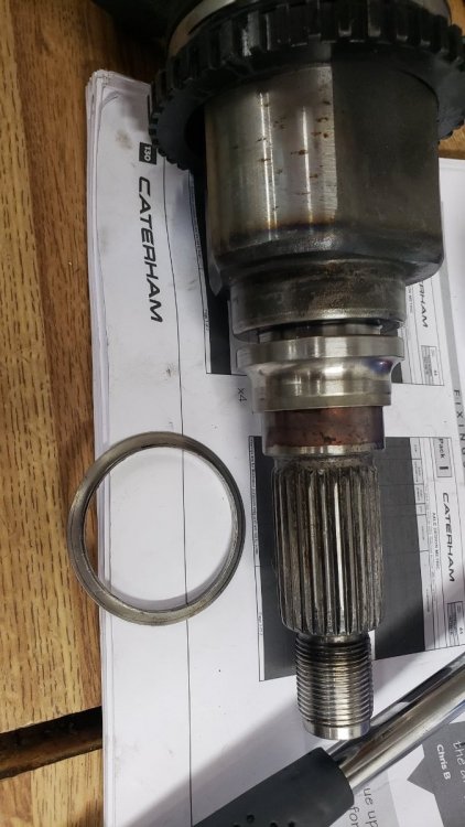

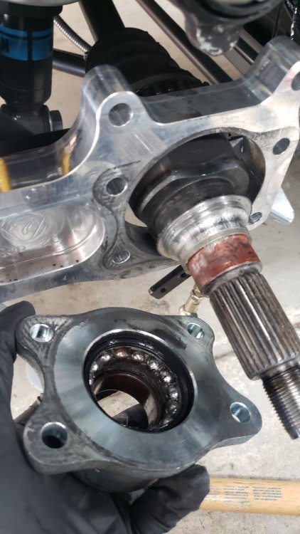

KnifeySpoony Posted August 28, 2022 Author Share Posted August 28, 2022 (edited) OK update- i got it off... KIND OF. The fukn bearing split in half. So now the inner half of the inner race is stuck on the driveshaft... I tried to tap it off of the driveshaft- the thin ring came off (and got slightly bent in the process), but the race only moved a bit and got stuck. Looks like a need a proper bearing puller - I hope it will be able to fit into that small gap. Edited August 28, 2022 by KnifeySpoony Link to comment Share on other sites More sharing options...

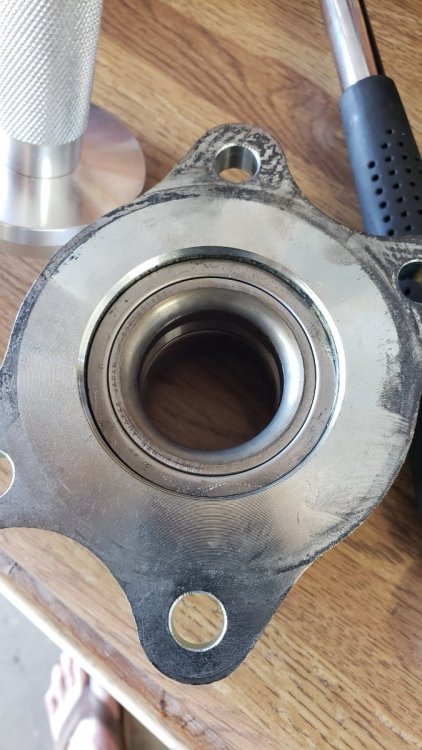

KnifeySpoony Posted August 28, 2022 Author Share Posted August 28, 2022 (edited) Also, is this bearing salvageable, or not? Is the ring seal being slightly bent a deal breaker? Or will it flatten out if pressed back in? Edited August 28, 2022 by KnifeySpoony Link to comment Share on other sites More sharing options...

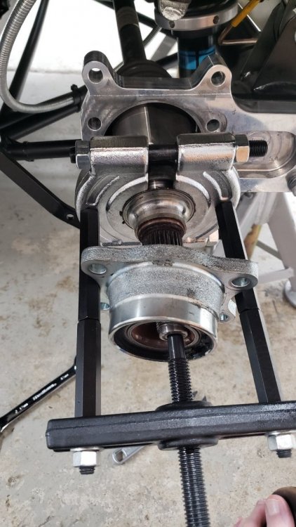

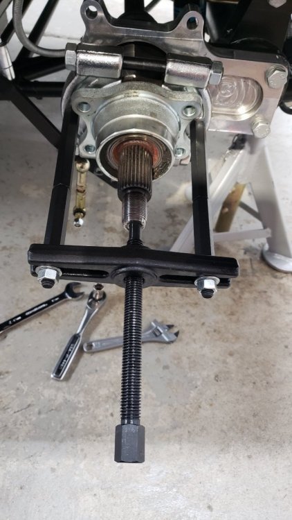

MV8 Posted August 28, 2022 Share Posted August 28, 2022 (edited) Do not use a 2 or 3 jaw puller. Use this kit with all the necessary bits. Clamp the knife-edged clam shells around evenly and not especially tight, then add the H bar and threaded rods to evenly pull it off. Grease the threads. Should pop back together on the hardened inner. No problem if you don't crease the inner dust ring trying to put it back in and it is not stretched, loosening the fit to the inner race od. Tap around the circumference to reinstall. https://www.ebay.com/itm/313569109324?_trkparms=amclksrc%3DITM%26aid%3D1110006%26algo%3DHOMESPLICE.SIM%26ao%3D1%26asc%3D241587%26meid%3D06ce783277ce462bae8c7562c757c419%26pid%3D101195%26rk%3D5%26rkt%3D12%26sd%3D312653842810%26itm%3D313569109324%26pmt%3D1%26noa%3D0%26pg%3D2047675%26algv%3DSimplAMLv11WebTrimmedV3MskuAspectsV202110NoVariantSeedKnnRecallV1%26brand%3D8milelake&_trksid=p2047675.c101195.m1851&amdata=cksum%3A31356910932406ce783277ce462bae8c7562c757c419|enc%3AAQAHAAABMMFr2e4EmAnM%2ByHZkULYKDIJ4L66fOjNL0iupgt%2BzO1%2F3AE1t3mNirUYB96NktMCicMagiS6mbeTl0xquGODv9mza5EI4qt7uNzzvEoOJav987%2B02NN%2Bku14aeBggJT5Kzvtke0lTQip37Buk3VGsP1PZLzoBPTxf9gIvHs9qf9hwoyihfBzHJMH9qKQZn2cIIjyJe3uzWbH%2FZhgRmP9otRo0aSc15mCLV1kN4RidMJZYZYzCRWywZ%2FUlRLbrJbm%2FkPyrs2QKBxrKerqejqvXAa3glpJ76vBenvlG6lnPlk6IzILL9aK%2BIEr2hBTDMPVgtdrUv8vsije2FHkEdRHdJnt3wwdn%2BmqrCT%2FK2g8Upw6jkBLYde71%2BLqwOPhn%2BqkzyWg%2FCYTipdm3qWxY4mGJMg%3D|ampid%3APL_CLK|clp%3A2047675&epid=23012962892 Edited August 28, 2022 by MV8 Link to comment Share on other sites More sharing options...

KnifeySpoony Posted August 28, 2022 Author Share Posted August 28, 2022 (edited) Update - OK I bought the HF puller and drift sets. I was able to get it off easily with that. After reassembling the bearing, the inner race turned with significantly more friction than the outer. A bit concerning. So then I went to the other side - used the puller to pull on the bearing housing rather than hitting the axle with hammer. Worked a charm although... the bearing split apart again. However now with the housing out of the way I could use the puller to engage the inner race and easily pull it off the driveshaft, with the seal still in place. I reassembled again, and even though it popped in nicely, and the undamaged seal was not binding at all, the inner race once again showed increased friction. Edited August 28, 2022 by KnifeySpoony Link to comment Share on other sites More sharing options...
