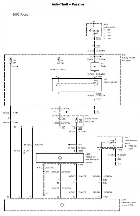

jordway Posted November 4, 2022 Posted November 4, 2022 I'd been having a similar problem with a 2004 Zetec SVT. I got lots of great guidance from this forum on things to test out, but eventually I ran out of ideas and finally took it to a professional who has some Sevens experience. After thoroughly checking through all the possible culprits, he also came to the conclusion that it was this PATS problem, and we were about to head down the ECU rabbit hole. I followed the advice in this discussion to look on Focus technical forums (thanks, @Tabor10 and @Kitcat). It was certainly not hard to find many examples of Focus PATS problems that sounded far too familiar. One piece of advice that was followed by many Focus owners saying "That Worked!!!" was to disconnect the battery (or in my case just switch off the battery master), put the key in and turn it to on, reconnect the battery and then switch the key off and on again. Apparently, this can reset the connection between the key chip and the module. I'll be damned if it didn't work. Starts right up every time now. But, I do like the idea of taking the chip out of the key and taping it onto the module. So, I'm not saying this will magically fix your problem, but it's free to try it. I honestly didn't think it would work, but it did. At least in my case, @MV8 was spot on about it being a minor thing and easy to "repair". Honestly, I didn't even know the car had a PATS while I was checking fuel pressure, plugs, crank sensor, phantom battery drain.... on and on. Good luck. 2 1
IamScotticus Posted November 4, 2022 Posted November 4, 2022 On 11/4/2022 at 10:16 PM, jordway said: One piece of advice that was followed by many Focus owners saying "That Worked!!!" was to disconnect the battery (or in my case just switch off the battery master), put the key in and turn it to on, reconnect the battery and then switch the key off and on again. Apparently, this can reset the connection between the key chip and the module. I'll be damned if it didn't work. Starts right up every time now. But, I do like the idea of taking the chip out of the key and taping it onto the module Expand This is golden

HUTCH Posted November 10, 2022 Author Posted November 10, 2022 what is the ?scuttle" and what is RMSCI? If I found all this stuff the fact would be that the unit does not work as is. all the replacements have pats what would be the story with the dtuff like the black box? TRIED THE KEY AND BATTERY IDEA NO GO THE IGNITION SWITCH IS NOT ELECTRONIC NO PATS SYSTEM STILL NEED IDEAS
