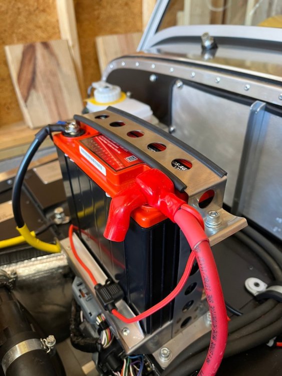

Yoram Posted October 15, 2024 Author Posted October 15, 2024 (edited) 57 minutes ago, JohnCh said: If you want to approach the problem from a different perspective, consider buying motorcycle jumper cables. Their smaller clamps work well with the bolt heads on the battery. I carry these on tour and have jumped a Caterham with a PC680. https://www.amazon.com/gp/product/B000UKD6II/ Love the benefits of a creative community! Always a new angle you haven't thought about. Thanks, John! Having invested already a bit of time and "emotional buy-in" into the conventional jumpers solution, will try for now to see it through. Just ordered on Amazon 10' of red 3/8" ID x 5/8" OD silicone hose for $5. https://www.amazon.com/dp/B0BXSQN2XV?smid=A132D7PL1YID8X&ref_=chk_typ_imgToDp&th=1 We'll see if/how a short length will fit on my little bracket. (oooops, haven't caught at first the visual one can get reading this, but will leave it there... ) Edited October 15, 2024 by Yoram
pethier Posted October 15, 2024 Posted October 15, 2024 29 minutes ago, Yoram said: Love the benefits of a creative community! Always a new angle you haven't thought about. Thanks, John! Having invested already a bit of time and "emotional buy-in" into the conventional jumpers solution, will try for now to see it through. Just ordered on Amazon 10' of red 3/8" ID x 5/8" OD silicone hose for $5. https://www.amazon.com/dp/B0BXSQN2XV?smid=A132D7PL1YID8X&ref_=chk_typ_imgToDp&th=1 We'll see if/how a short length will fit on my little bracket. (oooops, haven't caught at first the visual one can get reading this, but will leave it there... ) We are car guys, not middle-school kids. 1
CBuff Posted October 15, 2024 Posted October 15, 2024 I think you could do shrink tube. Adhesive on the horizontal portion of the tab. And non adhesive on the vertical leg. Making it removable. While heated pinch the end with pliers to make a cap. https://www.cabletiesandmore.com/heat-shrink-tubing-2-1?pid=1262&gad_source=1&gbraid=0AAAAADfXKhj64GLT7gr0mo9-a42_2eD6z&gclid=Cj0KCQjwgrO4BhC2ARIsAKQ7zUkCR5KkTBAIrvaia4MFBwKSJzdyeCqA6ilYVY00MDgkIzYcOFDlVHEaAt2ZEALw_wcB 1
Yoram Posted October 15, 2024 Author Posted October 15, 2024 13 hours ago, CBuff said: I think you could do shrink tube. Adhesive on the horizontal portion of the tab. And non adhesive on the vertical leg. Making it removable. While heated pinch the end with pliers to make a cap. https://www.cabletiesandmore.com/heat-shrink-tubing-2-1?pid=1262&gad_source=1&gbraid=0AAAAADfXKhj64GLT7gr0mo9-a42_2eD6z&gclid=Cj0KCQjwgrO4BhC2ARIsAKQ7zUkCR5KkTBAIrvaia4MFBwKSJzdyeCqA6ilYVY00MDgkIzYcOFDlVHEaAt2ZEALw_wcB Thanks! Will try this next if the silicone hose does not work.
Yoram Posted October 17, 2024 Author Posted October 17, 2024 On 10/14/2024 at 8:38 PM, JohnCh said: If you want to approach the problem from a different perspective, consider buying motorcycle jumper cables. Their smaller clamps work well with the bolt heads on the battery. I carry these on tour and have jumped a Caterham with a PC680. https://www.amazon.com/gp/product/B000UKD6II/ I ended up ordering a pair of these jumpers, primarily because they are much smaller and lighter (shorter and smaller gauge) than the sets I have in the other cars, so more fitting for the 7... I will keep my terminal mods for now (belt and suspenders approach) and report about the success or otherwise of my contraceptive solution.

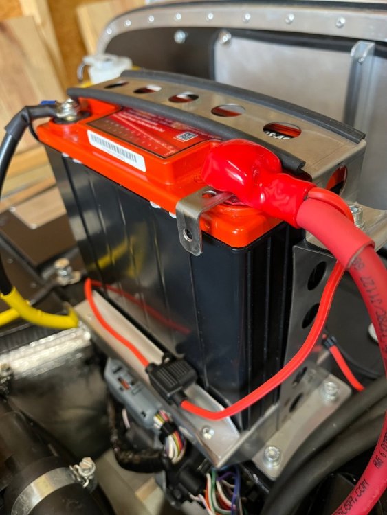

Yoram Posted October 18, 2024 Author Posted October 18, 2024 (edited) The silicone hose (see my post above from 10/14) did the trick. It was not too hard to push around the corner to cover the entire length of the exposed bracket. Before: After: Seems quite tight. And please no one suggest this reminds them of Peyronie's disease. Cheers. Edited October 19, 2024 by Yoram

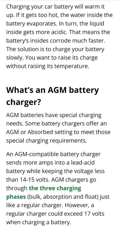

Yoram Posted January 8, 2025 Author Posted January 8, 2025 Don't know almost nothing regarding batteries... googling (or duckduckgoing in my case) like most of us... From the little I read, AGM batteries cannot tolerate high charging voltage levels at the level of regular ("flooded") batteries and risk popping their safety valve and losing capacity. To my understanding this is because the internal resistance of AGM batteries is lower and therefore the charging current at a given voltage would be higher, which may create overheating and popping of the safety valve. Also to my (limited!) understanding, trickle/maintenance charging is not the main risk. Deep charging under high current of a deeply discharged battery is mainly where one needs to be careful and use an AGM charger or an AGM setting. Since I switched to an AGM battery and needed to do both (deep and trickle charging) I decided to invest in a charger with "regular" and AGM settings. These are very common and affordable nowadays. But I plead the Fifth... 1
