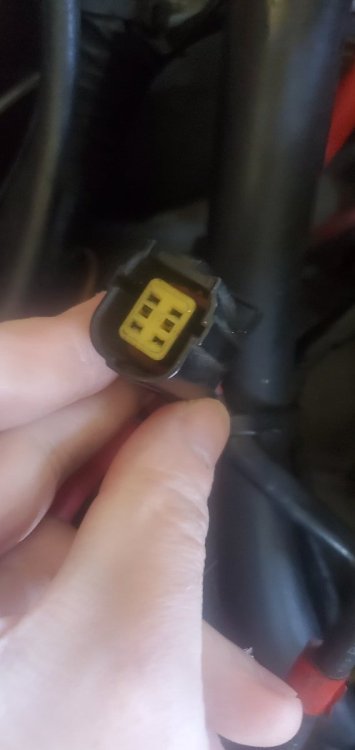

slowdude Posted May 5, 2024 Author Posted May 5, 2024 And back to it. Noticed I'm running super rich and don't have a lambda / wideband O2 sensor. Also noticed a frayed and disconnected vacuum line off the EGR which connected to the fuel pressure relay. Trimmed the line and re attached it to the EGR (just to provide a terminus for the vacuum line as I don't have a cap). Haven't driven it since fixing this vacuum leak. In the meantime, I have gone through the EU2 K series loom as I noticed I have an open 4 pin connector for a wide band / lambda. I am on a powerspeed 4 into 1 exhaust, so I will have to get a bung installed on the exhaust. Hoping that @NSXguy's friend is available. The goal is to get the stock ecu recognizing a 4 pin lambda, so that in turn, I can get it to close the loop and adjust the over fuelling. I'm not trying to wash the rings on the new engine. Once I've determined it's working on the rover MEMS 1.6 that I have, I will be one step closer to installing the emerald ECU (need to check timing etc etc etc). Been going down the rabbit hole on this and will probably do a few posts about the emerald ECU / Rover K series EU2 loom and lambda sensor setup etc. I'm glad I caught this with only 1500 or so miles on the engine post rebuild, otherwise it could be way worse. Pic attached of the open lambda loom / harness connector, along with link from Revilla on blatchat who was able to help me, along with lambdasensor.co.uk Harness / Loom diagram.
MV8 Posted May 5, 2024 Posted May 5, 2024 (edited) No experience with these engines or ecus, but what makes you think this is a wideband and not just a four wire hego? I suggest fitting a replacement o2 sensor for this ecu. lambda and wideband are not compatible/interchangeable for wiring or sensor output without software calibration. I don't know why a fuel pressure relay would have a vacuum port but the evap cannister purge does. I don't see electronic egr vacuum control function on this ecu diagram. This is very confusing. I would expect to see a vacuum hose from the intake manifold to a fuel pressure regulator to reduce pressure (and richness) at idle and part throttle, and generally a fuel pressure of around 40 psi at idle. Edited May 5, 2024 by MV8 1
Vovchandr Posted May 5, 2024 Posted May 5, 2024 In my experience all the widebands I've seen are 6 pin. With that said if you have a downstream o2 sensor you can just pull it out and plug the wideband into that bung without having to do any welding. I've done that for a while. 1

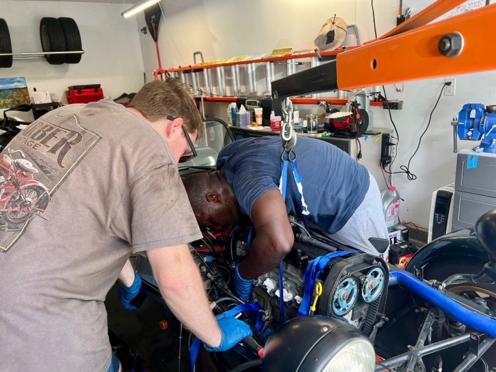

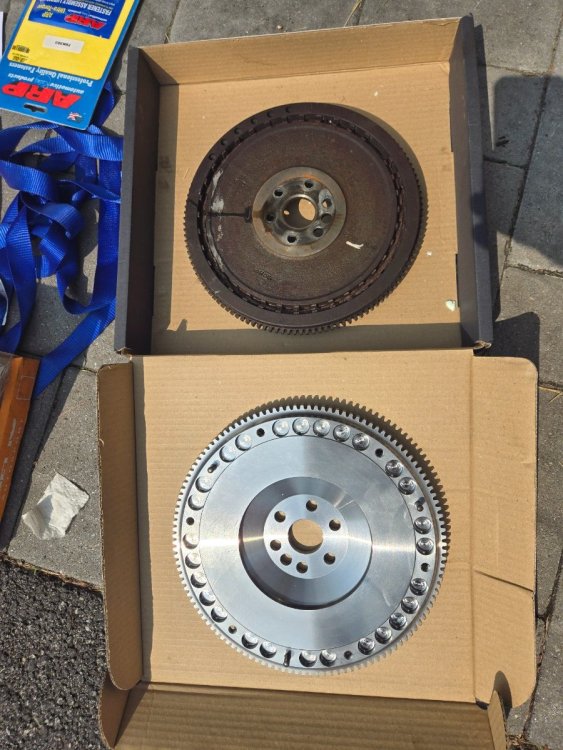

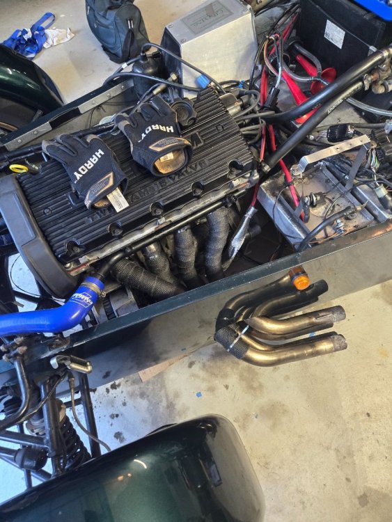

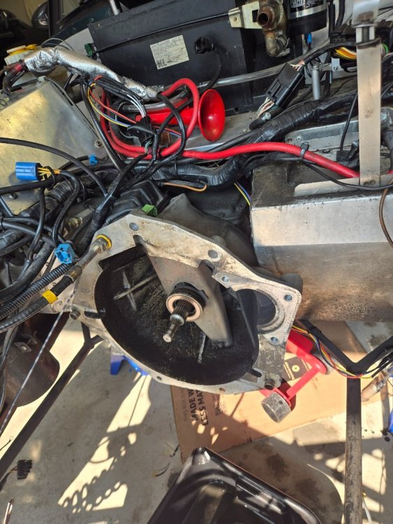

slowdude Posted August 3, 2024 Author Posted August 3, 2024 (edited) Update for the non northeast 7s group chat members / rolling diary of work done to the car. Absolutely massive thanks to Des for showing up and pulling an engine, doing the clutch and flywheel, then reinstalling the engine in 4.5 hours. Replaced clutch (helix), clutch cover, flywheel (lightened, half the weight of the stock), CRB and spigot bearing. While the car was out, replaced a water rail temperature sensor. Wrapped exhaust header, wire rushed some cooling system pieces. Replaced intake manifold gasket. Need to adjust the ECU to recognize the new crank trigger, fill and bleed cooling system, and get exhaust bung welded for wideband. Adjust the clutch and then it's break in the clutch. I think I figured out my rattle. CRB had significant side to side movement, causing the clutch fork to rattle side to side, along with forward and back. Hopefully the new CRB will quiet down this clutch fork play. Small rear main seal leak that hasn't been affecting the car, so left as is. Looking forward to bedding the car in before the Sept track day. Edited August 3, 2024 by slowdude 1
slowdude Posted August 12, 2024 Author Posted August 12, 2024 Got it back together, got ecu updated for new flywheel pattern. Banging my head on the wall with this no start issue. I can't see anything unplugged, clutch has been backed off at the box so it's not super tight and putting pressure. Put a mark on the crank, starter is engaging with flywheel and turning engine. @MV8 any thoughts? What's going on in that noggin of yours? I noticed I had some super frayed starter wires, so re crimped them thinking I was getting voltage drop, but Still making this ZZZ noise. Checked relays. MFRU isnt triggered since the fuel pump is priming. ECU is registering crank position sensor on new flywheel, plugs seem to have fuel (smelled it on plugs when i pulled), coil/rotor arm/plugs are new. Still digging but banging my head against the wall.
