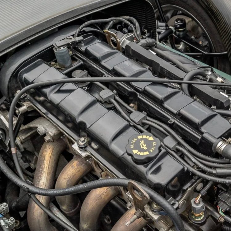

There is a member here, I think "Turbofocus" that offers a Variable Valve Timing "delete" option.  That solenoid is very expensive to replace, and they do eventually "go bad."
On my car, I cut out the top of the cover, and did not add the duct tape mod.  It sometimes rubs the bonnet, but just barely, and I can live with that. I think there was one member here who shaved down the motor mounts or motor mount brackets by 1/4 inch to accommodate the solenoid's height.

Seems like a lot of work for a little clearance on an otherwise unmodded duratec. The hole could be plugged, but the variable cam gear assembly would need to be locked in some way or replaced with a fixed/solid gear, tuning reprogram to eliminate changes based on cam timing commands that won't occur, and eliminate the ecu setting a code/limp home mode due to no solenoid detected.
Mine was knocked off and destroyed in a track day incident. Josh, at Rocky Mountain Caterham, was unable to find a direct replacement so used the closest thing he could find. Unfortunately, it stuck up even further.
Focus-Power in North Carolina is a source of expertise on the SVT and may have a solution.
Aftermarket companies like Dorman are filling the oem gap for replacement VVT solenoids, but they don't appear to have one as a direct fit for early duratecs.
