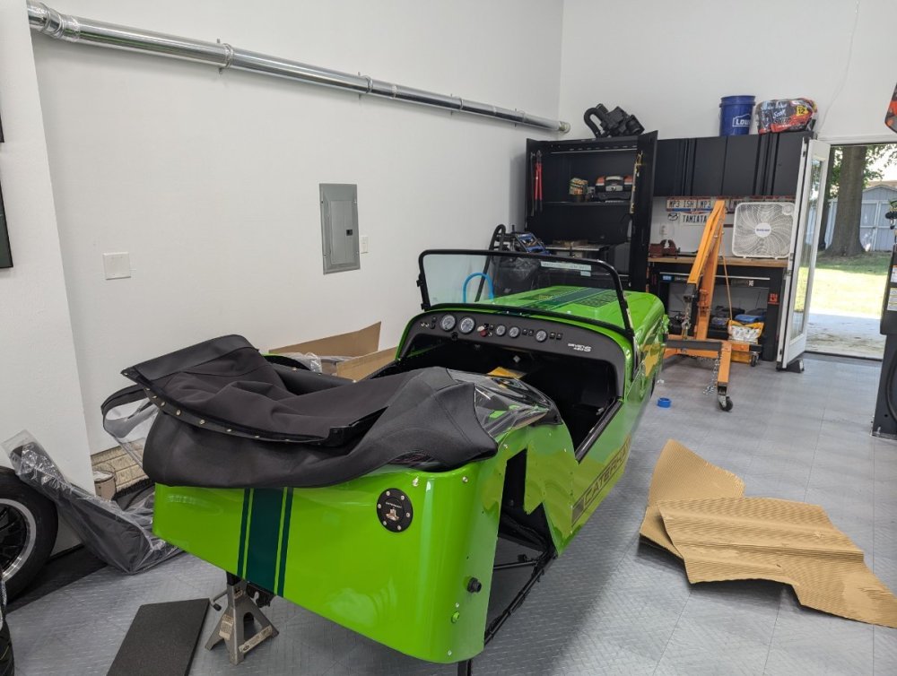

hyper7 Posted August 24, 2024 Posted August 24, 2024 Got my seven yesterday, so far just started digging through boxes and trying to figure out what I'm missing/need...so far the only obvious thing is a battery. I'll keep updating here as I go, but just excited to finally get this going!! 3

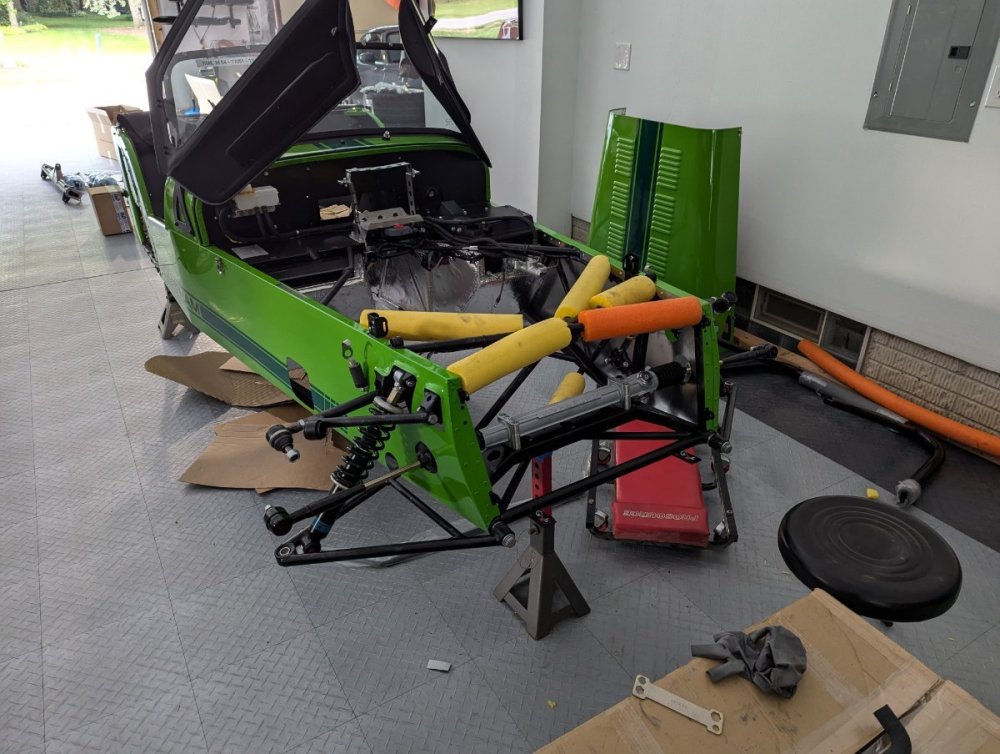

hyper7 Posted August 30, 2024 Author Posted August 30, 2024 Got the wingstays, uprights, sway bar and headlights on today, but the damn heat gun disformed the indicator pod....and I didnt notice until I was done putting it together. I'm not sure if I care enough to replace it... but I probably will. Of course the sway bar was a pain in the ass, and is in the way if I decide to pull it back off. Also does anyone know if the US gives a crap about the IVA trim stuff? I don't really want to put it on. I did it on the pods and it's so ugly. And like I mentioned the other day, I'm missing the fixing pack C, so I don't have the screws to attach the indicator to the pod, or the bolt/washer/spacer for the horns..

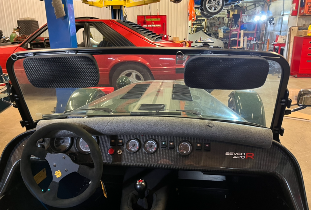

CBuff Posted August 31, 2024 Posted August 31, 2024 New York needed photos of bumpers , padded dash and sun visors. Don’t get me started with the light sae numbers. You can pm me when you get to that stage for tips (if Ohio is anything like ny) 1
CBuff Posted August 31, 2024 Posted August 31, 2024 The kebab skewers holding the sunshades complete the look. 1

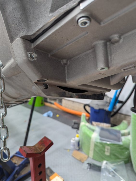

hyper7 Posted August 31, 2024 Author Posted August 31, 2024 (edited) Another super stupid question....why is there a gap at the bottom of the bellhousing/motor? I'm guessing I have the wrong bellhousing? Edited August 31, 2024 by hyper7
JohnCh Posted August 31, 2024 Posted August 31, 2024 Nope, you should have a black part called the dry sump guard that fills that gap. It's one of that parts that can be a little fiddly to fit or you luck out and the bolts align perfectly. Caterham uses the same bellhousing for wet sump and dry sump cars, but because the dry sump pan is so much shallower, you end of with the step and resulting gap. 1
CBuff Posted August 31, 2024 Posted August 31, 2024 Sorry since I wimped out and had Greg have someone put my engine in I’m not much help. But this is my 420r. Seems like the black piece which I thought was just a guard might be a more integral piece.
hyper7 Posted August 31, 2024 Author Posted August 31, 2024 Amazing, thanks guys. I really didn't want to take stuff back apart.
