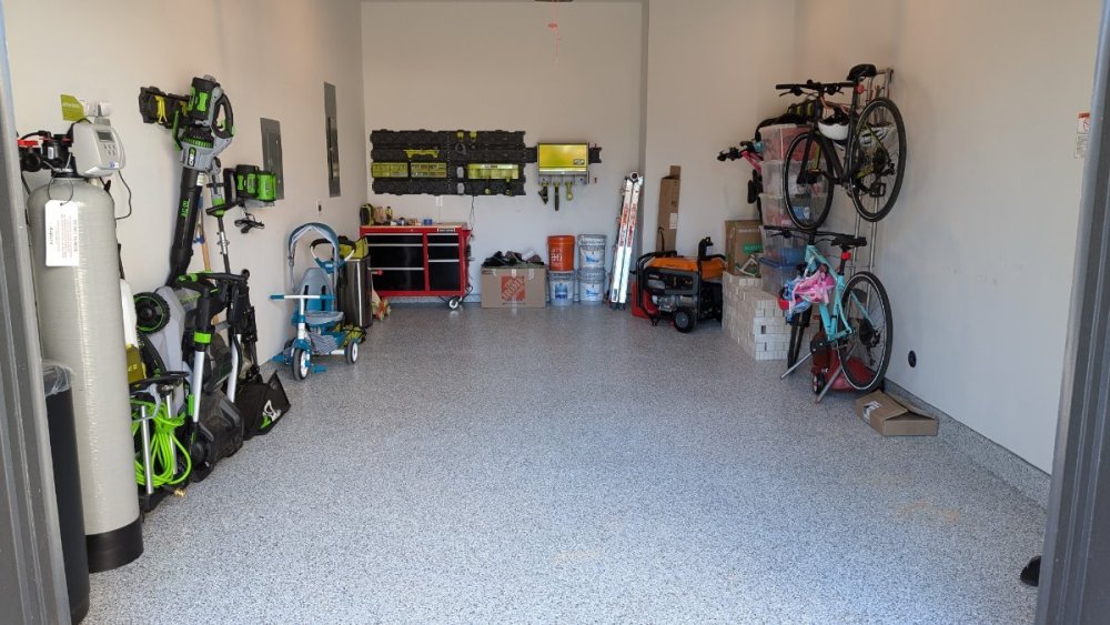

hahuang65 Posted August 27, 2024 Posted August 27, 2024 So with my order awaiting just a few final parts at the factory, I decided to prep my garage. Rich from Kampena told me it'll be a 3-5 week journey once it ships so I still have some time. I recently saw someone mention their order from Kampena got mixed up, made me a little worried about mine. Rich sent me a couple of pics during build though so hopefully mine will be fine. Looking forward to building the kit! 1
hahuang65 Posted August 28, 2024 Author Posted August 28, 2024 @IamScotticus yes the are. They're the Ryobi Link system. They're nice, but they're not as flexible as just doing straight pegboard. I see you're in Houston. Whereabouts are you? I'm over in Spring off the 99.

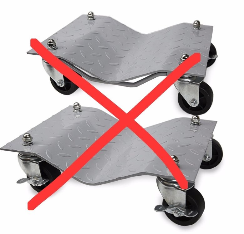

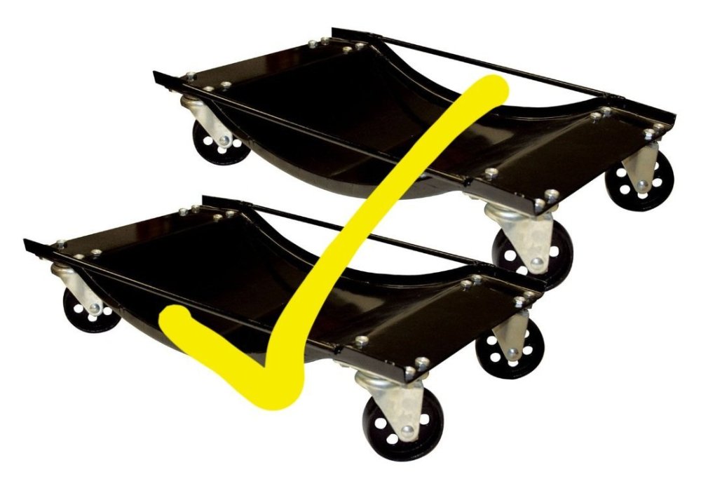

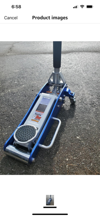

IamScotticus Posted September 4, 2024 Posted September 4, 2024 (edited) Floor jack, yes. This isn't a car you will want to take to the local service station. You need to do some things yourself, and a floor jack is among the most handy things. Probably the rear A frame bush, tyre rotations and oil changes will be the more common uses. And checking out the damage after going over a curb, lol. I actually did it. Being that low to the ground, it's not always obvious how deep a step or drop is until you go over it. Welcome to sevening! Those Allstar dollies do rotate to be perpendicular and flat. But, yes, it's not likely you will need them very often. They're expensive for a single time use item. The other dolly solution I like are these wheel dollies. I'm partial to one kind over the other. BOTH can slip out from under the wheel, but the diamond plate V type is far less stable. Once on the ground on its wheels, on these dollies, the 7 moves around easily. Edited September 4, 2024 by IamScotticus
hahuang65 Posted September 4, 2024 Author Posted September 4, 2024 58 minutes ago, IamScotticus said: This isn't a car you will want to take to the local service station. I'm definitely planning on getting something. Just trying to figure out if I need it NOW. If I don't I'll put it off, and want to get the QuickJack at some point...but if I do need it to start the build, then I'll probably have to pick something else up for now.

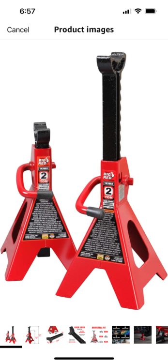

CBuff Posted September 4, 2024 Posted September 4, 2024 https://a.co/d/6Lt1B91 j got this and it works well. Relatively light and fits under the car. BIG RED T42202 Torin Steel Jack... https://www.amazon.com/dp/B0028JQYPG?ref=ppx_pop_mob_ap_share and two of these. Not bad. One Jack isn’t quite square when on the floor. But still works

CBuff Posted September 4, 2024 Posted September 4, 2024 Sorry I should have clarified. I didn’t have space to build my car. So this was purchased for routine maintenance.
