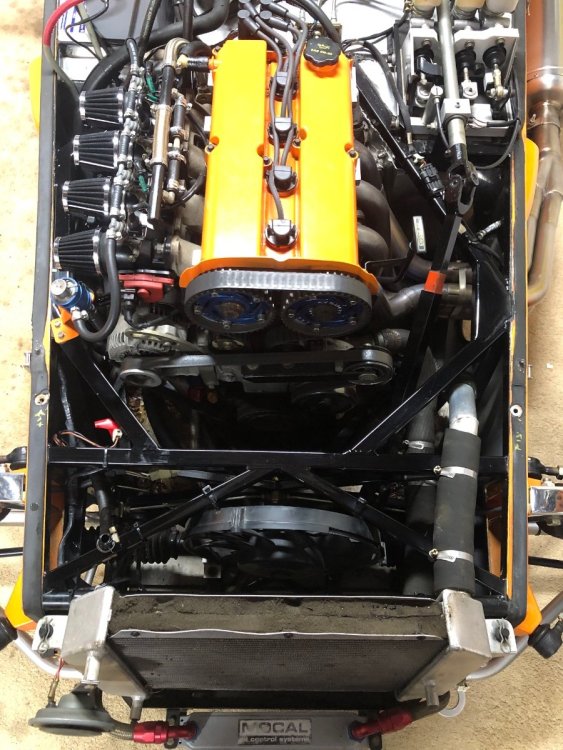

add-liteness Posted November 2, 2024 Posted November 2, 2024 I have a 2 liter Duratec motor with a single ignition coil mounted immediately behind the head. To order plug wires I need a particular car make and year to get the correct length of the wires. Thanks

JohnCh Posted November 2, 2024 Posted November 2, 2024 @MV8 are you sure the plug lengths and boot seals are the same between the engines? I ordered mine for an early 2000's UK market Ford Mondeo which used the coil pack and had it mounted on top of the coolant junction at the back of the head as in your picture. The Ford Ranger also used the coil pack, but I seem to recall it was mounted slightly differently and lead length was not the same -- someone may be able to confirm or correct that statement. I believe all other US Duratec installations had coil-on-plug. Magnecor has a UK site with a catalog for European cars. I'd start there, then share that info with the US arm when ordering.

MV8 Posted November 2, 2024 Posted November 2, 2024 (edited) 1 hour ago, JohnCh said: @MV8 are you sure the plug lengths and boot seals are the same between the engines? I ordered mine for an early 2000's UK market Ford Mondeo which used the coil pack and had it mounted on top of the coolant junction at the back of the head as in your picture. The Ford Ranger also used the coil pack, but I seem to recall it was mounted slightly differently and lead length was not the same -- someone may be able to confirm or correct that statement. I believe all other US Duratec installations had coil-on-plug. Magnecor has a UK site with a catalog for European cars. I'd start there, then share that info with the US arm when ordering. Those that I mentioned (all fwd Zetecs) have the coil packs in the same area. It occurs to me this may be a hodgepodge of parts, but a set of returnable cheap wires from the local parts store might be a good way to confirm fit. Edited November 2, 2024 by MV8
add-liteness Posted November 2, 2024 Author Posted November 2, 2024 My question isn't what motor I have or whether it should have coil over plugs. I know it's a 2.0 Duratec and that my ECU doesn't support coil over plugs. All I need is which car model and year has the compatible length ignition wires.

JohnCh Posted November 3, 2024 Posted November 3, 2024 18 hours ago, add-liteness said: My question isn't what motor I have or whether it should have coil over plugs. I know it's a 2.0 Duratec and that my ECU doesn't support coil over plugs. All I need is which car model and year has the compatible length ignition wires. In that case you may want to reread my post. If you look at page 3 of the Magnecor UK catalog, it shows you are using the gen 1 coil pack that requires different boots than gen 2, which was the standard fitment on the coil pack equipped early 2000's European Mondeo I referenced earlier. Also, the plug boots in the Duratec are different, with narrower sealing fins than used in the Zetec. It appears you will need a custom set from someone like Magencor to ensure proper fit.

JohnCh Posted November 3, 2024 Posted November 3, 2024 I just blew up your photo. That may be an aftermarket gen 2 coil pack. It has the epoxy top finish of the type 1 but the rest does look like type 2.
