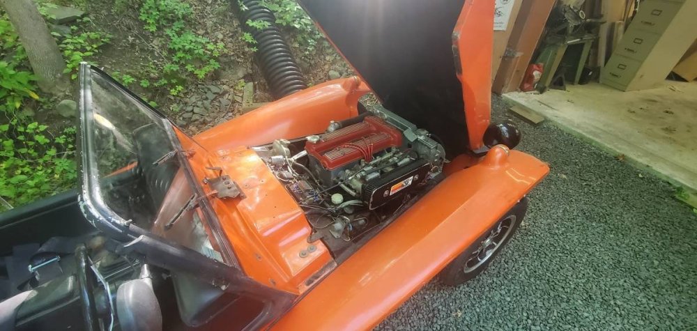

Carz01 Posted January 12 Posted January 12 I’m on the hunt for an air filter for my S4. It’s a BV TC running Dellorto DHLA carbs. I’ve been unsuccessful finding a replacement, and thought it was a K&N based on the sticker, but no joy there. The assembly covers both carbs showing measurements, and installed on the car. I don’t want to cut into the Bonnet. Any thoughts are appreciated. Thanks in advance.
JohnCh Posted January 12 Posted January 12 I've never seen the pleated style that covers both carbs, so can't help with a direct replacement. However, if no one recognizes it and you are open to similar filters that use one per carb, both the Dellorto Shop and Redline have some options that should work: https://www.dellortoshop.com/contents/en-us/d107_Airfilters_Shop.htm http://www.redlineweber.com/html/application_guide/air_filter_applications_by_carbu.htm Another, albeit more modern looking option, is the ITG JC40/25. It's the same height as your current filter, about 1/2" longer and 1" wider. They also do a sausage version in that size (JC40S/25) and sell blank baseplates that you can drill to fit: https://www.itgairfilters.com/products/jc40-small-twin-carburettor-filter-black-framed

mrmustang Posted January 13 Posted January 13 Looking at the pleating, it certainly appears to be a K&N filter, have you thought to send pictures of the filter (pull it out of the car, lay it out flat and take shots showing the dimensions and the general overall filter itself) to K&N's tech support division? tech@knfilters.com Bill

MV8 Posted January 13 Posted January 13 K&N offered a huge variety of filters at the beginning but have narrowed it down greatly. You could fit a round filter that is about 13-14 inches x 2 inches and bend it to fit the assembly. I don't know why you need to replace what you have. The filter can be straighten and sealed if there are any damaged areas. It is just window screen and cotton gauze. Short of adapting a round filter, you might as well add individual assemblies that are common and come in different heights.

wdb Posted January 14 Posted January 14 You've probably heard this before but you are likely giving up some performance with an air cleaner that shallow. There can't be much in the way of velocity stacks under there, and what stacks there are will be very close to the outer cover. I'd be tempted to find a domed unit that would allow air in over a larger surface area, particularly directly in front of the carb throats.
Carz01 Posted January 14 Author Posted January 14 @wdb, that’s an interesting thought. The S4 manual show a box type unit, but with an air inlet in the front of the unit, which is different than the pancake style installed. I need to see how much space exists between the filter and Bonnet to see what I can fit. Thanks for your insight.
