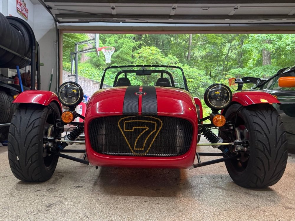

Xhilr8n Posted June 2, 2025 Posted June 2, 2025 Just got the car, not even driven after dark yet, but I’m looking to change out the headlights. A prime motivation is to add daytime running lights. Looks like the factory and plenty aftermarket options have the horizontal drl, but seems like one ones with circular running lights might be more visible a d suit the car better as well. What experience has anyone had in recent years with a new build? And ok I flipped my pic before posting but it still put it in upside down. Impressive.
Vovchandr Posted June 2, 2025 Posted June 2, 2025 A few points. The flipped iPhone image problem is known but wordy to explain. Easiest fix is take your pictures in the default landscape mode and you'll be fine. OEM is obviously best but price. I've been using a knockoff with horizontal DRL and it's been fine for me as many others. Buy any headlight on Amazon with hundreds of reviews and a good rating and it should be a pretty safe bet. Mine isn't a new build at all however. I would also recommend you look into upgrading taillights especially if you don't plan to add a third light. Our cars have a small profile and it's low. With distracted drivers it can be easily missed especially since we can brake very quickly. Justaddlightness if you want to retain old look or OEM Caterham for new style

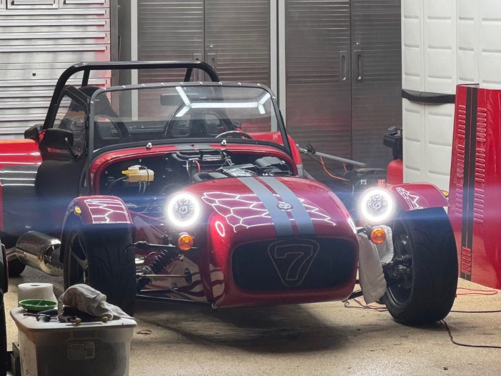

Xhilr8n Posted June 8, 2025 Author Posted June 8, 2025 On a bit of a lark I ordered an Amazon option. Made sure returns accepted. Amazon.com I’m not saying this is the way to go, just that it’s something I’ve tried that seems to have worked. These things fit great, hardest part was figuring out how to redo the four springs on each light that hold the bulb to the bezel. First light took an hour and a half. Second took 20 minutes. Almost plug and play. Had to crimp the connection for DRL with the halos, some shrink wrap for good measure. Not driven them yet, did cast them on the garage door to rough in the aim. 1 1
Xhilr8n Posted June 10, 2025 Author Posted June 10, 2025 Took her out last night enough to know what these lights can do, at normal driving around about 50 mph. I had compared to stock when just one was in. There is no comparison. Stock Halogen a tiny fraction of the output from the LEDs. DRL halos easily engaged at first click as it should be. At first I thought I had them aimed low, but the low beam in right about where you’d look for your apex. The low beam stays on when the brights are selected. No one flashed light at me like I was too bright on low beams and the impressive DRLs The dotted pattern of the LEDs in the halos oddly complements the 7 painted on the grill. A good look. Sorta War of the Worldly but modern. And like $75 to your door overnight, never harmed any original wiring. 2
