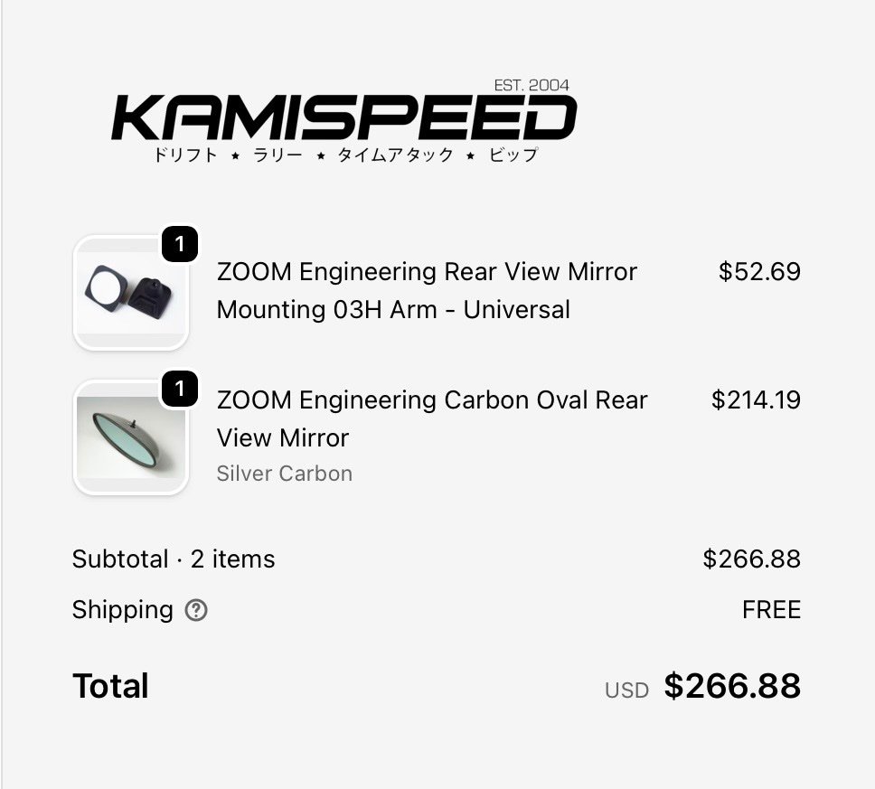

Bit the bullit.  Thinking the silver will complement the silvery theme underway with the new stripes this week and the silvery harness.  We’ll see.

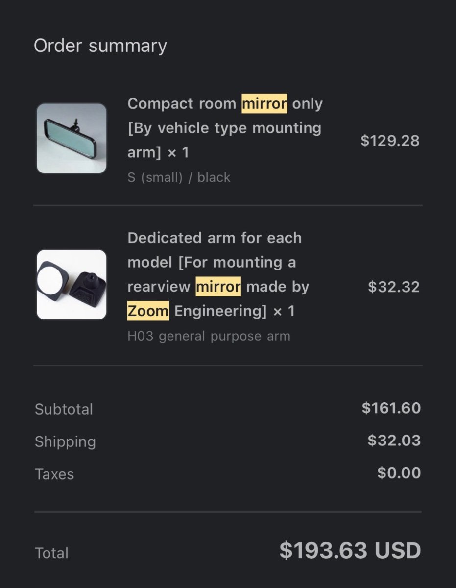

Just re read the thread assume it’s the h03 general arm and the small mirror.
yep, the same setup @Outbound mentioned earlier. Zoom ships via Japan Post who handles the tariff payment and bills through Zoom, which simplified everything. The mirror was $115.23, the mount another $28.81, shipping to Seattle was $28.55, and tariffs were $20.03 for a grand total of $192.62.
