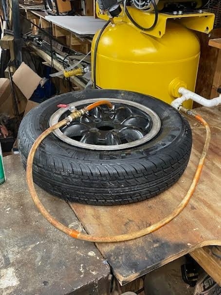

Timothy Keith-Lucas Posted August 19, 2025 Author Posted August 19, 2025 Perhaps the final word.... The air gun on the end of my air system didn't supply enough air fast enough to seat the bead on my wheels, despite having 60 gallons of 175 psi available, due to friction loss. A very simple rig of scrap 3/8" air hose, a ball valve, and some fittings solved that problem. 1
