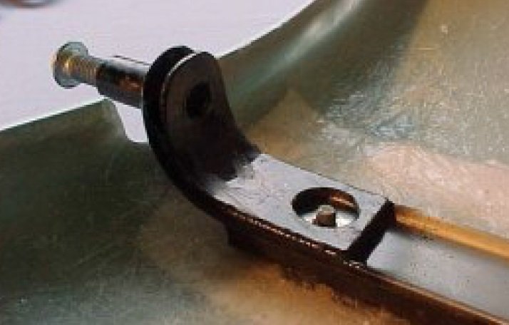

MV8 Posted October 11 Posted October 11 The bend is a critical area. Just a small gusset flange (3/8-1/2"x0.100-.125" strips) across the bends (forming a C channel) makes a big difference and it looks like you have plenty of clearance for it. Let me know if you'd like a picture.

MV8 Posted October 11 Posted October 11 This is what a Birkin mount looks like. The difference in rigidity to what you've made is huge. The tube extends to the boxing plate. Flanged as described above and boxed with an access hole for the fastener.
JB455 Posted October 11 Author Posted October 11 26 minutes ago, MV8 said: This is what a Birkin mount looks like. The difference in rigidity to what you've made is huge. The tube extends to the boxing plate. Flanged as described above and boxed with an access hole for the fastener. That must be an updated design since mine were built, it looks much stronger. The remains of one of the originals is the top piece in my picture. Just flat stock welded onto the threaded stud. All broke right next to the stud.
JB455 Posted October 11 Author Posted October 11 Here's a clearer picture of what my originals look like. If I can source the updated Birkin parts I will give them a shot.

panamericano Posted October 11 Posted October 11 Get hold of Tom, the Birkin dealer in Colo. The flat ones will always break. I got a newer design from him that have outer bent ridges, much stronger. I suspect Scott is on the right trail about too much air leading to too much shock from the road, but the flat bar type is no good. 1

JB455 Posted Tuesday at 01:15 AM Author Posted Tuesday at 01:15 AM I had a nice day of driving around northern CT with the LLG yesterday. It was a little cool (45 degrees) when I headed out in the morning, but it warmed up nicely, up to around 70. We stopped at the Saville Dam in Barkhamsted- it's a quite scenic location and the lot was full of people out enjoying a gorgeous fall day. Most of them came over to admire the cars, with the Seven being especially popular! The best part of the day? I put almost 200 miles on it without my newly fabricated fender mounts breaking! I made new ones out of 3/16" steel in place of the lighter gauge of the originals (and my first replacements) and they are sooo much more solid. 3 1
pethier Posted Tuesday at 03:59 PM Posted Tuesday at 03:59 PM I just bought a Birkin. It has long/sweep/clamshell fenders on it, but the seller did give me the cycle fenders he had. He claimed that they were with the car when he bought it, but that he never got the brackets to mount the cycle fenders to the uprights. These cycle fenders appear to have the same BRG paint as the car. Since the current setup requires the air cleaners to be removed to take off the hood, I think I might want to try cycle fenders on this car. What this all has to do with this thread: I have taken pictures of the style mounts that are on these cycle fenders. They appear better than the ones which were breaking for the author of this thread. I wonder what you all think of them compared to the upgraded ones shown elsewhere in this thead.
JB455 Posted Tuesday at 04:20 PM Author Posted Tuesday at 04:20 PM Those are definitely an upgrade from what came on my car! They look substantially stronger with the channel and extra angle brace, compared to mine which were basically made out of flat stock. If you were interested in selling the clamshells and associated brackets I could be interested in buying. I kind of prefer them for a vintage look. The carbon fiber cycle fenders on mine now look sporty, but definitely take away from a vintage feel.
pethier Posted Tuesday at 04:34 PM Posted Tuesday at 04:34 PM 12 minutes ago, JB455 said: Those are definitely an upgrade from what came on my car! They look substantially stronger with the channel and extra angle brace, compared to mine which were basically made out of flat stock. If you were interested in selling the clamshells and associated brackets I could be interested in buying. I kind of prefer them for a vintage look. The carbon fiber cycle fenders on mine now look sporty, but definitely take away from a vintage feel. Let's take this to private mail.
