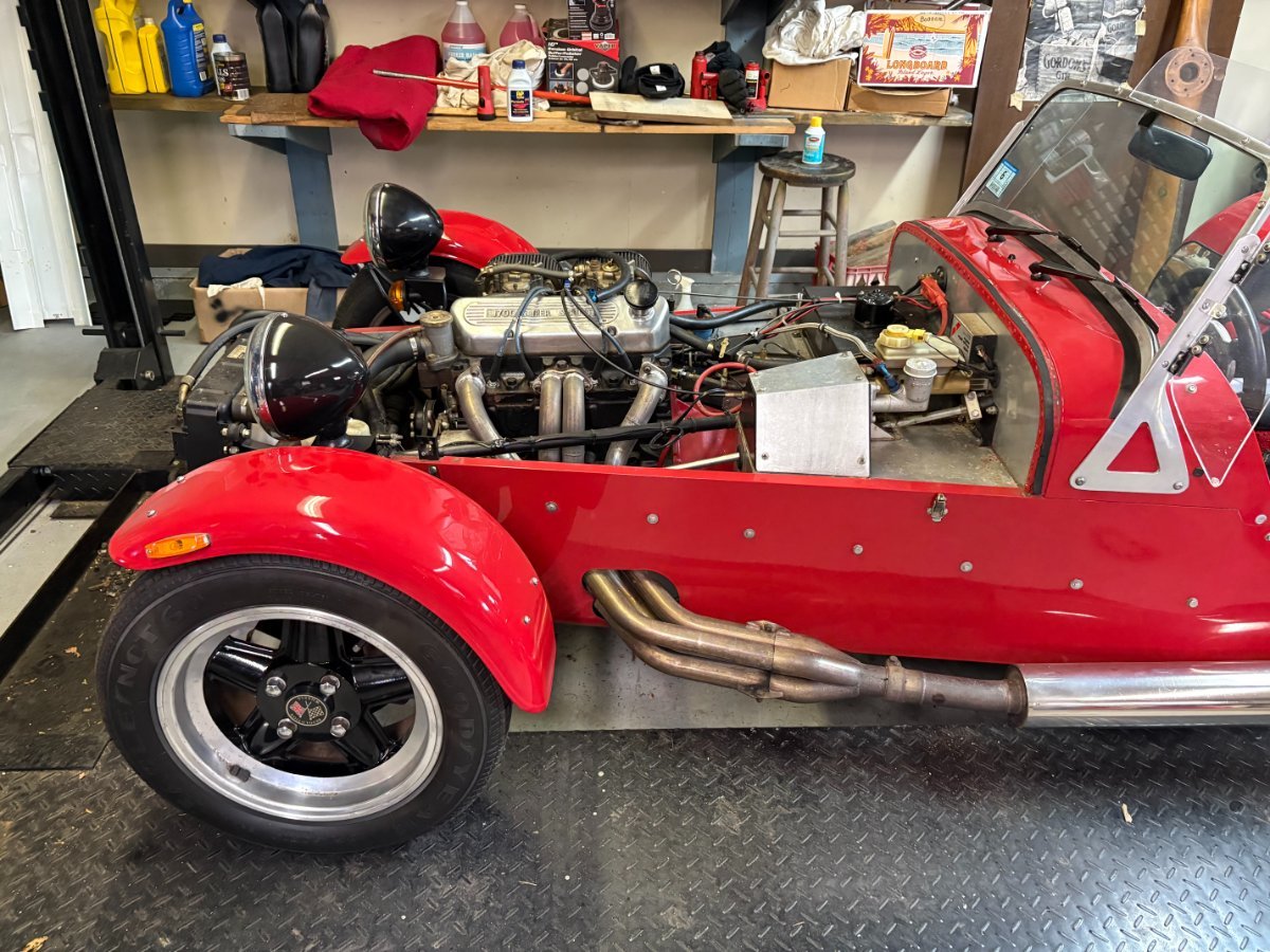

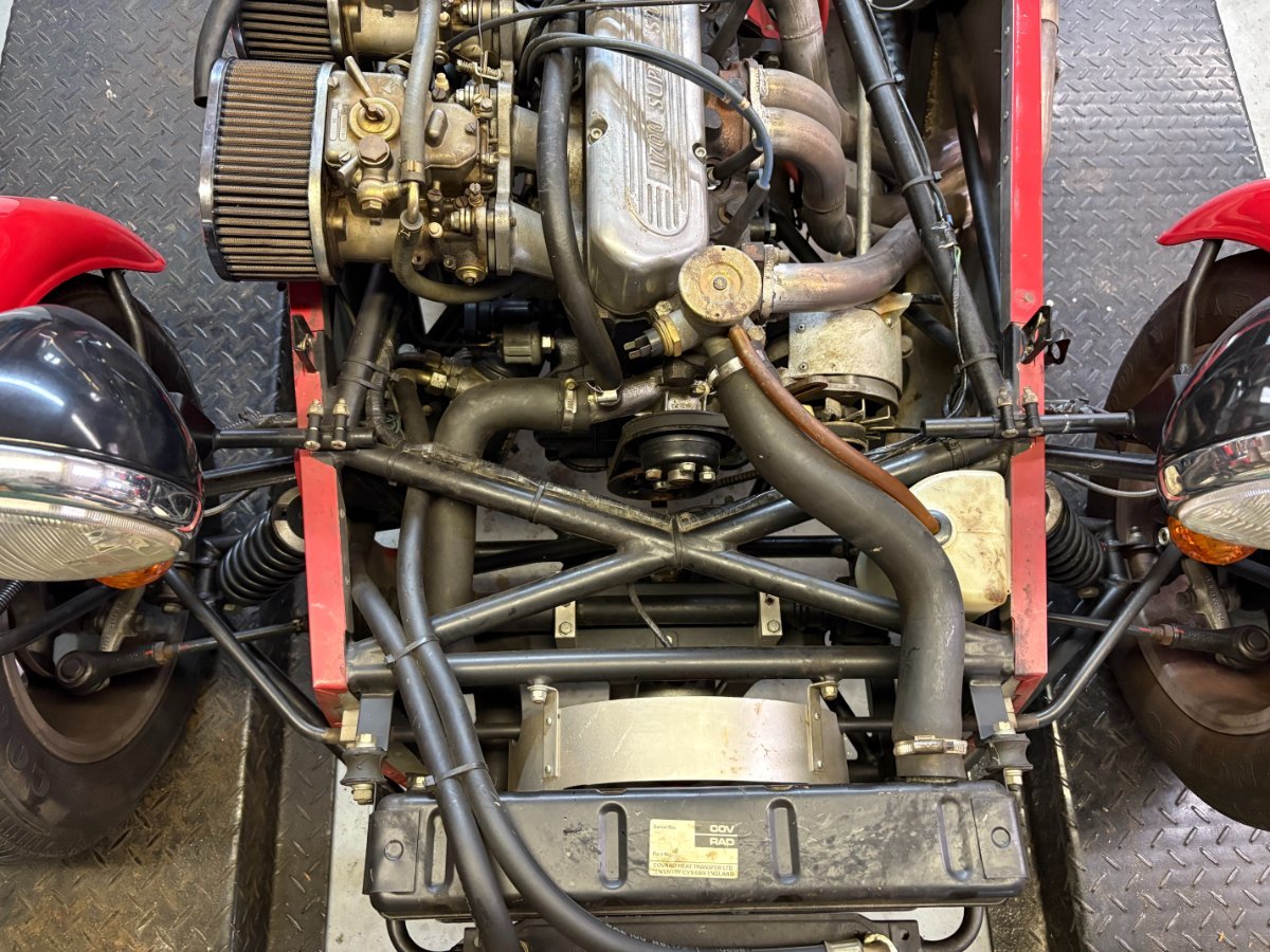

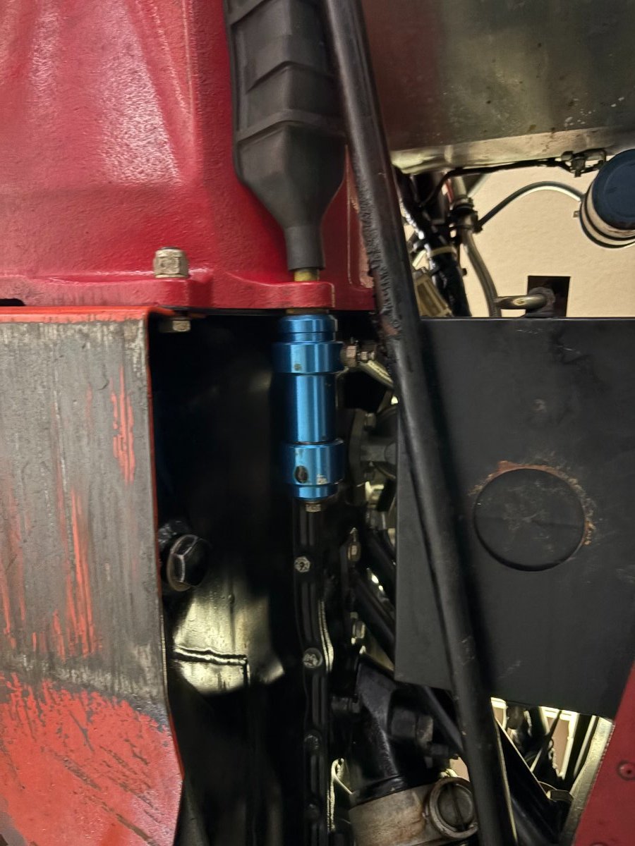

Origin7 Posted November 17, 2025 Posted November 17, 2025 (edited) After loving Caterhams since I was a kid, I recently purchased a '89 1700 Super Sprint with 15K. It's a single-owner car that's been undriven for 4 years and needs some sorting out. I have 1 month to use the previous owner's lift and get things in order before I relocate her. All the fuel had evaporated, and the system was dry. I got some fuel into the car and primed the fuel pump. The car ran great. There are a couple of things that I see that need to be addressed: 1. The clutch slave cylinder is leaking badly. 2. The upper and lower radiator hoses are cracked and leaking. Are there any other things that I should do right away or check while I still have use of the lift? Edited November 17, 2025 by Origin7
MV8 Posted November 17, 2025 Posted November 17, 2025 How far are we going? Make sure the cooling fan can be switched on. I see the fan switch is not connected. Make sure the alternator is charging the battery and the temp is being displayed on the temp gauge. Replace any hard, stiff fuel or coolant hoses. Disconnect the fuel line at the carbs to let the electric pump fill a clean pail to see how clean the fuel is. Change the fuel filter and vee belt. DO not move the oil lines around unless you want to go ahead and replace them. Hot oil pushes the durability limits of rubber hose. There should be a seal kit available for the slave. Might check the diff and trans oil levels to top off. Date codes on the tires to see how old and if your test drive created some cracks. Looks well cared for but sitting is always bad.....

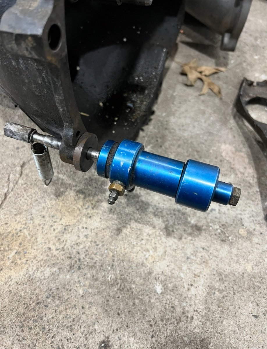

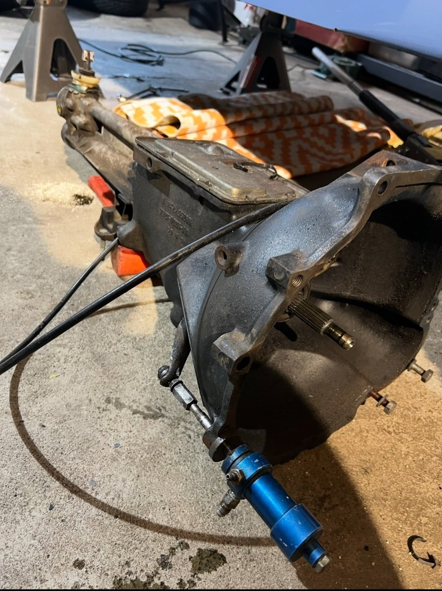

Origin7 Posted November 17, 2025 Author Posted November 17, 2025 It's only an hour to get the car home, but I'd like to take advantage of the heated shop and lift to get things done. Great suggestions! Thank you! Good catch on the fan. The previous owner wired the fan to a switch on the dashboard to control it manually. I assume because it ran on the cooler side, but I am not sure. Any idea how I could ID the slave cylinder and find a rebuilt kit?
MV8 Posted November 17, 2025 Posted November 17, 2025 I just realized what this is. The car originally had a cable clutch but someone adapted it to hydraulic using a universal slave. I don't know about the source for the one you have, but a new slave is about $50 from speedway motors. The problem is the speedway part may have a different bore size, different line fitting, may be longer or shorter, etc so some adapting may be required. An alternative is to return to the leak-free standard cable clutch but it may require pedal modification or other small parts to make it work and you don't want to be waiting on the domestic mail in somebody else's garage. I suggest stopping several times on your way home to top off the clutch master. It may not be as bad a leak as you think. The dust boot and the mounting stud is removed to fit a bolt and bracket. https://www.speedwaymotors.com/Speedway-Pull-Type-Clutch-Release-Slave-Cylinder,7169.html?utm_medium=CSEGoogle&utm_source=CSE&utm_campaign=CSEGOOGLE&gad_source=5&gad_campaignid=23022589191&gclid=EAIaIQobChMI8Nex2qf6kAMVqjUIBR1fRBXuEAQYAiABEgIxC_D_BwE

Origin7 Posted November 18, 2025 Author Posted November 18, 2025 1 hour ago, MV8 said: I just realized what this is. The car originally had a cable clutch but someone adapted it to hydraulic using a universal slave. I don't know about the source for the one you have, but a new slave is about $50 from speedway motors. The problem is the speedway part may have a different bore size, different line fitting, may be longer or shorter, etc so some adapting may be required. An alternative is to return to the leak-free standard cable clutch but it may require pedal modification or other small parts to make it work and you don't want to be waiting on the domestic mail in somebody else's garage. I suggest stopping several times on your way home to top off the clutch master. It may not be as bad a leak as you think. The dust boot and the mounting stud is removed to fit a bolt and bracket. https://www.speedwaymotors.com/Speedway-Pull-Type-Clutch-Release-Slave-Cylinder,7169.html?utm_medium=CSEGoogle&utm_source=CSE&utm_campaign=CSEGOOGLE&gad_source=5&gad_campaignid=23022589191&gclid=EAIaIQobChMI8Nex2qf6kAMVqjUIBR1fRBXuEAQYAiABEgIxC_D_BwE I thought something looked out of place with that slave cylinder. This makes sense, now. I appreciate the help!

11Budlite Posted November 18, 2025 Posted November 18, 2025 I believe that slave cylinder was used on that era Caterham delivered to the US in LHD form. My buddy has a '92 almost identical to yours and he has the same blue slave cylinder. When it started to leak he was able to get a replacement here in the US. I believe it was from Josh at Rocky Mountain Caterham.
IamScotticus Posted November 18, 2025 Posted November 18, 2025 (edited) WARNING: UNSOLICITED OPINION: In CT/MA, unless you're racing, I would consider eliminating the oil cooler. I doubt you get any benefit from it up there and its more stuff to break. These 7s shake everything loose. An oil cooler thermo sandwich plate may not be getting hot enough to flow. Modern oils can take the heat. The manual fan switch may be because the thermo sw was overcooling. At the least, changing those oil hoses to maintain flexibility is a good idea at this age. The more you take off a 7, the better it gets. Except keep that alternator heat shield. If you sell the 7, keep that shield, it's a gem. And the radiator maker, CovRad, is no longer in business. Looks like Long cockpit DeDion. Ford PCD? or not yet? Edited November 18, 2025 by IamScotticus 1
IamScotticus Posted November 18, 2025 Posted November 18, 2025 look: Im just throwing stuff on the wall.. https://www.proformancepros.com/item/5274480-universal-slave-cyl-pull-style-blue https://www.proformancepros.com/item/6899255-slave-cyl-for-clutch-1-38-stroke?keyword=PPP-1307 https://www.piratemfg.com/cnc-slave-cylinder-blue-dune-buggy-vw-baja-bug-cn300b https://patrickmotorsports.com/products/trawil260133

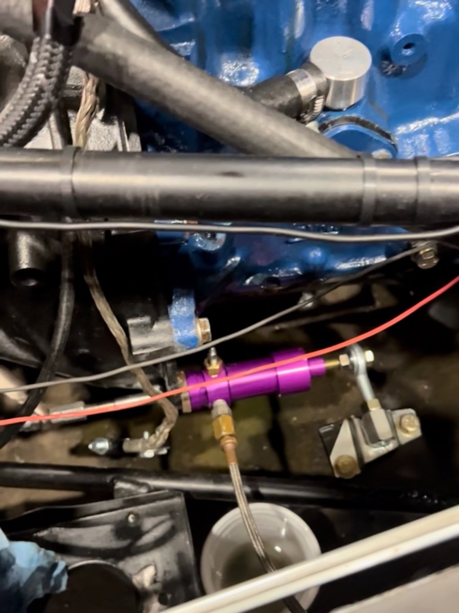

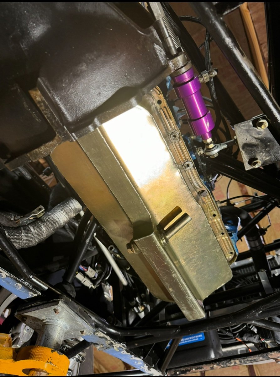

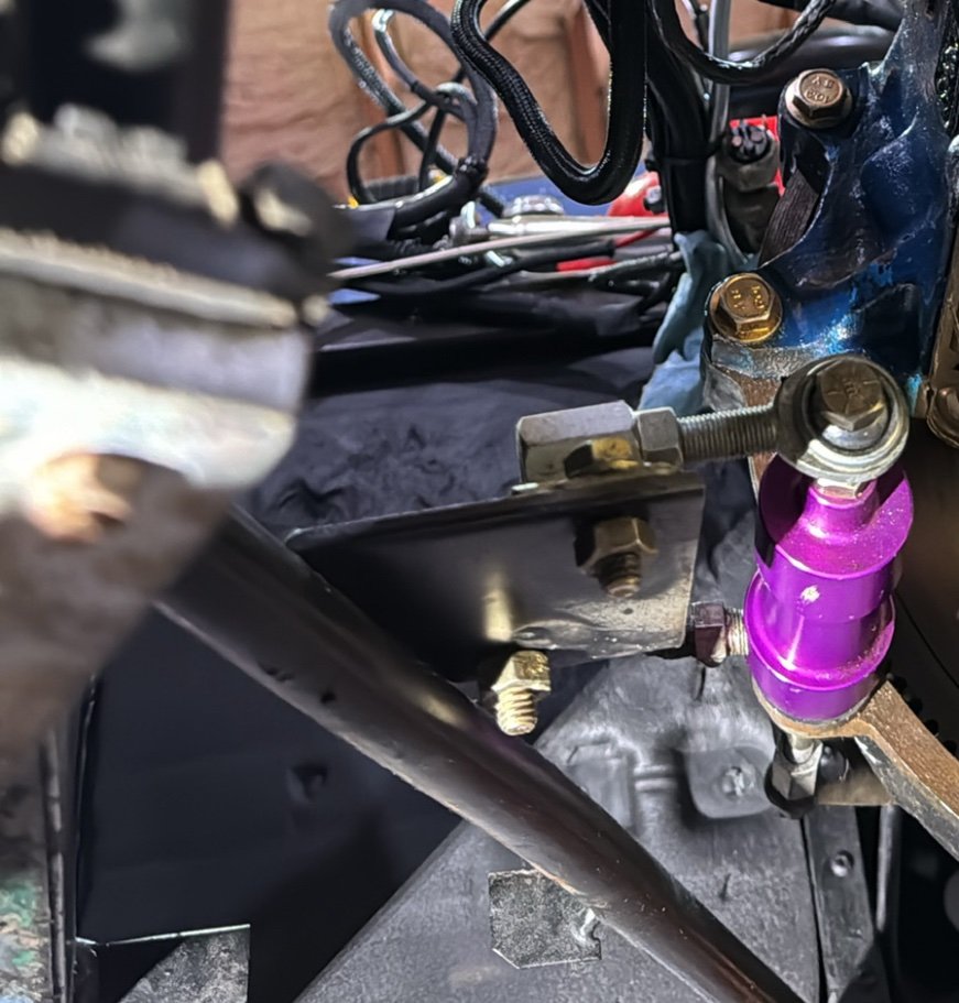

NSXguy Posted November 18, 2025 Posted November 18, 2025 (edited) I had the same blue one when I first purchased my 81 cat. Swapped it out during my baseline process as it was leaking like yours(it’s probably a very old unit). i installed the speedway unit and decided to fab a plate and purchased a bracket and threaded heim joint to support the back of it for a more robust install. The original configuration/assembly was prone to flex. (Refer to attached photos) links to bracket and heim joint: Hyperlink to clutch slave cylinder bracket Hyper link to clutch slave cylinder heim joint Edited November 18, 2025 by NSXguy

Origin7 Posted November 18, 2025 Author Posted November 18, 2025 @NSXguy That's it! I like what you did with the support/mount. I can see a lot of slop which your setup would eliminate.

MV8 Posted November 19, 2025 Posted November 19, 2025 The slave mounting support should be attached to the engine (versus the chassis) so it can move with the bell housing as the engine rocks under load. The rocking movement is much greater when driving than what can be seen blipping the throttle out of gear. The purpose of the support plate is to keep the slave body from moving away from the bell when the pedal is not being applied. For someone adapting this without replacing an existing pull slave, the slave body could be mounted a 1/2 inch further forward to get it off the bell opening (rod would just pass through so no need for a flange bushing in the bell) and a stiff support bracket made using the full length stud provided but removed for this installation/repair. 1
NSXguy Posted November 19, 2025 Posted November 19, 2025 That's a good obvservation. I definitely agree that ideally, an engine mounted bracing should be the goal. While not impossible to do on a xflow (easier on other engines), practically a bit more involved on a x-flow due to availability/proximity of existing mounting locations/threaded holes/bosses for a bracket. I suspect it is for this reason that many of the Xflow 7s cylinder installations i've observed are as they are and don't come with a rear brace; which still works OK but IMO not ideal for the optimal performance. In my case, I did consider a few engine mounted alternatives when doing the "upgrade"; but not wanting to implement an exotic solution, opted for the simpler setup pictured. As a hedge, i purchased a spare cylinder in case the rigid mounting resulted in premature/accelerated failure, but so far have not needed it as the unit has worked reliably through many years of normal city driving and several days of hard driving on track. YMMV- By no means the only viable approach; one can expect with an assembly prone to more vibration, or overly compliant mounts, results might vary. And of course, a concentric slave cylinder eliminates these concerns, but comes with its own set of trade-offs. such is the nature of the beast. I would say, as an improvement to my original install, rubber bushes can be added for and aft of the heim joint or on the mount/bracket for some damping. 1
