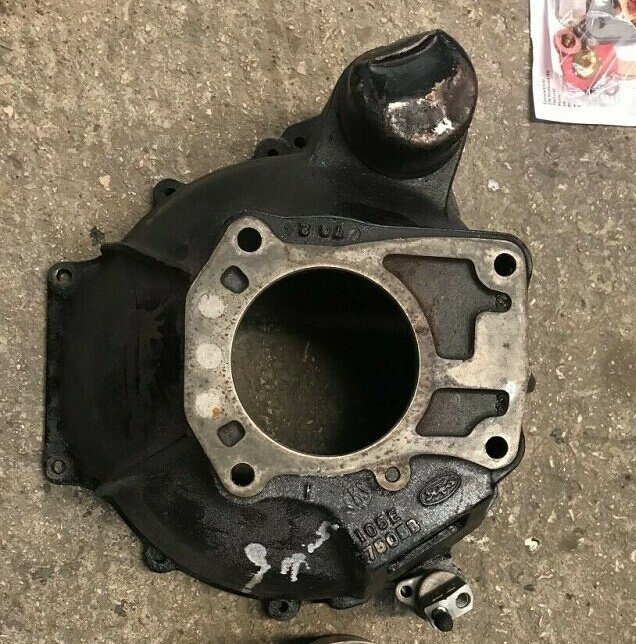

William - the 105e is the one that has capacity for the larger 8" Twin Cam clutch.  The 109e is the one typically found on early Sevens, and it has smaller internal dimensions (ribs are on the inside) and may need machining to handle a larger clutch than 7.5".
I do know that some Elan owners have installed 8.5" clutch discs, even with the original Elan pressure plate.  Whether a full 8.5" setup would fit in a 105e without modification, I do not know.
I grabbed pictures of 105e and 109e bellhousings from the web for visual reference of each.

Bottom line... 105e, 109e, and 120e will fit the gearbox and block... but of the 3, only the 105e can fit a clutch larger than 7.5".
