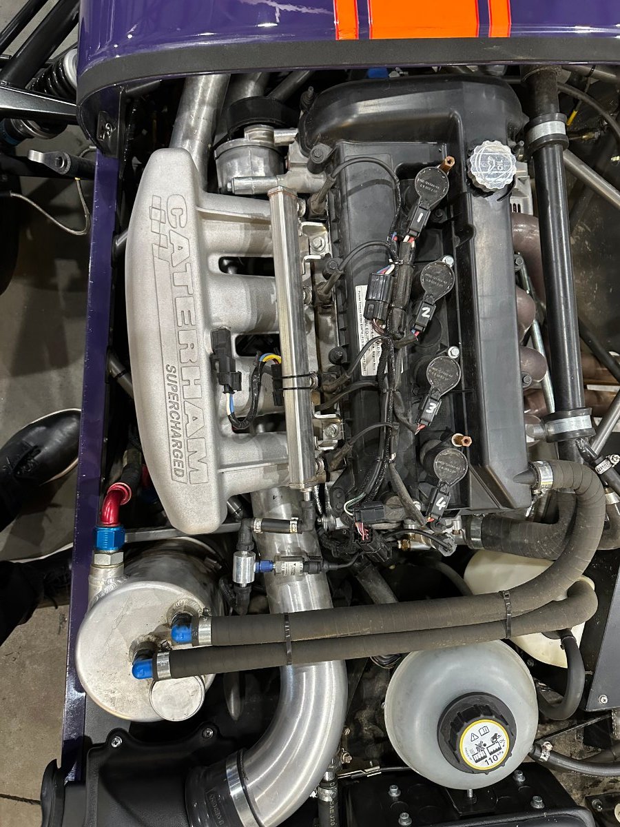

Already asked the question.  The production run is limited so not enough for Ford and Caterham.  The per unit engine cost is roughly double a 620R Duratec unit set up (incl. the roots supercharger).  Obviously this comparison is flawed as it does not cost in changeover in ancillaries and installation elements needed if you were to productionize the engine in situ in a Caterham - so cost differential would be higher in reality.
The 2L Duratec with supercharger is slightly heavier but it can reliably produce 350hp at 8000rpm in a track setting (when using the Partridge Green Motorsport modification package that unlocks the Caterham ECU and fixes the TPS and other design issues unaddressed by Caterham).  Photo of that engine package.
