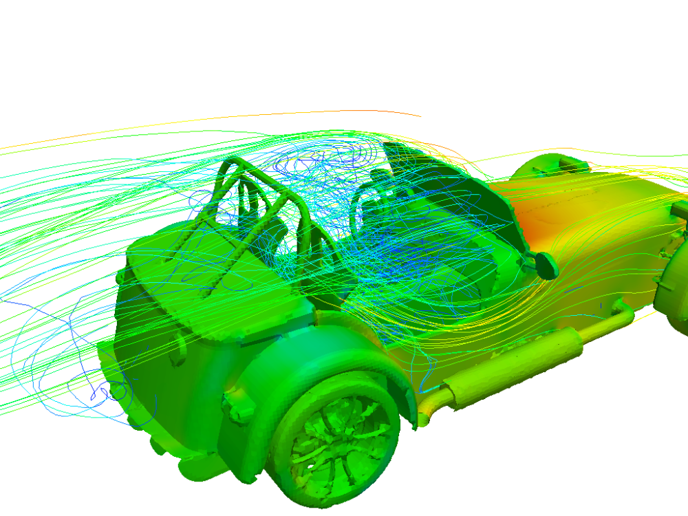

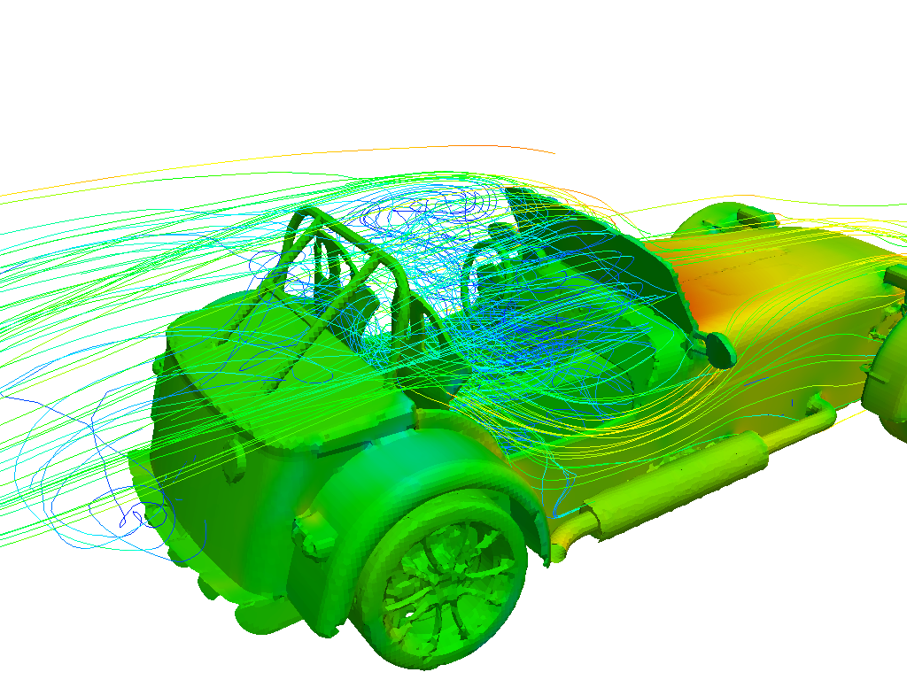

I came across this simscale model of the 7.  Not sure of the voracity of this simulation. But to John’s point it does look like a lot of the wind is coming from the side of the car and being pushed into cockpit from rear wing.  Would a half door mitigate this ?  Not sure
https://www.simscale.com/projects/jfazeli/caterham_aero/

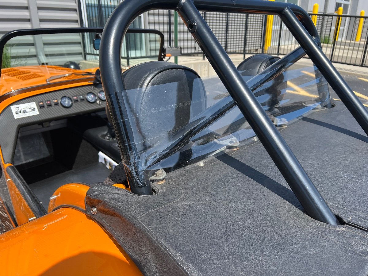

i also prototyped a half wall on the back of the roll mount. Full coverage actually makes it worse. But covering up halfway improved things a lotttt.
later this year I’ll be making a more permanent acrylic panel that looks clean. The clear tape was more quick and dirty prototyping.
