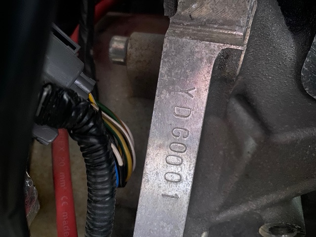

What Duratec do I have and how to find out more about it? Focus 2.0L, Ranger 2.3L, block / head?
2005 CSR 200
engine number: YDG0001 (no bar code found on front of engine (like my 29/05/08 2.0L Duratec) or rear bell housing mounting area as ref in the Ford/Mazda engine assembly chart)

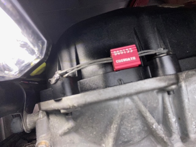

Factory (Cosworth?) applied seal on front cam cover bolts: "000133 Cosworth" who might I contact / may keep records of the build / Cosworth applied seal / number?
The block measures slightly taller than my 2008 2.0L Duratec, so 2.3L consistent w/ my understanding of 2005 CSR 200?

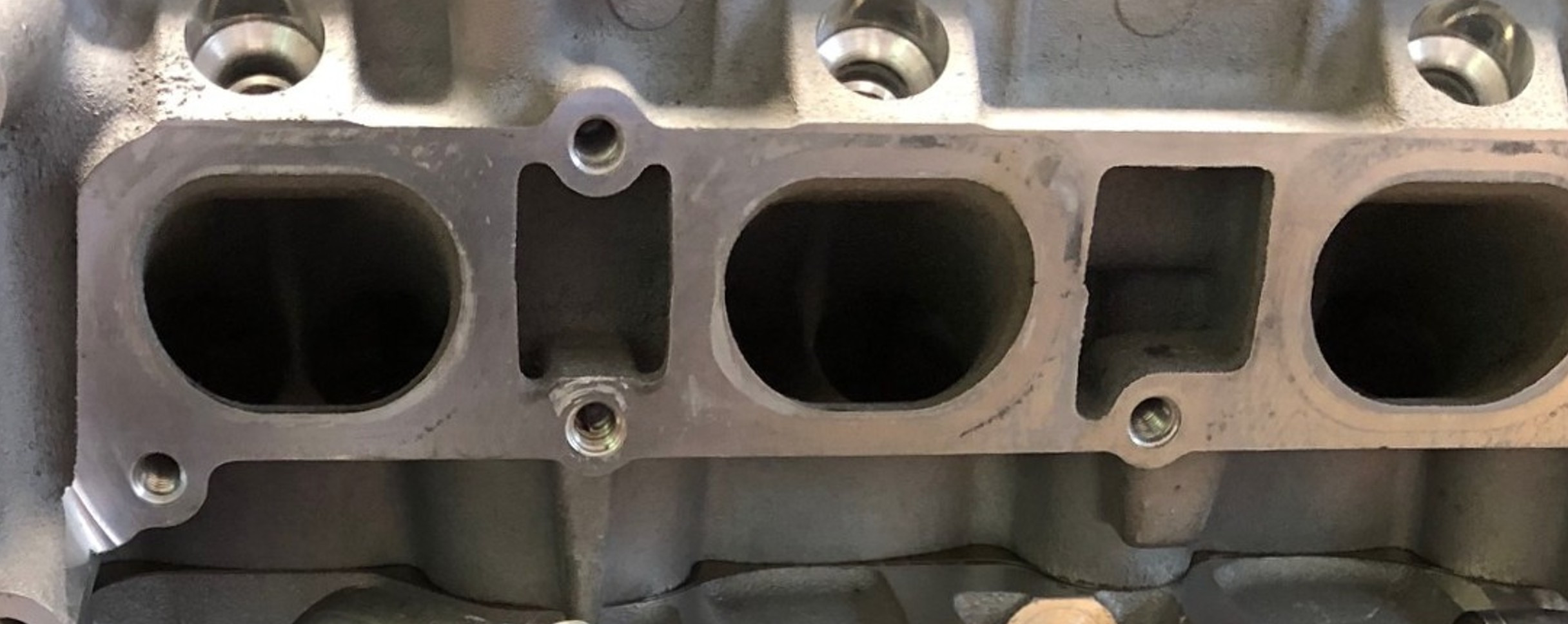

The intake ports and throats to the valves etc. are massive compared to my 2.0L Duratec but only have 5 bolts retaining the large intake plenum (no studs shouldered and non-shouldered as pictured / called for in Cosworth Duratec documentation, or seven bolts as per my 2008 Duratec)

Both the CSR 200 and 260 used the 2.3L, which has a 13mm taller block than the 2.0L. To get the extra power for the 260, Cosworth used more aggressive cams, higher compression forged pistons, forged rods, head work, and roller barrels.

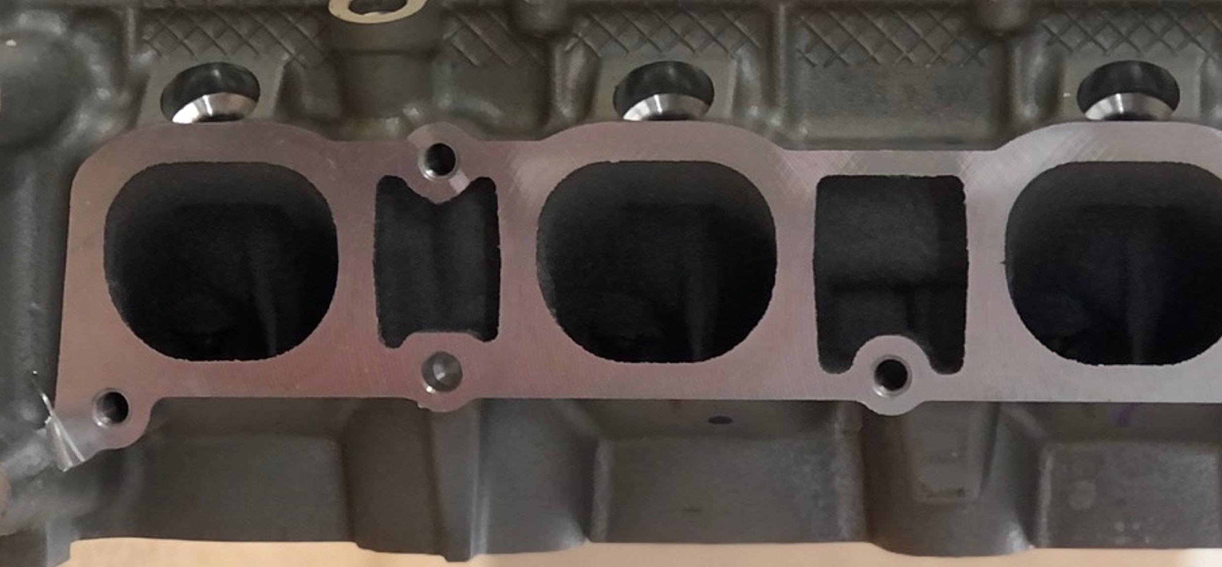

Your comment about the visibly larger ports and throats is puzzling. I've researched this area a lot over the years, and the heads in both cars should be the same. The topic of Duratec heads is a little convoluted, so I'll share what I know based on that research and having had 2.0L, 2.3L, and 2.5L heads in my shop for comparison. If anyone has information that refutes the following, please jump in.
The 2.0L and 2.3L heads are the same down to the casting numbers. Each was available in either a low port or a high port version The better flowing high port design, which refers to larger reshaped throats, was used in the 2.3L Focus, and various non-US 2.0L Fords, whereas the low port was used in the 2.3L Ranger, all US 2.0L, and some non-US 2.0L Fords. My understanding is that Caterham has always used the high port in their Duratec-powered cars. The only head that has visibly larger port openings — i.e. the opening that mates to the intake runners — is the 2.5L. They are taller, giving a more squarish shaped appearance than the more rectangular openings of the 2.0/2.3L. The first photo shows a stock 2.0L low port, and the second is the 2.5L.
