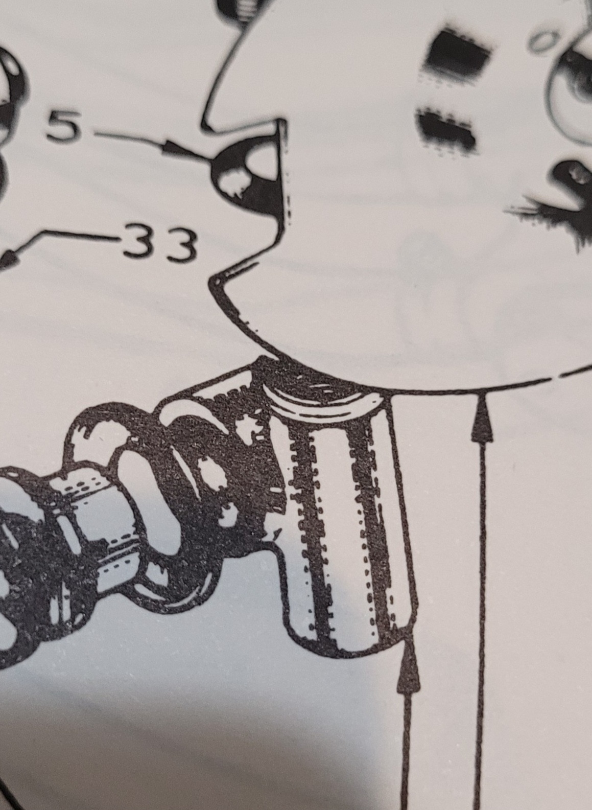

If you have the Alfred and Alder trunnions a la Spitfire, and someone used grease instead of oil in them, the grease may have hardened.
Appears so.  Gear oil EP 90.20260714_203148.thumb.jpg.cbc087e589adb23661c5174f05b3843a.jpg
