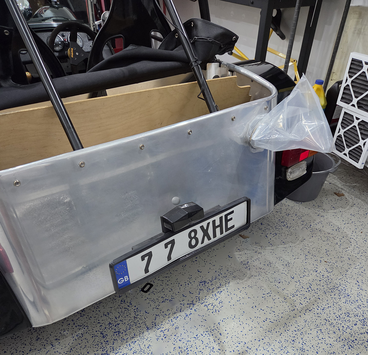

TC7 Posted Friday at 09:09 PM Posted Friday at 09:09 PM OK guys help me out this looks terrible I wanna get rid of the spare tire carrier I want to keep that euro plate because I've got away with it for many years so I keep the regular plate inside the car. Any ideas? Thank you!

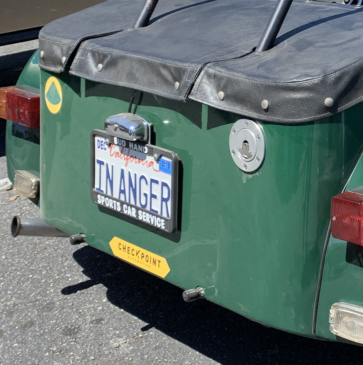

Slonie Posted Saturday at 02:21 AM Posted Saturday at 02:21 AM Example photo of when I saw an owner who chopped their carrier off. I believe they can re-attach as described by theDreamer above, although I don't know what they have under those caps. I've definitely seen photos of the removable setup as described. I stopped carrying my spare early on but keep the carrier for future luggage opportunities, and it gives me a LITTLE piece of mind that somebody will bump that before the rest of my car.

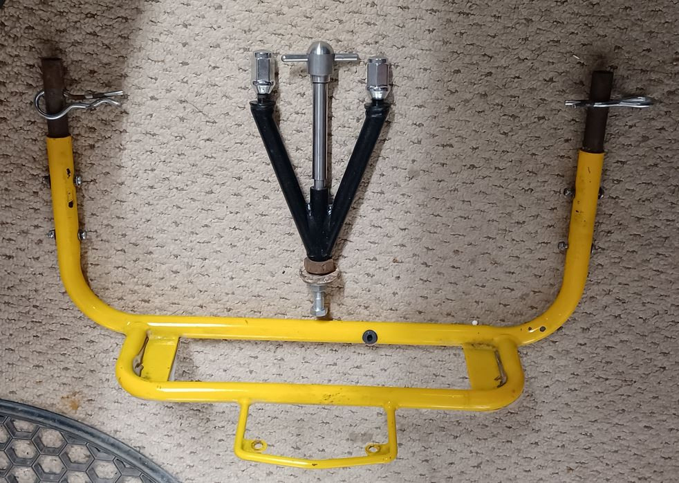

theDreamer Posted Saturday at 02:56 AM Posted Saturday at 02:56 AM This is what the removable hoop bracket looks like.
TC7 Posted Saturday at 01:32 PM Author Posted Saturday at 01:32 PM Thanks everybody! a lot of good ideas. One of the ideas I was considering it's just section the thing so it gets closer to the body I'll never carry anything in that That's what the passenger seats for LOL.

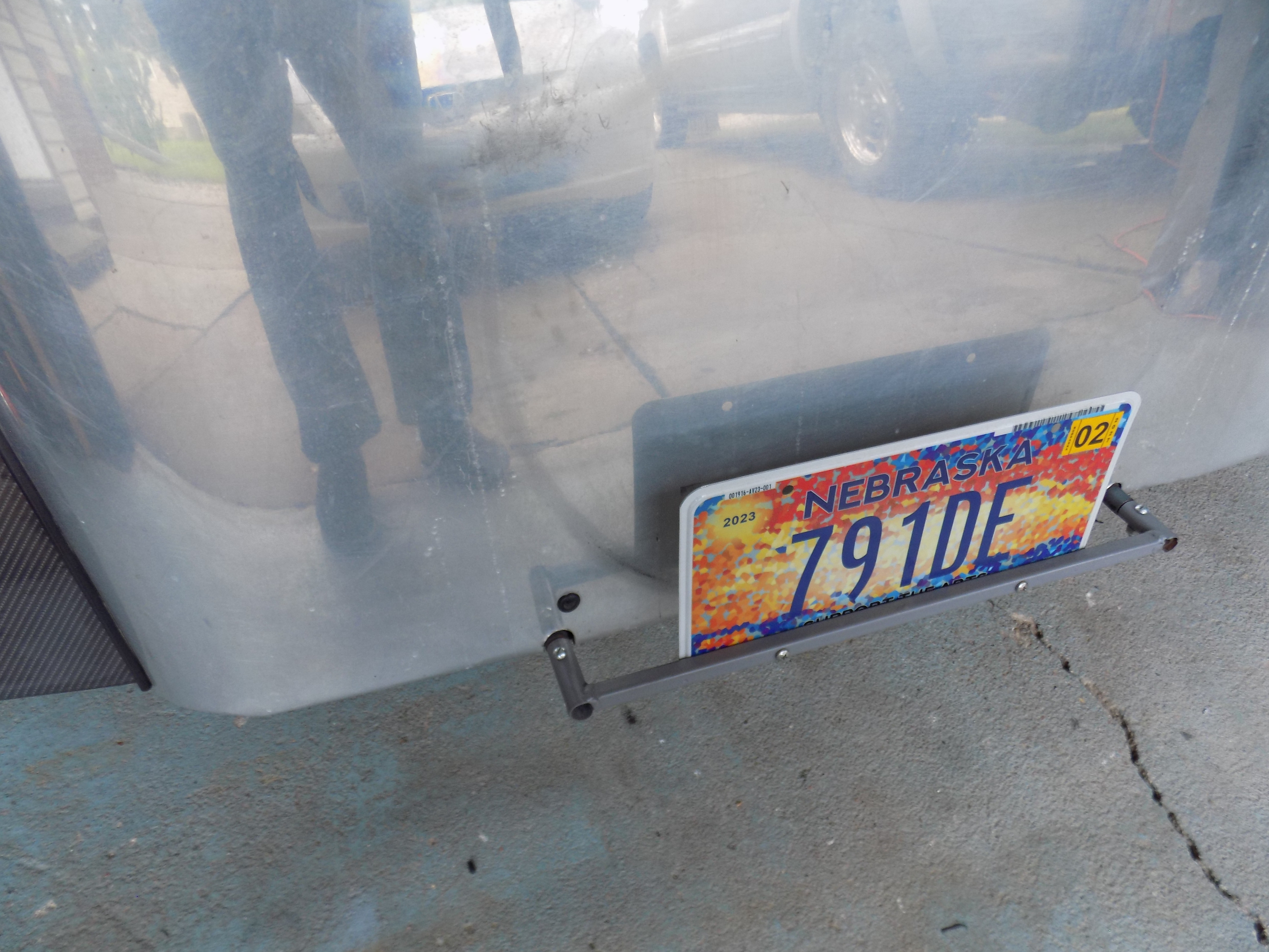

7Westfield Posted Saturday at 01:53 PM Posted Saturday at 01:53 PM (edited) The Westfield has 2 little stubs that stick out about an inch, and the rig bolts on over them. I just built a shorter one to hold the plate, and can switch back if needed Edited Saturday at 01:56 PM by 7Westfield 2
