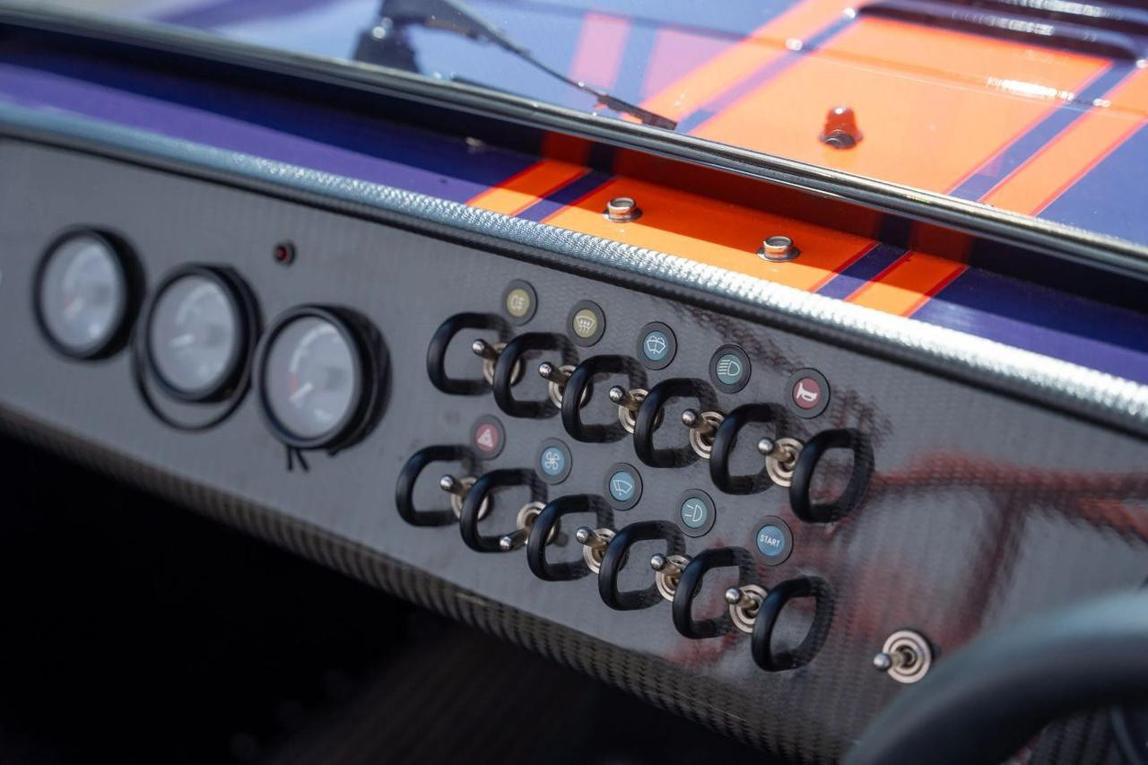

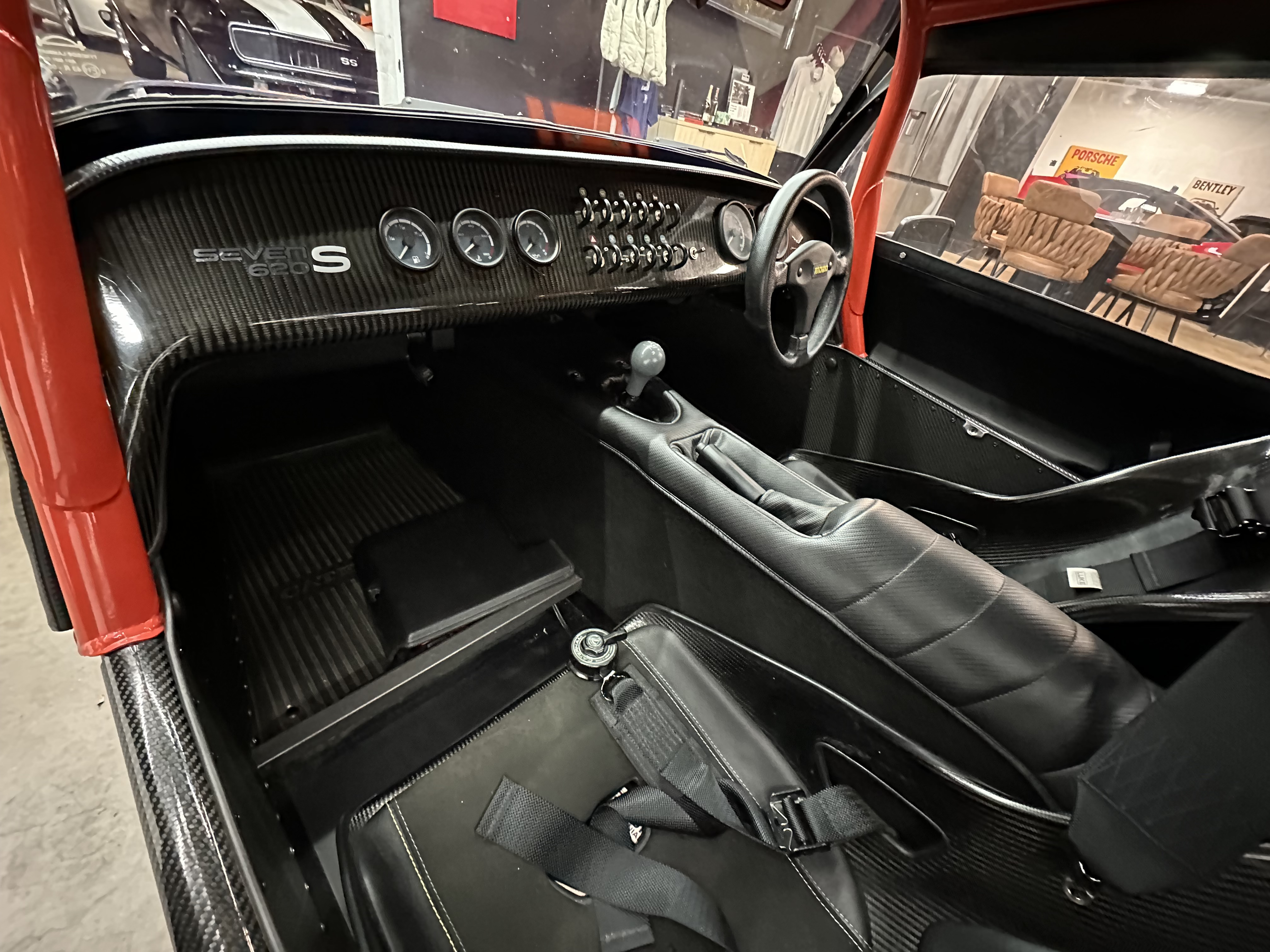

The rubber gaskets around the dials in the below photo were fixed with Amazon replacements - 5c a gasket.
