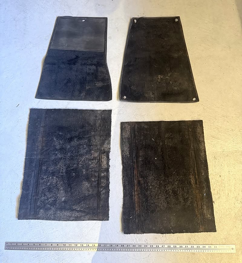

Razomatic Posted October 22 Posted October 22 (edited) Does anyone have recommendations on upholstery shops in the Los Angeles area to recreate floor mats, transmission tunnel carpet, and boot mat? It's for an imperial, long cockpit, live axle chassis (just in case anyone has a set to sell). The chaps at Redline were able to get me a bulkhead carpet, but the rest are unavailable. Any suggestions or guidance is appreciated. I've never purchased auto upholstery services. If you've paid for this type of work, what should it cost? Edited October 22 by Razomatic fixed typo

Razomatic Posted October 22 Author Posted October 22 5 minutes ago, anduril3019 said: https://bestwayautoupholstery.com/ Thank you so much. What does your "gut" tell you this should cost? I was thinking $200 for each mat (5 of them) and maybe $800-1000 for the transmission tunnel seemed roughly reasonable. $2000? Am I way off? The original transmission tunnel carpet was not delivered with the car. It had been eaten to shreds by the mice. So that has to be recreated from photos and measurements.

Origin7 Posted October 23 Posted October 23 If you’re considering doing it yourself, I found it to be a manageable project with some time and patience. I did mine last winter, cutting the carpet myself and having a local shop bind the edges before gluing it in. The original high-pile carpet is pretty forgiving of small differences in the fit. Materials came to about $300. 1
Razomatic Posted October 23 Author Posted October 23 6 hours ago, Origin7 said: If you’re considering doing it yourself I had not thought of that option, but it does make sense. Great input, thank you. The original mats under the seats didn't even have binding!
Razomatic Posted October 23 Author Posted October 23 21 hours ago, anduril3019 said: If you end up getting a quote please share. I just got my first quote. It was $3700 which seems too high. He also asked if I wanted "sound dampening padding underneath" which made me realize he didn't understand what he was looking at.

Origin7 Posted October 23 Posted October 23 4 hours ago, Razomatic said: I had not thought of that option, but it does make sense. Great input, thank you. The original mats under the seats didn't even have binding! You're welcome! There isn’t much binding required. I only had the top and sides of the firewall carpet bound, along with a strip under the dash. The carpet under the seats doesn’t need binding. I haven’t made the floor mats yet, but coincidentally, the material arrived today. I’ll cut them to size, have the edges bound, and add some Lift-the-Dot fasteners. That should be all they need. If you decide to do it on your own, WoodWeld is a great contact adhesive (stay away from the spray stuff). I'd also recommend German square weave fabric. It cuts easily and doesn't fray easily. 2

Timothy Keith-Lucas Posted October 24 Posted October 24 I've done it, and endorse the rubber backed carpet and the notion that carpet is pretty accommodating in fit. I'll add two considerations: Do the fitting with reasonably stiff paper, even taping bits together at odd angles to get around the curves, and then use that as your template for cutting the real stuff. Second, recognize that your heels sliding up to get to the pedals really rips up ordinary carpet, which is why professional sets often switch over to hard rubber for the toe box. Do try doing it yourself. It's not a horrible task, and inexpensive that way. 2
Razomatic Posted October 24 Author Posted October 24 On 10/23/2026 at 3:20 PM, Origin7 said: If you decide to do it on your own... Inspirational! Great work @Origin7. It looks terrific. Thank you for sharing photos.

Razomatic Posted October 26 Author Posted October 26 10 hours ago, Timothy Keith-Lucas said: I've done it... It's not a horrible task, and inexpensive that way. Thank you Timothy. I think I'd also approach it as removable carpet mats, as on the original. Perhaps using velcro to keep it in-place instead of the snaps that did not survive very well. I agree that retaining the rubber under the heels is important.
