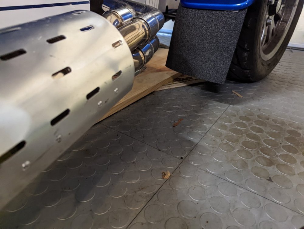

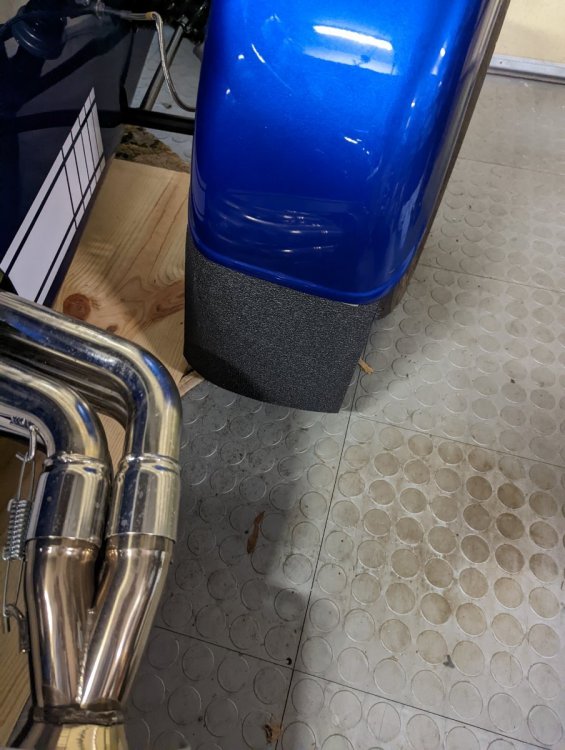

Austin David Posted May 26, 2022 Posted May 26, 2022 I'm also experimenting with flaps. Some light notes here as things progress. The platform is a newish Caterham, Duratec (360S). I'm using recycled rubber material, about 1/8" thick. I've cut two 8x8" squares, and VHB-taped them to the back inside of the cycle wings. They are pretty flexible. The RHS is long enough that it could hit the primaries, but has not yet been an issue on a few test-rides around town (50mph max, mostly much less). Significant improvement on gravel kick-up. Anecdotally it sounds like less pinging, and empirically I'm picking less up out of the seat (and my shirt / face). If this configuration becomes permanent I may extend the material to fix to the cycle stay, and tap a few screwholes on there for a more permanent mount -- and to offload some pressure from the fiberglass. I'll also round off the corners, of course
