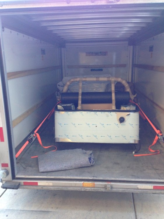

  9. I did the same thing in 2015. I arranged to pick up an enclosed U-Haul trailer close to Vail on the way over (from LA). I think U-Haul offered "contents" insurance by the day. That along with "creative" parking at night got me home without any trouble. Try posting your route home on this forum and maybe you can get some secure parking for the couple of nights needed. As I recall, I parked the first night across from the police station in Glenwood Springs. The next night I was able to back the rig in under the ramp in the parking garage of the Marriott we stayed in in Las Vegas (I was a frequent visitor for work for a number of years and knew the bellman). Next night home. I would be more worried about the trailer being stolen as the contents will be a chassis sitting on the floor filled with boxes of parts, none of which are readily marketable. All U-Haul trailers have a tracker built in now. Good luck. Tom's a great guy.

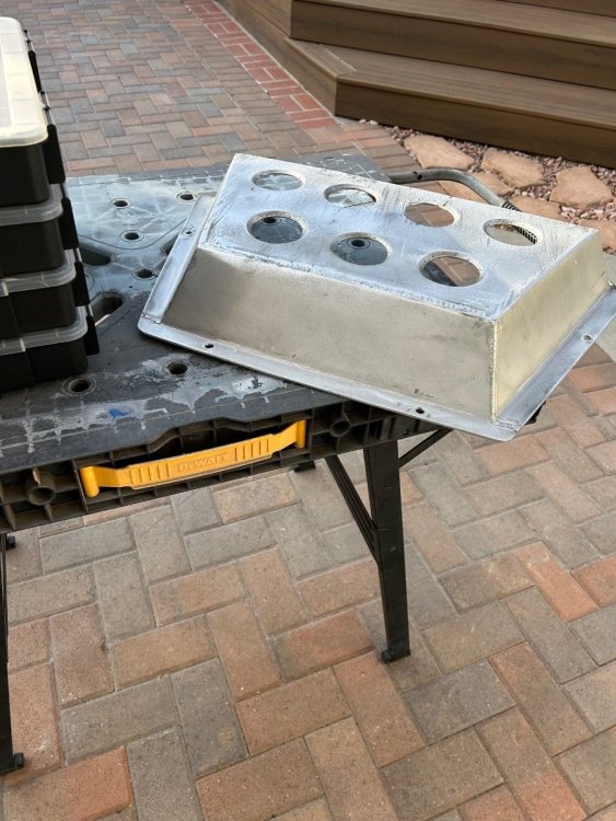

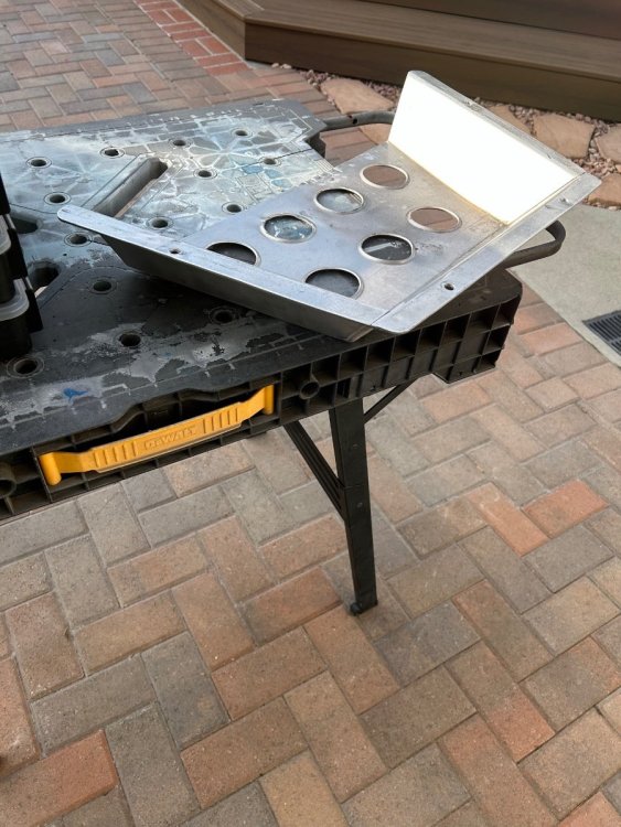

  14. While I have a 2.3l Duratec, I was similarly concerned about ground clearance . I run a Raceline aluminum wet sump currently. The Raceline dry sump extends nearly the same distance under the block so no clearance benefit there. I use an aluminum skid panel instead. It clears the sump by 1/2" and matches the bottom of the T-9. It is fabricated from ⅛" aluminum and mounts directly to the chassis. It's strange enough to absorb the hits and durable enough to be pounded back out after the major ones (and that's after being laser focused on the road surface while driving!). ong
