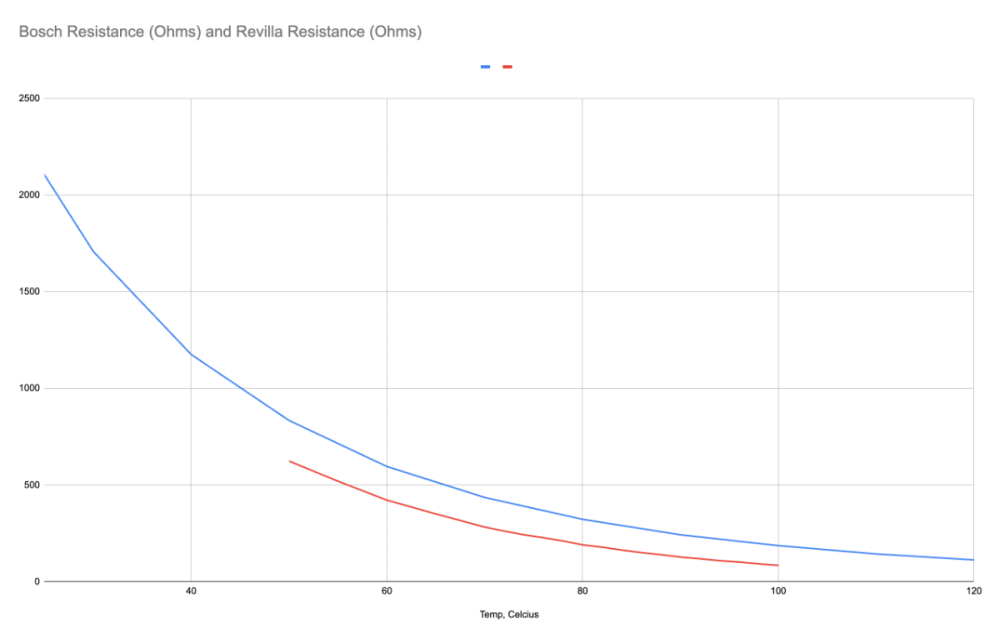

Thanks John. I did a quick plot compared with the Revilla data from above and they look similar although there is not a fixed offset. I'll probably end up trying each one and hope to get something close enough to be useful. Temp C Difference (ohms) Bosch is higher 50 210 60 174 70 153 80 132 90 115 100 102

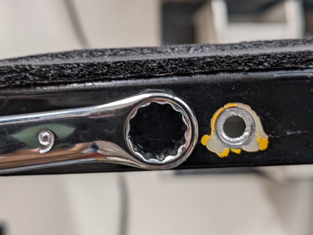

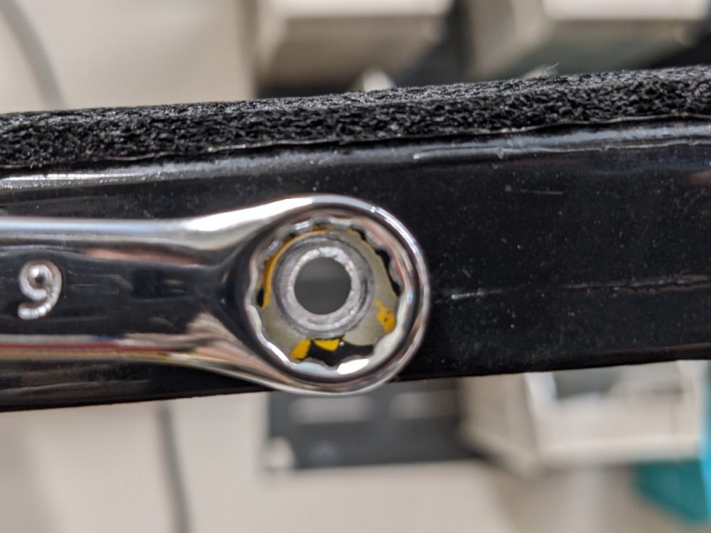

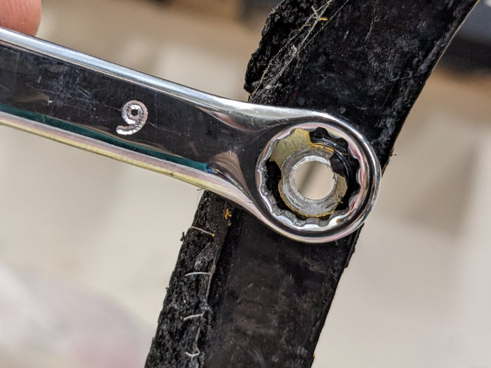

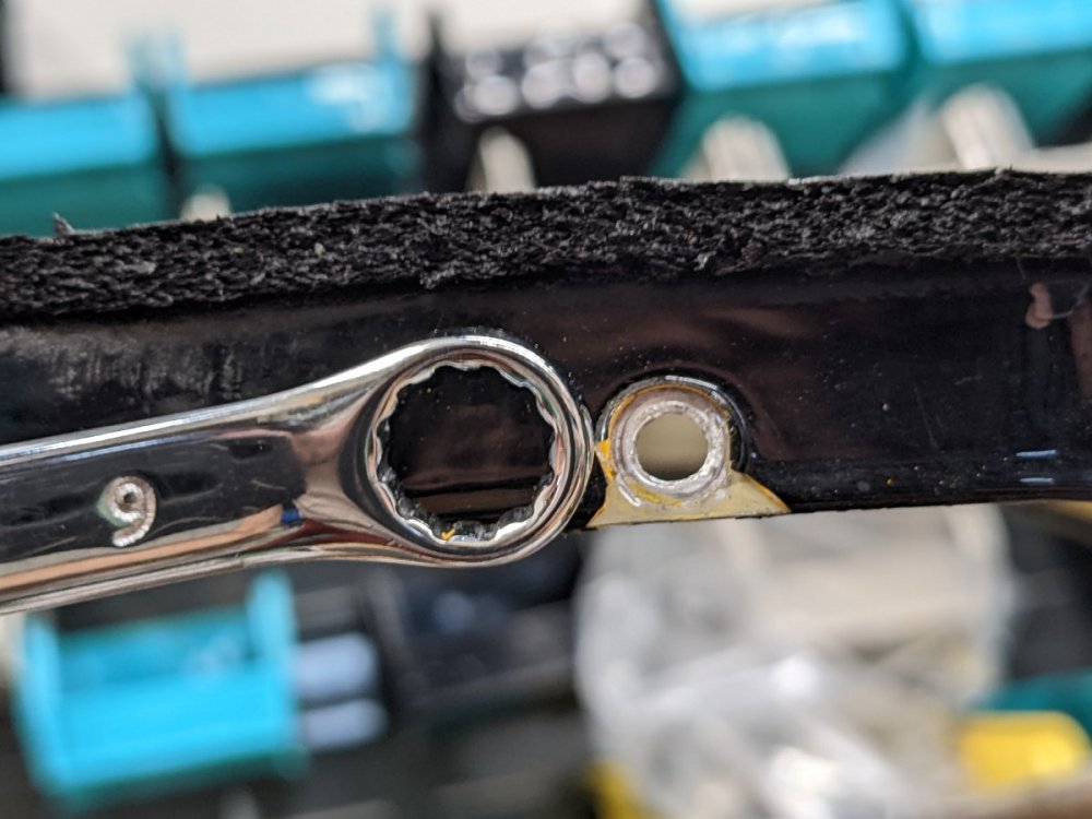

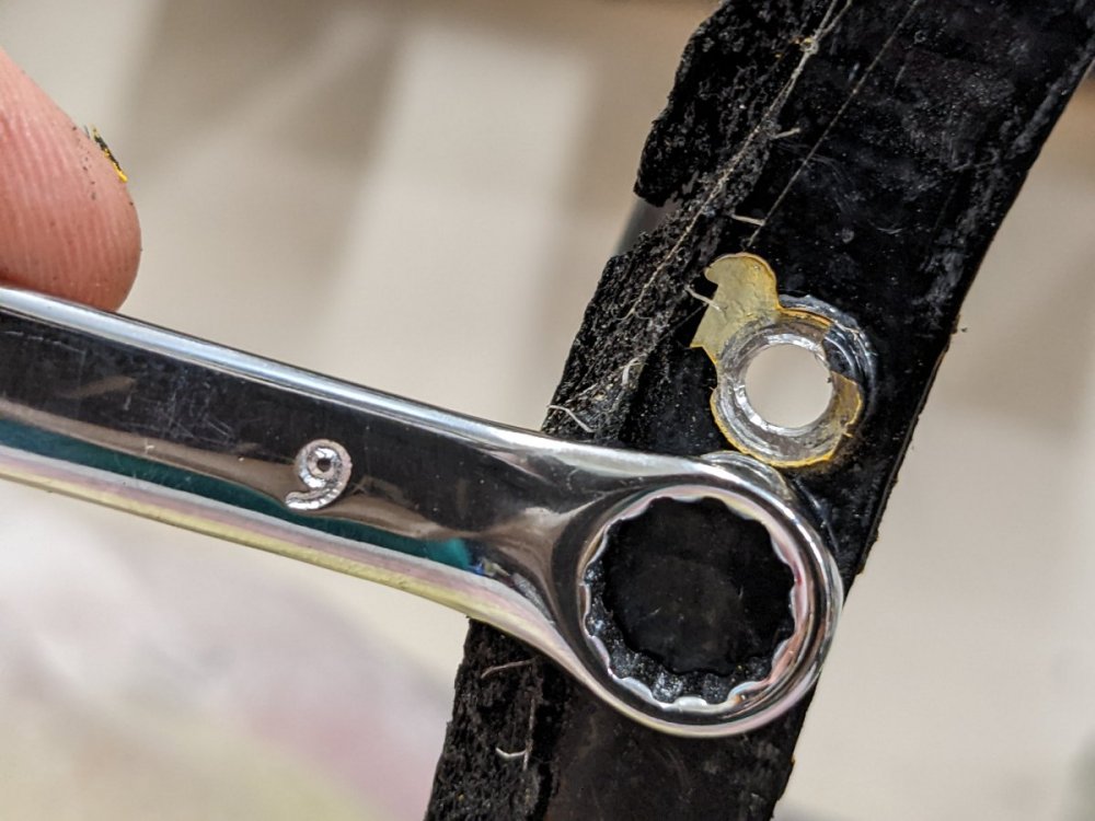

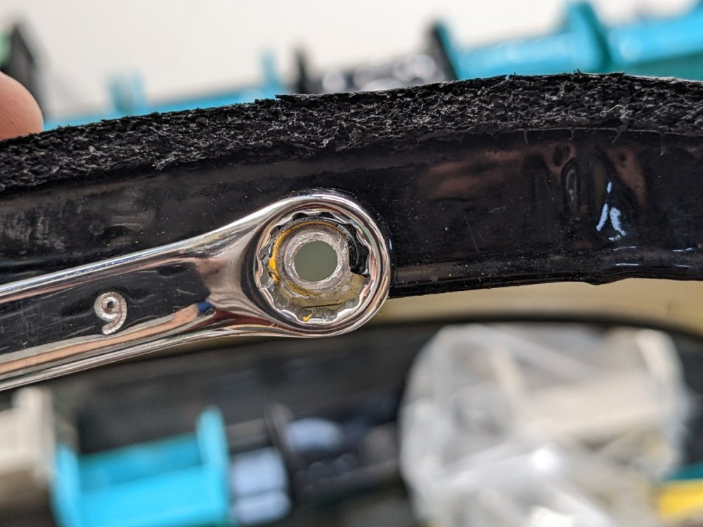

Taking into account my plan for use of washers with outside diameter 9mm https://www.mcmaster.com/97763A822/, on my car which has been repainted at least once, there are definitely chips that will be visible outside the diameter of the washer. (Mis)Using a 9mm wrench instead of calipers, see some pictures.

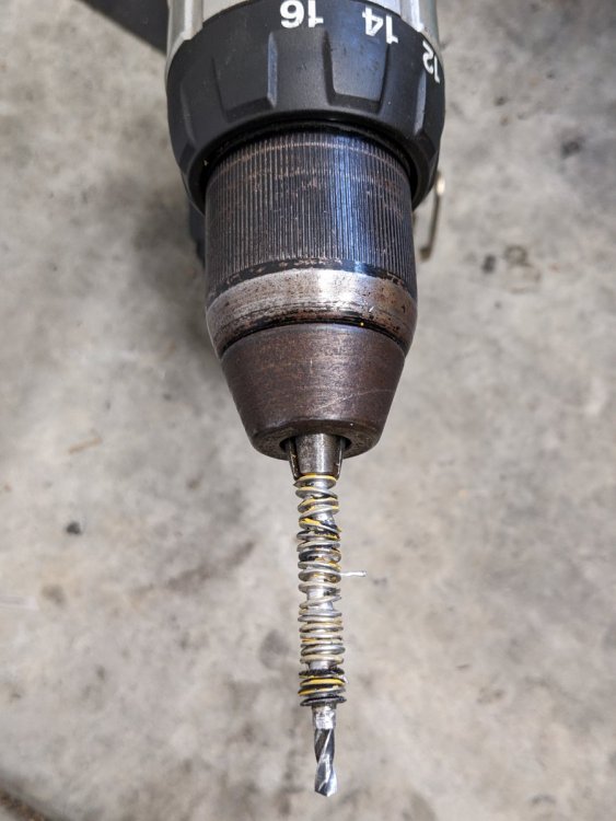

Hi John, I'm in the process of making this change now, I went with a larger drill bit (a #24) and drilled the rivets out (heads 'twisted' off and all 24 are lined up on my drill bit) but I was not too worried about my paint inside the engine bay where the scuttle meets the bonnet. I imagine you could do something like using a small hole punch or a knife to scribe around the head of the rivet to break the ring of paint before drilling so you got a nice bare aluminum ring rather than chipping or tearing the paint. I don't know a ton about rivets but I think unless you used a sheet metal drill bit the thin wall of the head of the rivet is always going to twist when the bit breaks through and pull off. My plan is to re-fit using low profile aluminum rivnuts https://www.mcmaster.com/91230A221/ and plastic screws in order to save on weight. I am basically treating the mounting of the scuttle as a cosmetic piece under virtually no load.
