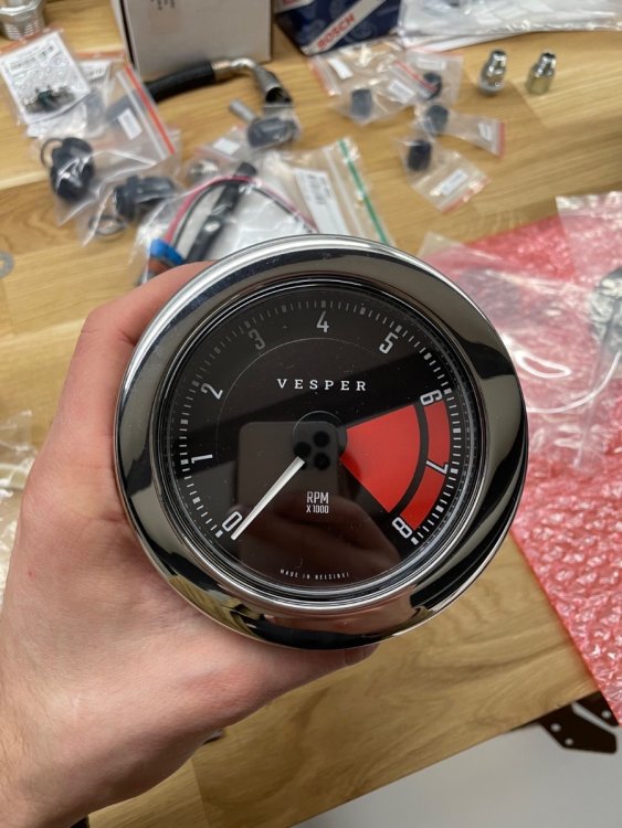

  10. We made instruments for our boat project (Vesper) just as MV8 proposed, i.e. purchased new KUS GPS instruments, that have a removable screw on bezel and made new dials. I tried to find shops that would make the dials, but no luck. In the end we used a UV printer available for free at a local library and the base was a 1 mm clear acrylic. We had the dials still attached to a sheed with tiny tabs for alingment and printed directly on the acrylic. The quality is great, not good enough for a watch, but worked for the dials. Design: Prints: Assembly: For the bezels we might still make custom ones. And yes, we also made all the small ones, like oil pressure etc…

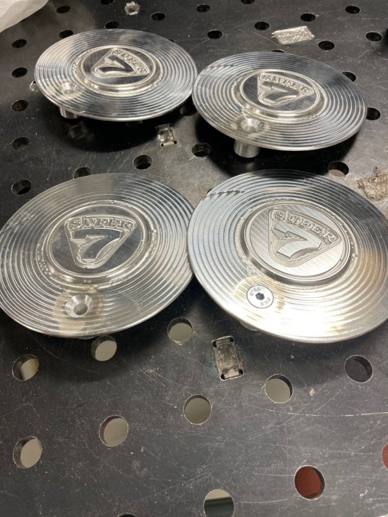

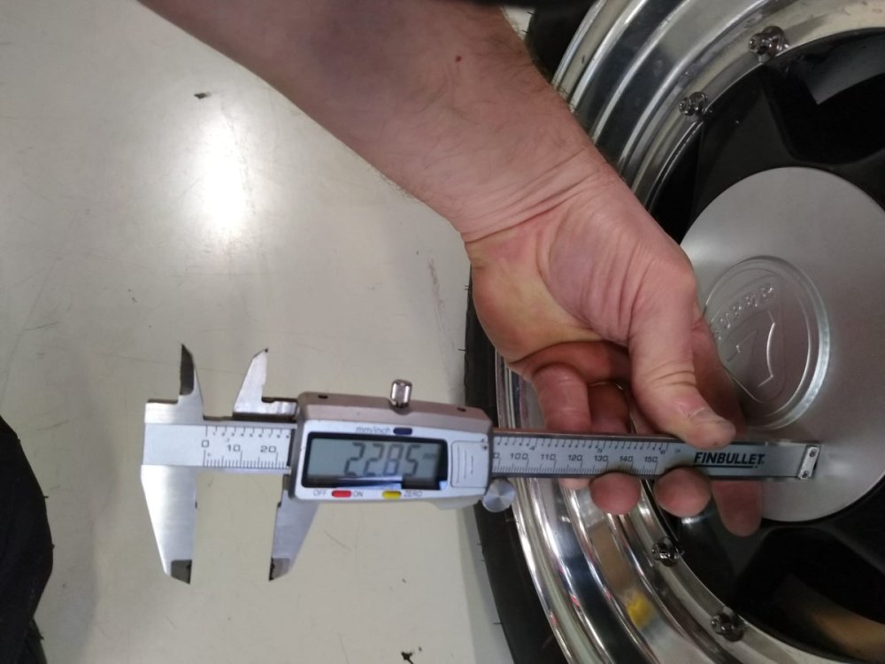

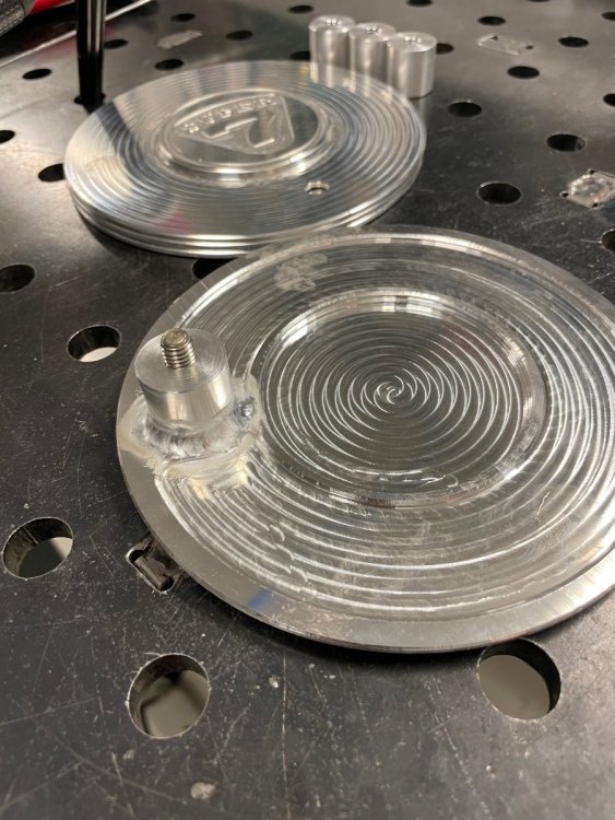

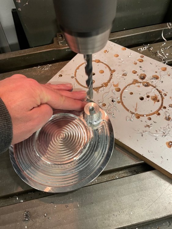

  13. Mika’s wheels have 22.9mm to the thread start, so if we can hit this, then no more wonky tightening issues. V, you might have to file the bosses down, if they are too long for your wheels or there is a variation. The bosses got an M8 thread first, so welding them on was easy: Which was then drilled out to 8.5 mm and a simple chamfer was added to the front side: A bit of sanding and a bead blasting next, then these are ready to go.

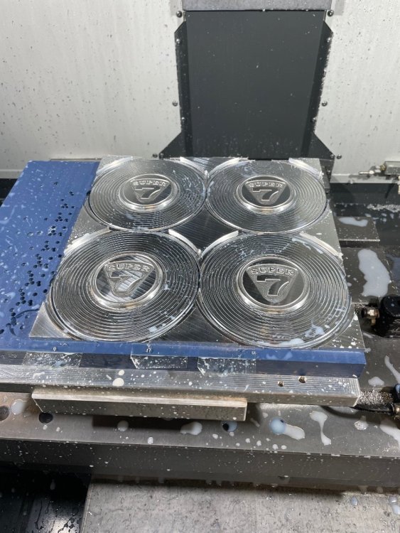

  14. Thanks, now I know more of SLR center caps than I would have ever dared to dream about… Today I had finally some spare time and commanded the machine to make some chips:

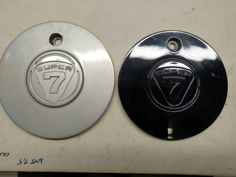

  15. The AIM installation looks great! I have the same ”doesn’t seem to be in the center” visuals with my gear change indicator, when not seated.

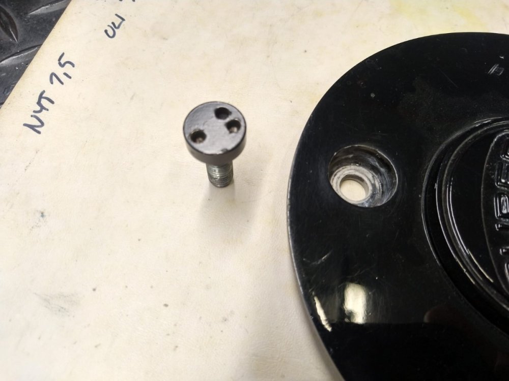

  18. A test fit turned out ok: My friend had two original sets, one out of plastic and the other out of aluminium. The alu version is slightly larger in diameter with 159 mm - apparently there are different versions of the wheel. Also the attachment bolt has some sort of security feature…

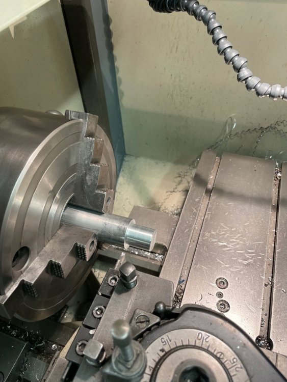

  19. Plan is to machine a round cylinder on a lathe ( x 4), weld it to the backside and only then chamfer from the front. Is it a 5 or 6 mm bolt btw? Yeah, the whole thing is quite a crappy design.

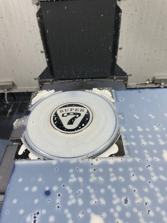

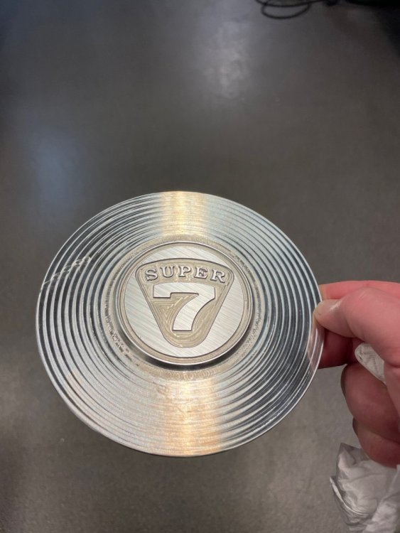

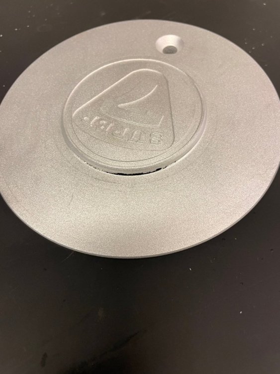

  21. First test piece turned out ultra light… actually a little too light, as the aluminium I am using is not heat treated. The bead blasting almost went thru… but the logo turned out nice! IMG_7118.MOV Well, I’ll use this piece to check the dimensions next.

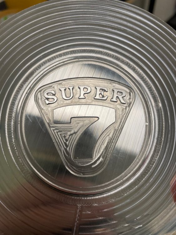

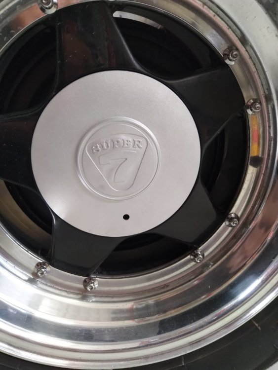

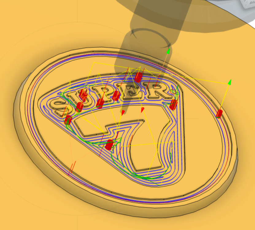

  22. Vovchandr has those lovely SLR wheels, but no caps and since they are no longer available, let's figure out how we can make him a set. Original caps are 2 part, however it is easier to make them as one piece. I have the caps modelled now in 3D by using 6 mm thick aluminium plate as stock and also tried to make them as lightweight as possible: The Super 7 logo was the most work - the easiest would be just to have a circular recess and stick a domed 3D logo sticker, but let's try to do it first with machining. If the caps are painted/powder coated, then one could sand out the logo nicely! The Super 7 has quite small features, so the first operation with a larger endmill leaves areas that remain unmachined:: A tiny 1 mm bit should get most of the remaining material out: And perhaps finishing off a chamfer tool (sharp) to follow the lines and clean up any burrs: Vovchandr provided me with the dimensions, so next task is to make one and luckily I can testfit it locally first. Once the dimensions are verified, then I'll also post the step file of the 3D model here.
