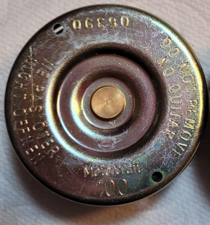

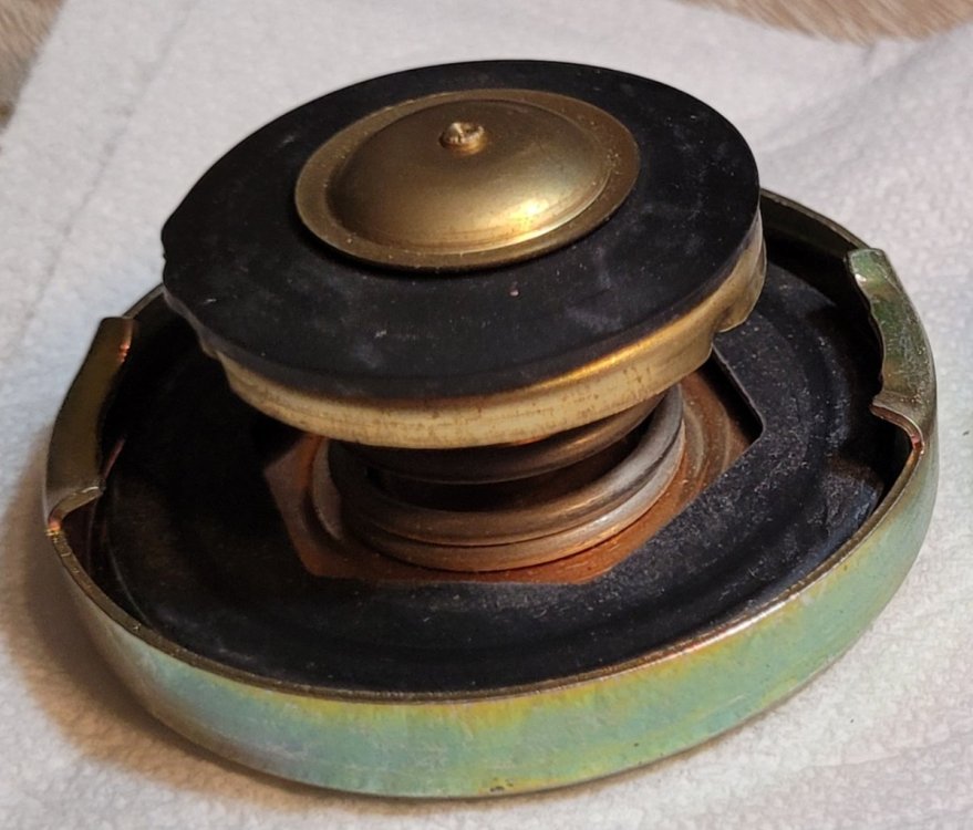

Mine is not sucking back the coolant because is the wrong cap.
The problem that causes no automatic refilling of the system is that it has no upper seal.
In addition, I think the lower seal is too short.  I don't feel the spring-back when I install the cap.  The vertical distance on both housing and cap is 20mm.  It should be more on the cap than the housing.  Therefore, installing an upper seal on this cap would solve the lack of suck-back, but not solve the fact that the cap will not pressurize the system.

06390 on the cap
This is the cap that came from Caterham

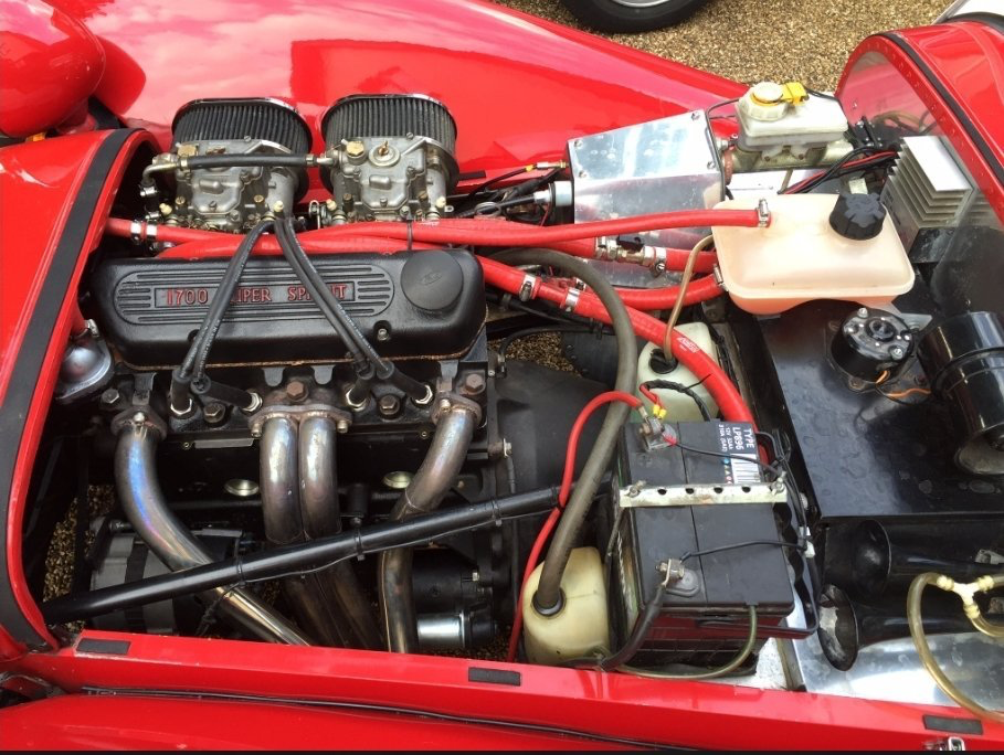

Noticed this thread and I have been thinking about my 86 S3 BDR. I don’t even know if it had an overflow or expansion tank on it when it was new. Currently there is a bottle up the radiator that is the same as the bottle for washer fluid. I have a feeling that it was just added on and didn’t come with it. As small as the radiator is I would have expected an expansion tank that allowed the antifreeze back into the radiator as it cooled. With a radiator this size I think you want all the coolant you can get all the time.
Does anyone know if it came standard with an expansion tank?
A great variety of expansion and overflow recovery tanks have been fitted to various models with different engines over the years. However, I've seen three BDA Cats with the same overflow tank in the same location, plus it is ideally sized and located for the space, so I think the odds are very good that it is oem. Rubber hose through a hole drilled in the top of the tank, forward of the cap and the hose will reach the bottom. Vented tank. May be a small hole in the cap.
Edited by MV8

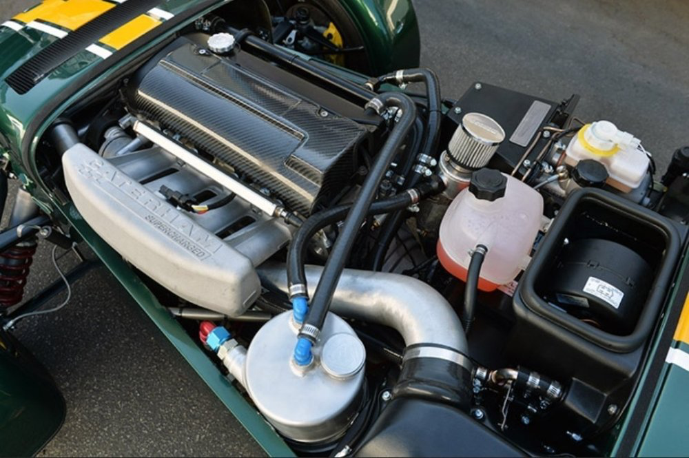

I can confirm that I've also seen the same setup on every BD powered car I've laid eyes on.  My car uses the same bottle but it's attached to the drivers side footwell instead of being up by the rad.
Cat has been using this bottle for decades

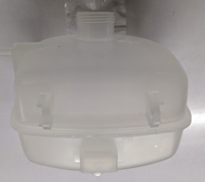

Yep, I think that is the tank I have.IMG_0172.thumb.jpeg.c0f9f72fe89b7d03534cf22cb71fbc46.jpeg

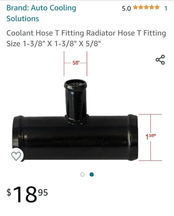

I have sourced some new parts for the closed conversion:
Screenshot_20240120_191832_AmazonShopping.thumb.jpg.d6abc5921b40a8ae2b59c71ecd988b25.jpg
Amazon, of course
And:
Fiesta Mk2/3/4    PN:6814635
Samco Sport Hose kit:
The hose kit comes with 3'7" x 5/8" heater hose, perfect for the smaller expansion tanks. That length is the length from the rad mount to the footwell shelf edge. Maybe a little short for a scuttle mounted bottle to a lower hose Tee, but adequate for anywhere else.  No top bleeder hose.

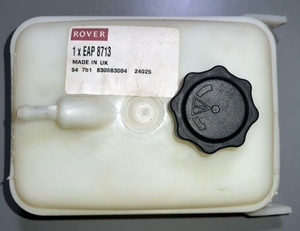

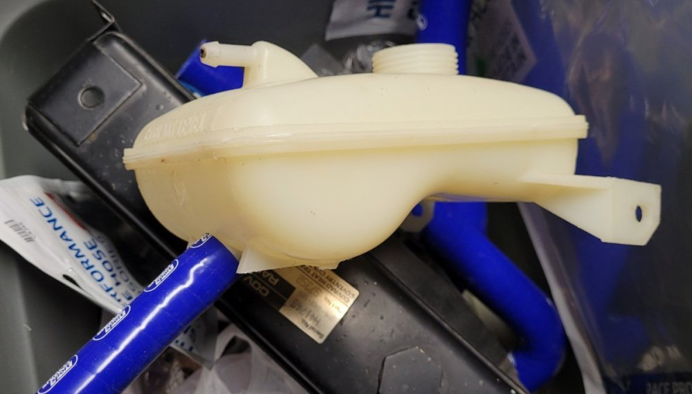

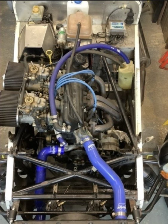

Lets discuss this tank, the Rover series 200 & 400, PN: EAP8713, and its cap, Rover PCD100160.
It was used by Caterham on the K Series, Sigma and early Duratecs and mounted on the front top chassis cross tube. It's a fine tank but I found the Crossflow is mounted too far forward to use it on the provided brackets.  The hoses would be touching and there may be a height problem too.  If mounted high enough to clear the Fiesta TH, would it clear and fit under the nose?
Plenty of room for the K
Others have been able to use the 200/400 tank on the scuttle.
Notice the cap appears to not be the standard Rover cap.
Notice the fiesta thermo housings used.
Where do those "7" branded cases come from?
I like this Rover 200/400 tank but it's getting hard to source.
The pressures for the Rover caps are ideal, in the 100 bar, 16 psi range, and the mid point fill volume is 20oz.  I would prefer a taller and narrower tank to keep slosh away from the cap.  5/8" outlet.
Failing other options,I will use it.

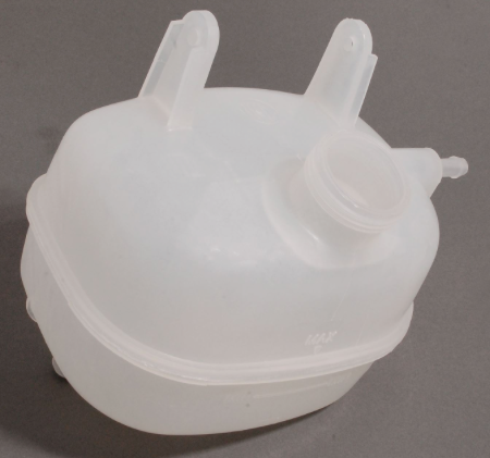

The Rover 600:
Used by Caterham and Lotus. Uses aforementioned Rover cap.
Also used on the Lotus Elise.  There's your cool Lotus connection.
I really like this tank, but those stubby legs are worrisome to me.
Cat parts still has the bracket
The 600s close cousin, the Rover 25:
Longer legs are probably an improvement.

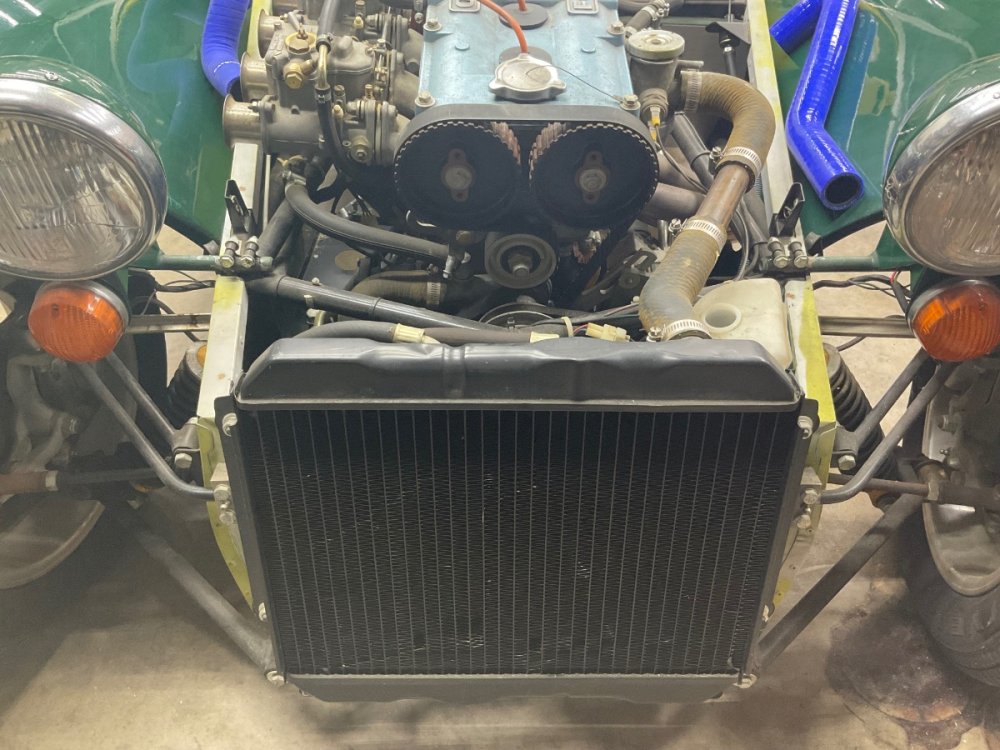

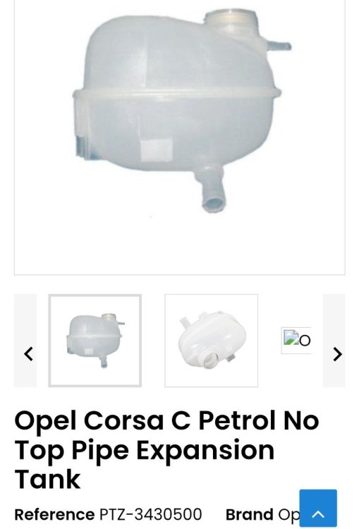

The Westfield standard appears to be Opel Corsa:
