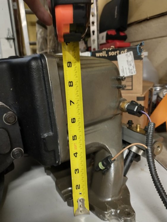

Vovchandr Posted November 15, 2020 Author Posted November 15, 2020 Upgraded the rails and weighted the supercharger. Not sure how it will fit yet but it's bigger and heavier than I remembered it. Figured when I send the ITBs for a refresh it will be a perfect chance to mock up the SC and see how it fits (or doesn't). Duratec SC looks much smaller in comparison. That might have to be long term solution. 43 lbs without rest of accessories!

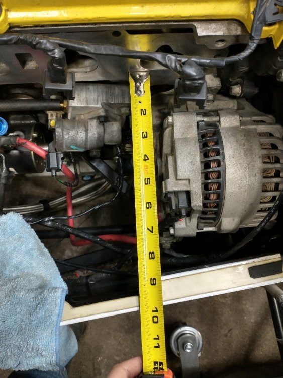

Vovchandr Posted March 12, 2021 Author Posted March 12, 2021 On 11/15/2020 at 4:18 AM, Vovchandr said: Upgraded the rails and weighted the supercharger. Not sure how it will fit yet but it's bigger and heavier than I remembered it. Figured when I send the ITBs for a refresh it will be a perfect chance to mock up the SC and see how it fits (or doesn't). Duratec SC looks much smaller in comparison. That might have to be long term solution. 43 lbs without rest of accessories! Expand So manifold is sent to rebuild. Decided to try to mock up the SC. Even if it will fit, it will be tight Off by about half an inch. I could possibly machine the face plate of the SC and try other tricks etc. Not sure what I'm going to do yet. Just know its not fitting direct.

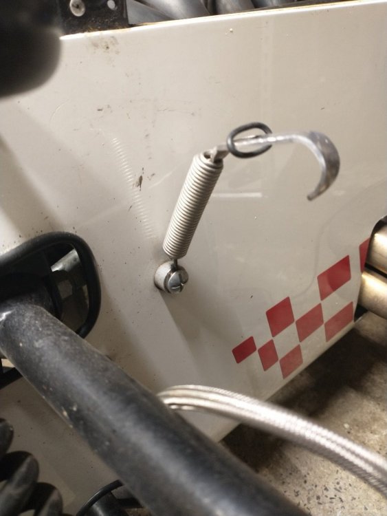

Vovchandr Posted March 12, 2021 Author Posted March 12, 2021 Also after the last track day I also discovered that my left hand cycle fender had issues... Again. Second time it doesn't want to survive a track day. Last time sika flex failed. Then hardware bolts failed. This year the actual metal of the bigheads has failed on 3 out of 4 fasteners. I only have 2 spares on hand so will have to order more. I have a feeling there is something wrong with the fairing stay so I will also be replacing it. Lucky I have one on hand. Never thought I'd have to be scraping these off. New formula of sika flex held without a problem. I used a primer this time too.

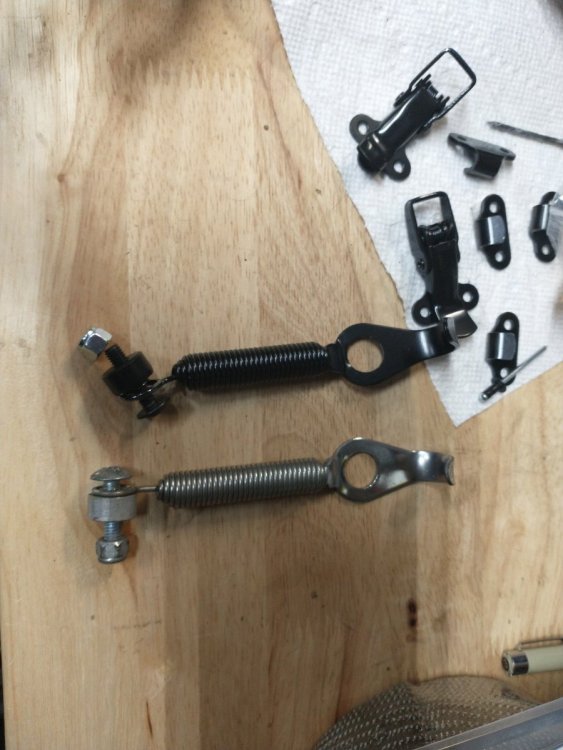

Vovchandr Posted March 13, 2021 Author Posted March 13, 2021 Started installing the black latches. Not looking forward to drilling rivets out and/or losing them in the frame.
wemtd Posted March 13, 2021 Posted March 13, 2021 28500 miles. my fender mount broke when removing this afternoon. I think that was probably over due...

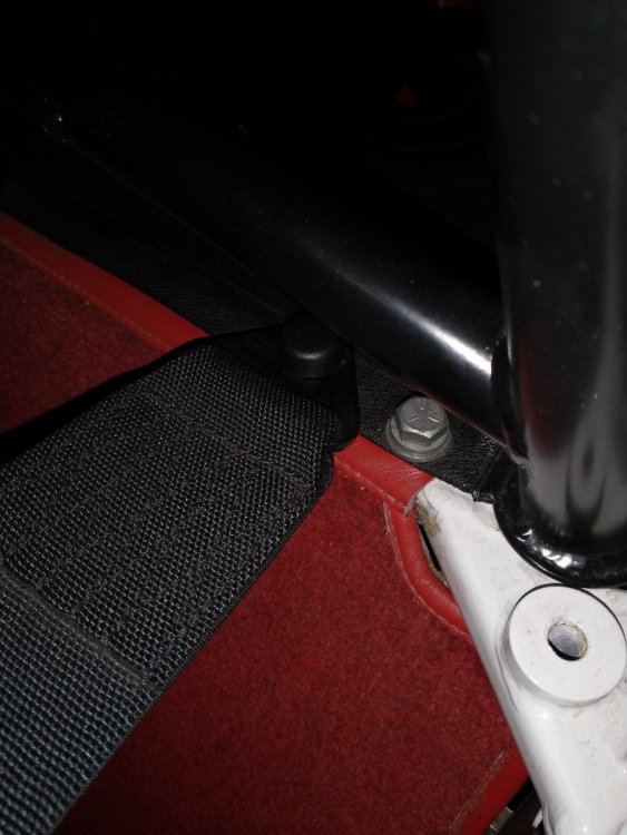

Vovchandr Posted March 13, 2021 Author Posted March 13, 2021 On 3/13/2021 at 3:34 AM, wemtd said: 28500 miles. my fender mount broke when removing this afternoon. I think that was probably over due... Expand Endless battle of keeping fenders on! Does anyone have a clue as to what this bolt would have been threaded for on my 7? I don't think I've seen others with it. The one next to seatbelt. Same on other side.
wemtd Posted March 13, 2021 Posted March 13, 2021 Simultaneous inertia belt anchor? i think Caterhams from the ?90’s like KitCat’s old car {my first 7 drive} had both 3 & 5 point harnesses installed.
