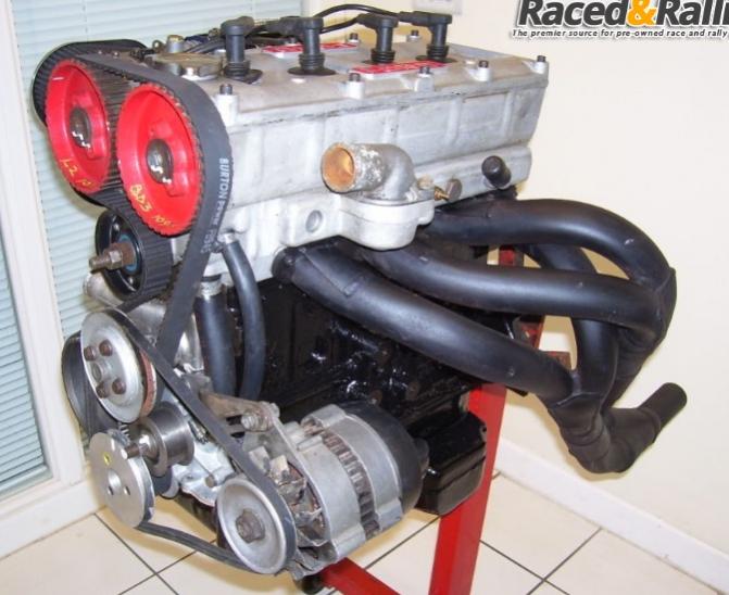

BlueBDA Posted December 8, 2019 Posted December 8, 2019 My (BDA/BDR) engine leaks lots of oil - like tablespoons, not drips. Some of it is from the oil tank, and I should be able to track that down and fix that. Some of it is in the area of the two vertical hoses at the front left on the engine - the hoses that run from the head to the block. One is rubber, one is braided stainless. Both use crimp hose clamps on both ends. Here's a picture of the top connections for those: I was planning to remove and replace those hoses, but based on how tight the space is and the type of clamps I might pass on this. Thoughts? It also might be leaking around the oil pan gasket, so I plan to pull the pan and replace that. Lastly, I am considering installing an oil check valve, like this, to keep oil from flowing from the tank back into the engine when at rest: https://www.pelicanparts.com/More_Info/RS30A.htm?pn=RS-30A&gclid=CjwKCAiA27LvBRB0EiwAPc8XWRHCdGVBbQxK6XPQO2TF3CwCmRYORiQuoJ_iN2t_yQt0Usz99qsCeBoCmMEQAvD_BwE It just seems like the oil flows back to the engine and finds places to leak out. This is a high quality part (and priced accordingly), which is used in the Porsche world. Thoughts? Also thoughts on other common leak points in BDA/BDR/crossflow engines?

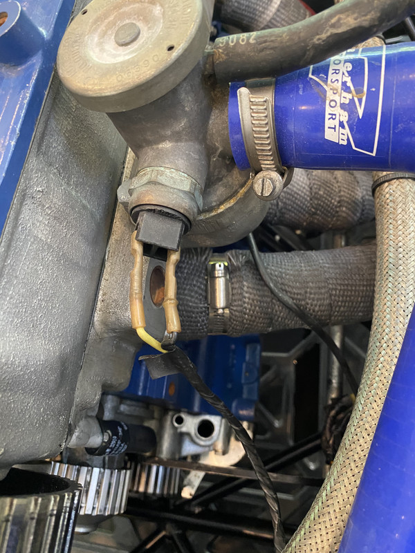

BlueBDA Posted December 11, 2019 Author Posted December 11, 2019 FYI this picture shows the two hoses to which I referred:

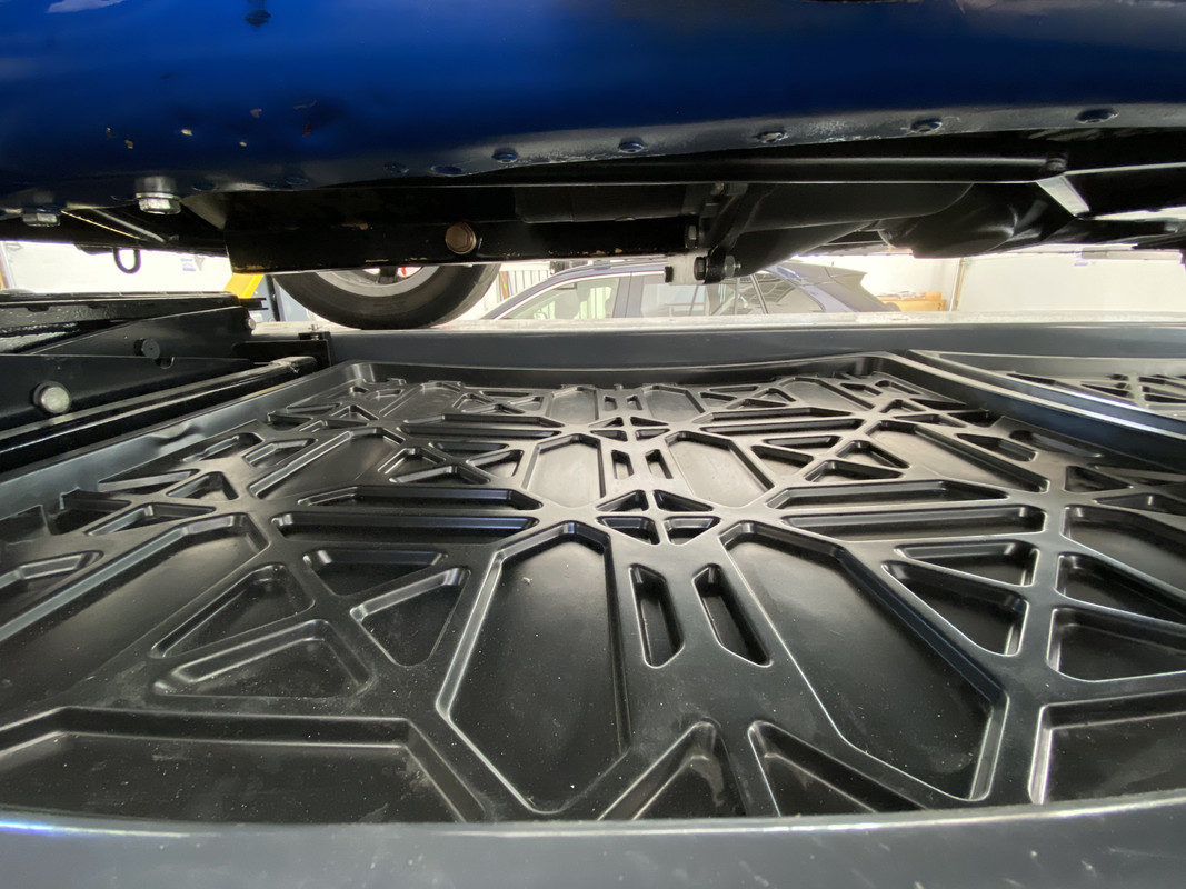

BlueBDA Posted May 23, 2020 Author Posted May 23, 2020 Update: I have replaced the oil pan gaskets, and just finished last week replacing the two tubes at the front left side of the engine. Those were quite a pain to do, as there wasn't enough room around the male fittings on the head and block for the tubes and clamps to fit. I had ordered and received tubes from Dave Bean Engineering, and strangely the smaller one had a .50" ID, but the bosses on my engine were 7/16" OD. Maybe that's why it was leaking so much? So I bought some 7/16" fuel line, and Dremeled the OD down at one end to make it fit in the tight space. Used Gates Power Grip clamps on both hoses, as someone recommended to me on LOTUS7.NET. A week later, maybe a couple of drops in my oil trays under the car. Used to leak puddles in a week's time. Success!
