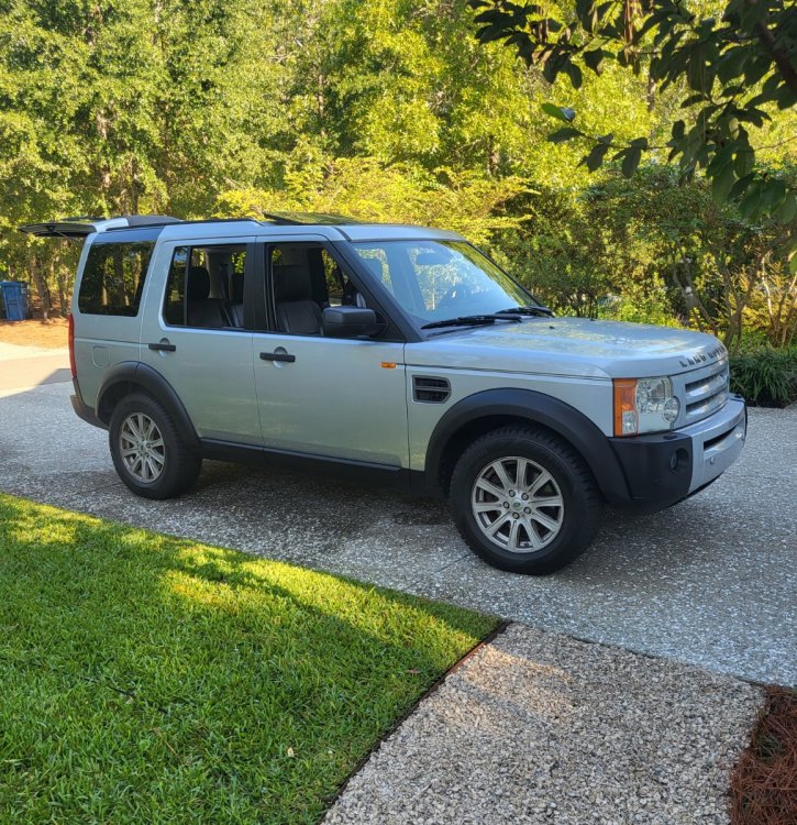

SENC Posted September 21, 2022 Posted September 21, 2022 @ProfGriff - what Discovery do you have? I just picked up an 07 LR3 as a tow vehicle and partial DD. This has about 130k miles (almost 100k fewer than the 2010 F250 it will replace) and, hopefully, is nearing the bottom of its depreciation cycle. Will need to do a little work on it, but fortunately there is an active owner network and you can still do a good bit of the work on these yourself - and we have a solid local independent specialist for those things I can't do. Any tips or things to look out for?
ProfGriff Posted September 21, 2022 Posted September 21, 2022 @SENC I have a 98 Disco1 that I rescued from a barn after it had been sitting for 8 years. It needed some major rust repair on the frame, floor, and inner fenders, as well as electrical repairs mostly due to corroded connectors and bad previous "repairs". I doubt that that is of any concern with your LR3 since you are in NC. Here on the right coast of Canuckistan, everything rusts. Other than that, I can't really help you, as I know basically zilch about LR3s. I will say that once I got the Disco sorted, it's been rock solid reliable. It just turned 100K miles. I tow my 7 on a car dolly with it. Cheers Phil 1
