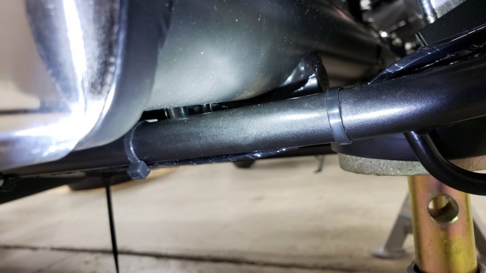

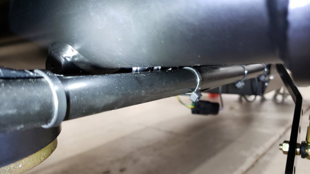

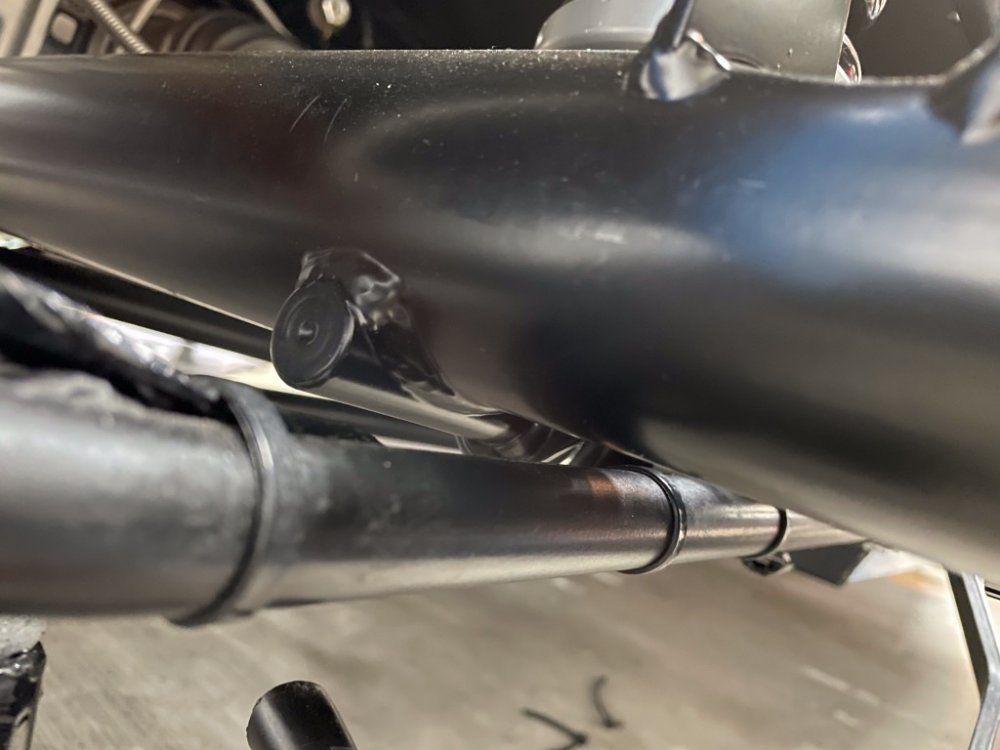

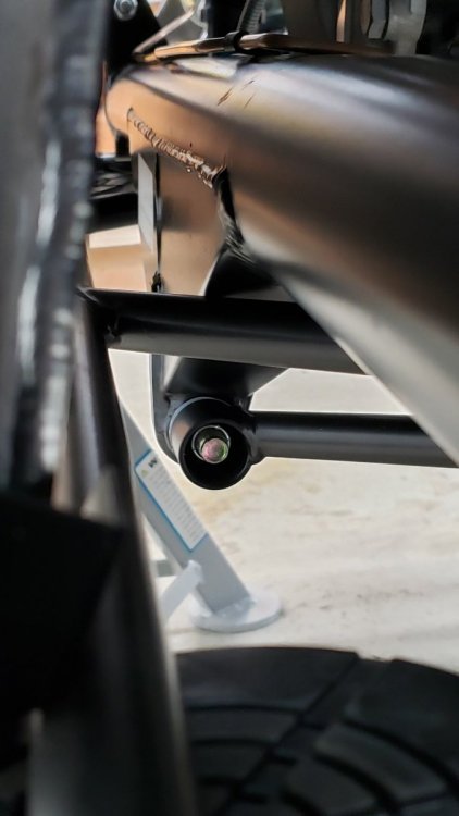

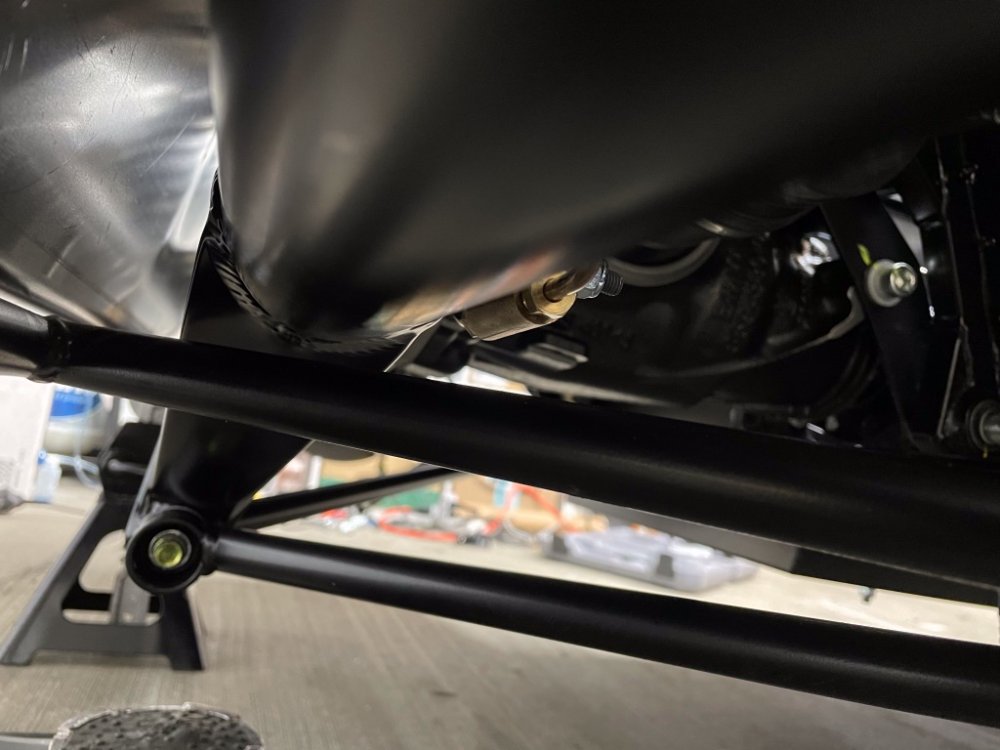

KnifeySpoony Posted April 26, 2021 Posted April 26, 2021 Another build question on my 420R. The rear suspension is completely assembled now. Is it normal for the DeDion tube to contact the angled chassis rails (the ones that run parallel and behind the A frame) when in full droop? I would have thought the dampers would limit the travel, but when resting the car on jackstands on the chassis (ie suspension unloaded), the tube droops and contacts the chassis. Seems like a bad setup...

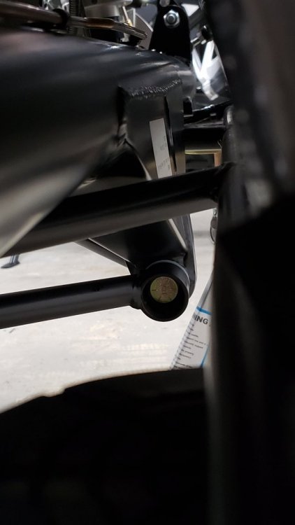

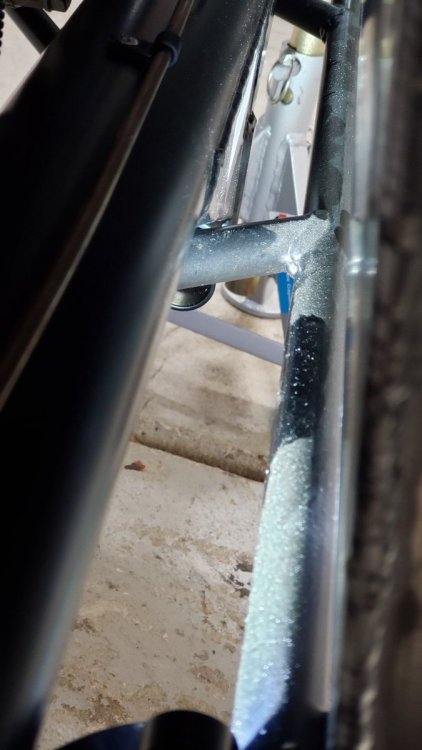

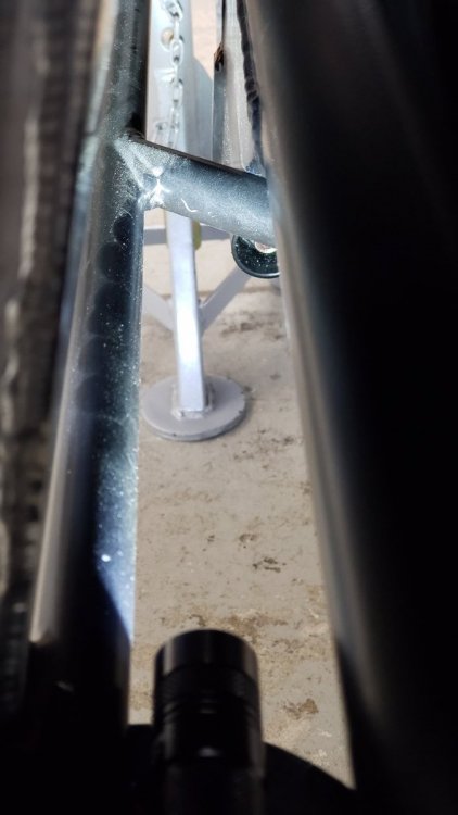

KnifeySpoony Posted April 28, 2021 Author Posted April 28, 2021 Ok here are some pics. It's hitting on the right side of the big triangular thing that hangs off the bottom of the dedion tube. Left side is clear. You can see in the pics. You can also see that looking at each end of the dedion (near the ears), where it hangs over the side chassis rails, the clearance is about equal. This suggests that the right side is not just hanging lower, which was my initial thought. I thought maybe the right sided damper was too long, but this doesn't seem to be the case. It almost seems like the diagonal chassis tube is too high or something.
JohnCh Posted April 28, 2021 Posted April 28, 2021 If I understand you description and the photos, one of the downward facing rectangular section's sloping sides hits the adjacent tube, but the other does not, yet the De Dion tube is equidistant above the chassis on either end. Is that correct? I am not familiar with the De Dion, so am probably way off here, but is it possible that the De Dion tube isn't centered within the chassis? -John
KnifeySpoony Posted April 28, 2021 Author Posted April 28, 2021 Yes indeed that does seem to be the case. The dedion is centered via the Aframe - there are spacer washers used to get the dedion ends equidistant from the side chassis rails, which was done (to a closer tolerance than the manual specs). I could shift some washers around to try to center it within those diagonal members instead of centering it on the side rails. However, there's only about 3mm clearance on the good side, so the gap would be incredibly small; I can't see how it still wouldn't be likely to hit with dynamic movement involved.

yogi Posted April 28, 2021 Posted April 28, 2021 On 4/28/2021 at 12:51 AM, KnifeySpoony said: Yes indeed that does seem to be the case. The dedion is centered via the Aframe - there are spacer washers used to get the dedion ends equidistant from the side chassis rails, which was done (to a closer tolerance than the manual specs). I could shift some washers around to try to center it within those diagonal members instead of centering it on the side rails. However, there's only about 3mm clearance on the good side, so the gap would be incredibly small; I can't see how it still wouldn't be likely to hit with dynamic movement involved. Expand The gap between the outer frame rail and your tube look fairly close to mine ± a few mm, perhaps it is just a bit of centering. I haven't found the frame to be very precise overall so I'd think a mm here or there is within tolerance. Once loaded the gap will of course increase (~1–1.5"), so unless you're going airborne on a regular basis I wouldn't think it'd be an issue. Then again, I'm new to this whole 7 thing.
KnifeySpoony Posted April 28, 2021 Author Posted April 28, 2021 I have spacer bushes in the top damper holes but they look different. I have an email off to Caterham to see what they say. I just measured by dedion centering based on the side longitudinal rails (as the build manual indicates), and i am within .5mm left to right. So some misalignment elsewhere is causing this it seems.
