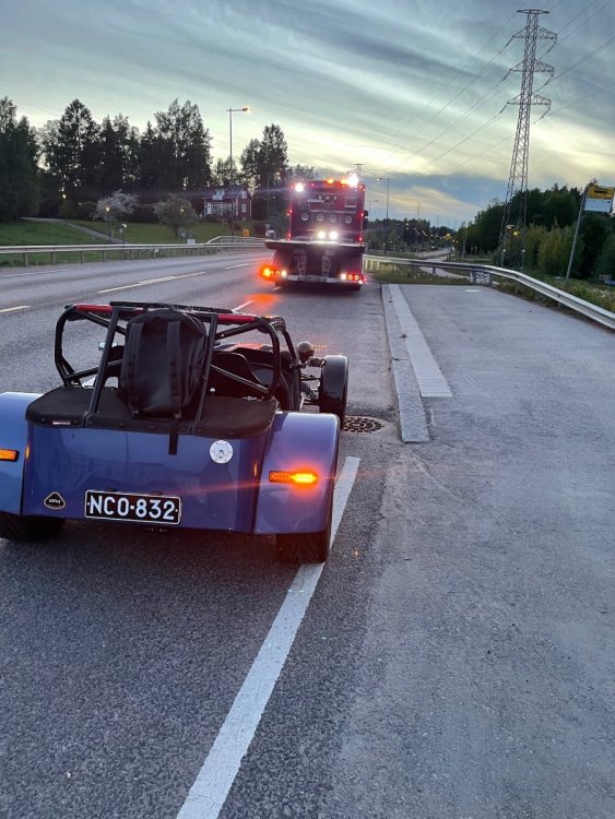

I was out for a drive last night and the engine suddenly shut down with a low oil pressure warning. After a check I tried a re-start, nice idle, no noises but also no oil pressure. So I ordered a ”taxi” back home:

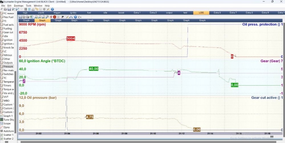

The engine log shows a clutched shift from 3rd to 4th gear, and right after the oil pressure starts to go down and the oil pressure protection function then kills the engine.

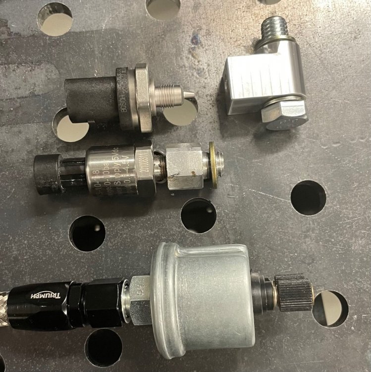

Back at the garage I checked the oil pressure with a cordless drill and everything was back to normal... My sensor is a Variohm type (but not an original) and apparently these knock-offs are no good, when mounted directly to the block.
No Variohms in stock anywhere near, so I guess I’ll switch to a modern Bosch sensor (0261230340). I’m not very excited of a remote connection to the block, let’s see how I’m going to do it now.

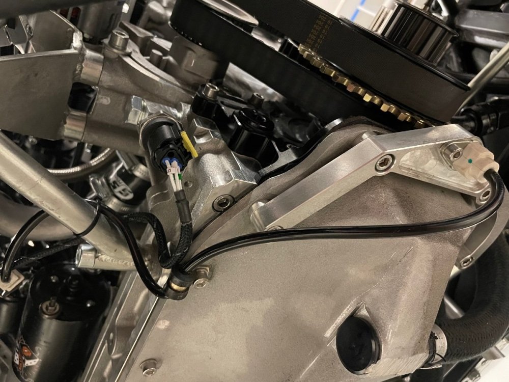

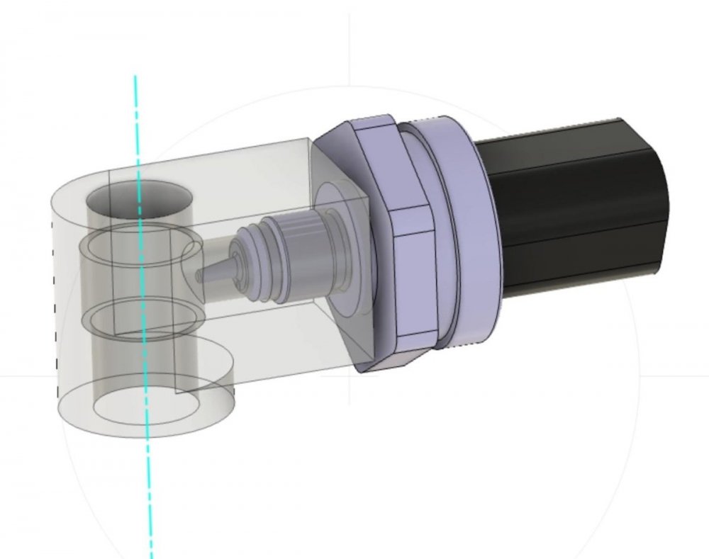

I designed and made a 90 degree Banjo. The sensor is M10x1 and the Millington oil port is M12x1.75:
Bosch on top, Variohm/clone that failed in the middle and old style Bosch below:
It took me a while to figure out how the new Bosch connector works. The installation from below the car:

The variable resistance sensor shown in the same picture with the Bosch sensor are known to fail when mounted directly to a 4-cylinder engine block. I have seen them fail electrically and start to leak on small formula cars. Thank you for the information on the Bosch sensor. I wish I could find a piezoelectric sensor in 0 to 10 OHMs. I want to compliment you on your car and your fabrication skills. I wish I was as talented.

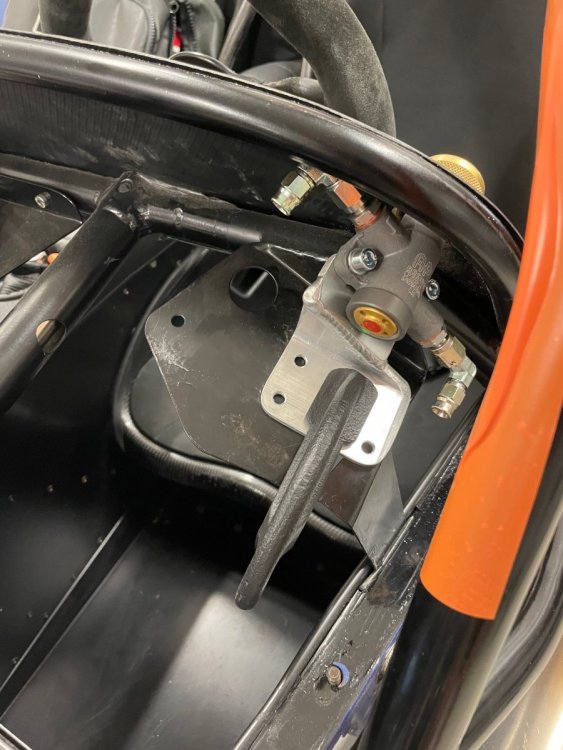

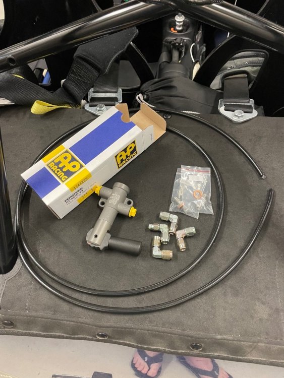

Compared to an Elise the rear end in my seven feels much too lively under hard braking, so let’s see if a proportioning valve will sort it out. The lever is huge compared to the cockpit… it will be fun to find a good location for it.

Sure, I’ll document both.

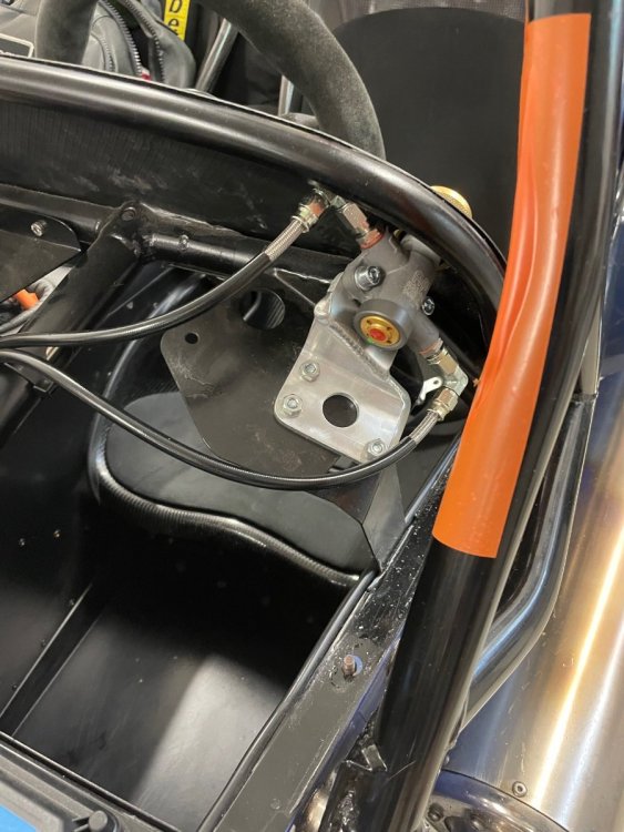

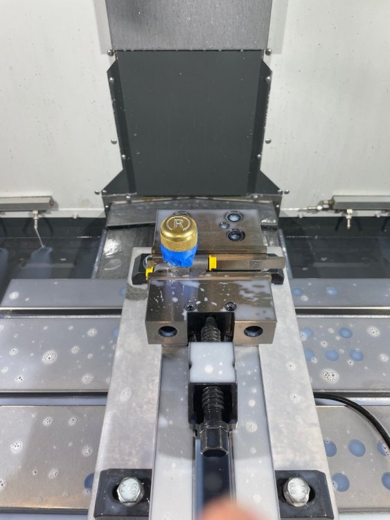

I couldn’t find a good location for the lever type bias valve, so I switched to the knob version and made a simple bracket for it from some leftover alu, that gets bolted to the plate where the wiper system usually is.
The angle of the knob matches now the steering wheel, which was a bit more pleasing to the eye than when aligned with the panel, as the knob is rather large.

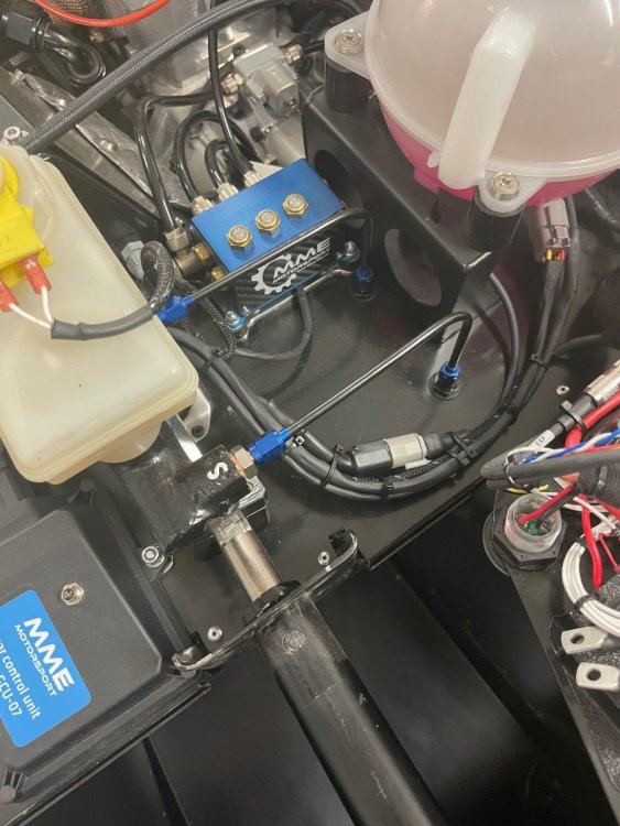

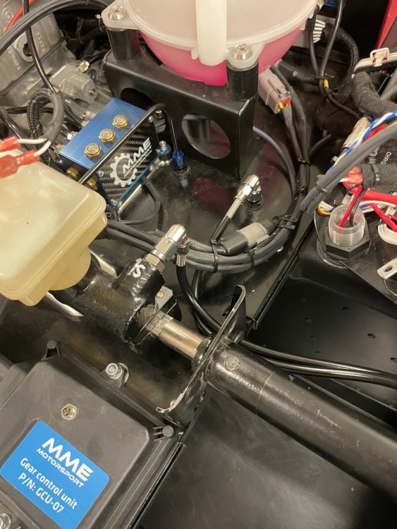

I had prepared for the connection when I made my brake lines last year and the valve will be simply connected in place of the short 90 deg hardline of the rear brake:
