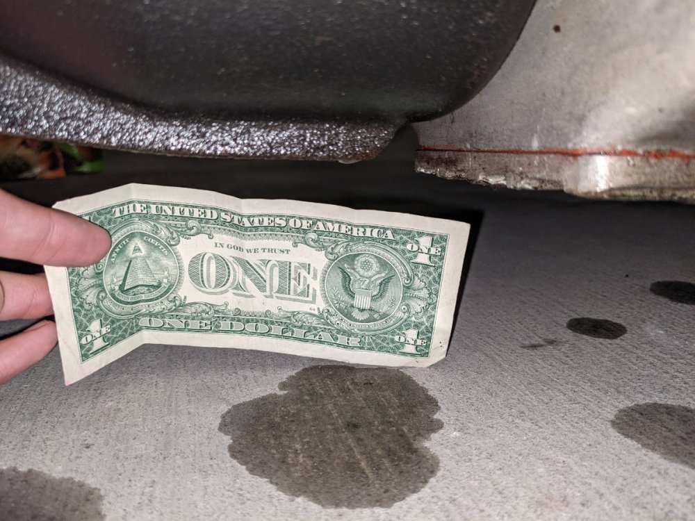

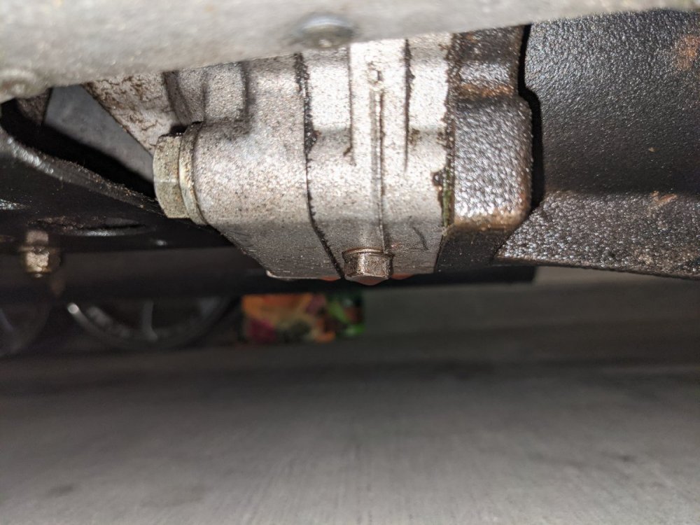

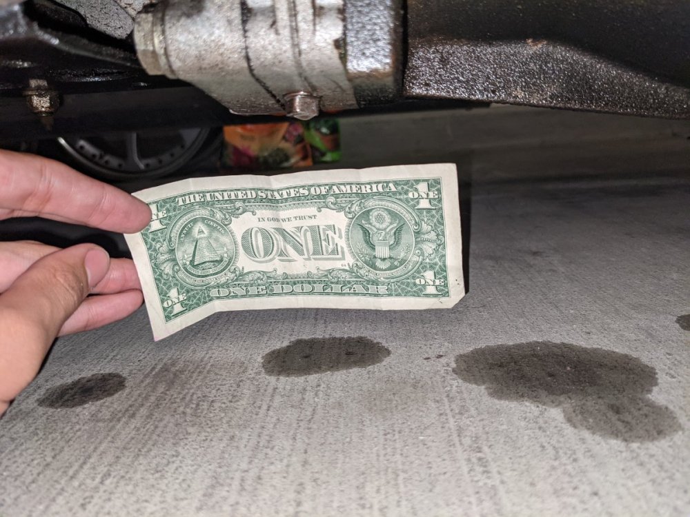

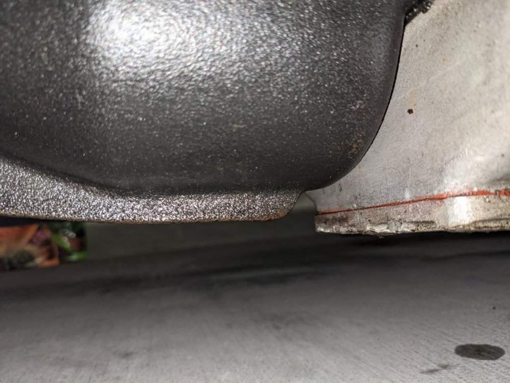

Source Posted October 11, 2021 Posted October 11, 2021 Good morning west coast. I picked up the 1994 HPC that was floating around on Hemmings for a little bit. I've been looking for a Seven since I sold my Elise last year, and this is my first one. I have a couple things that I need to do with it before I take it to the track. I was trying to figure out if anyone knew someone in the Vegas area that could work on it? I'm technically a certified motorcycle tech but I've never worked that career path and only really like doing the basic maintenance. I don't have the garage space or confidence in myself to do any bigger projects, and I'm still trying to learn where everything is on this car. There's a small oil leak right at the gearbox (Type 9 with straight cut gears) which I suspect is coming from the drain hole one of the previous owners drilled and installed on the bottom. That shouldn't be too bad a fix for me. Second leak is engine oil. I've no clue where it's coming from since it seems like it's somewhere behind the engine and under where the windshield would be, and I don't know how to access any of that without removing the drivetrain? I just know it leaves a puddle in front of the gearbox area. So I'd think maybe bell housing or something. The engine is a Vauxhall C20XE with a dry sump installed. I'd jack the car up and take a better look but I am finding conflicting information on where to put the jack to not damage the car. The Elise could easily be totalled if not lifted properly. Like I said, I'd like if I could find someone to take a look and fix what's going on. I know that that's probably not possible in Vegas since I only know of two other Sevens in the area. A Birkin and a Superformance. I apologize for my new person questions but appreciate any help or information you can provide. Glad to be part of the community and look forward to meeting some of you sometime in the future! Chris
coffee break Posted October 11, 2021 Posted October 11, 2021 Hi Chris, Everyone was new here at one time. At to the oil leak, how would you describe the "puddle". Dime, quarter size, Exxon Valdese? In the classic British car way, they leak. Keep the fluid levels up to full (engine and transmission) until the leaks are address. Good luck.
Vovchandr Posted October 11, 2021 Posted October 11, 2021 The type 9 is likely leaking into the bellhousing and thats where you see the puddles. I let mine leak until my clutch failed on the track, then once I was in there I serviced the Type9 and did the rear main seal fixing all the problems. It's a decently big enough job that obviously requires engine removal. If it's not too big of a leak I'd keep checking on levels and keep topping it off. Have you setup a cardboard underneath it to help pin point exactly where the drips are coming from?
Source Posted October 11, 2021 Author Posted October 11, 2021 I have yet to put a cardboard under there (Been lazy and forgetting every time I have taken it out thus far). I will do the cardboard now so that next time I take it out I know exactly how big the drips are. I attached pictures with a dollar bill for size comparison which is the only thing I had handy. The darker spots are the fresh ones from yesterday. Though it has dripped a few times in the garage so I need to do the cardboard to get an accurate measurement. As well as pictures from where exactly I think the drips are dropping from. Again, I am fairly sure that the gearbox oil which you will see as red in the picture is dripping from where one of the owners drilled a drain plug. The previous owner did not know where to check the oil levels for the gearbox or fill it. So I am unsure about that myself. Any information on that is helpful. The engine is dry sump and I was told I have to run the car until it's at operating temperature (80c?) and then shut it off and remove the cap on the bell housing to make sure it's above the highest metal part I see in there I guess? I honestly don't have any problems with just filling it as needed. I saved up my money and the minister of finance's money (Fiance) to buy it so paying someone to pull the engine right now is not exactly something I want to do. Thanks for all the help guys. I am grateful with having people to ask questions and help out. PS: Engine is Vauxhall C20XE dry sump mated to the Type 9 with straight-cut gears. If that helps!
JohnCh Posted October 11, 2021 Posted October 11, 2021 The drain/fill plug can be a PITA to access depending on the car. It's located on the driver's side of the transmission case (LHD car)with very little clearance to the transmission tunnel and chassis tubes. Check out the Transmission downloads section of the forum here. Lots of good articles on the Type-9 that should help. One suggestion is to thoroughly clean the trans/bellhousing/block area to remove all traces of the leaks, then identify the point(s) of origin. Oil has a tendency to wick away from the leak point, or be blown around while driving, so just looking at it as-is can give false positives to the actual source(s). -John
