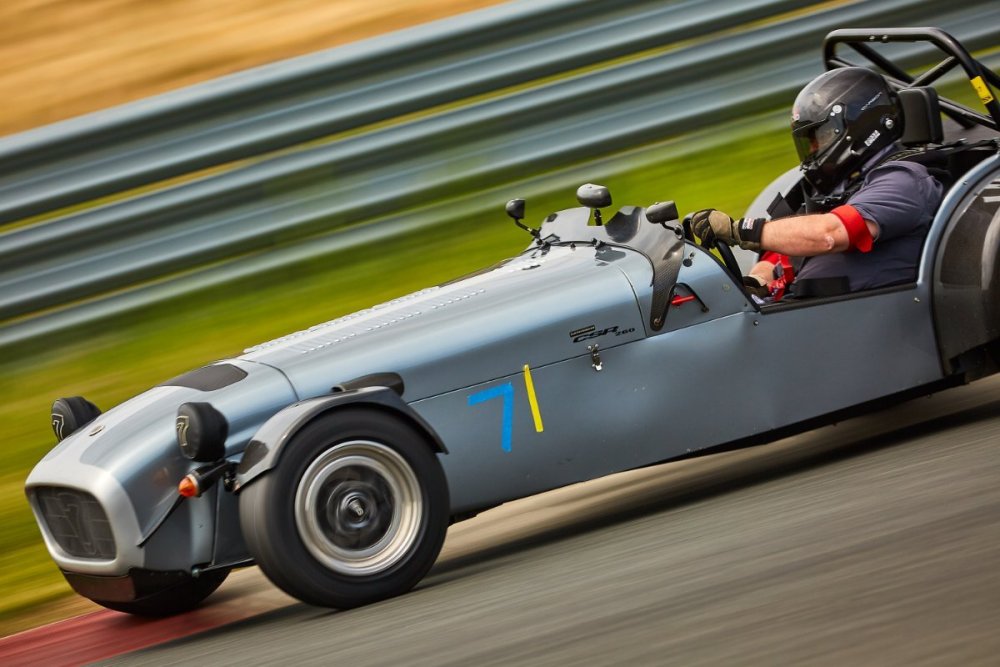

47 minutes ago, Sevins7 said:
I will look into installing a kill switch. Anyone got ideas or a circuit diagram, switch type?
This is the type normally installed on Caterhams
Master Battery Disconnect Switch Kit — Beachman Racing
Should be instructions in the kit (he says hopefully).  Caterham parts also stock it but I could not link them as their website was down for me.
Photo shows usual mounting point on side of scuttle within reach of driver's left hand - its the red switch with protective eyebrow.
