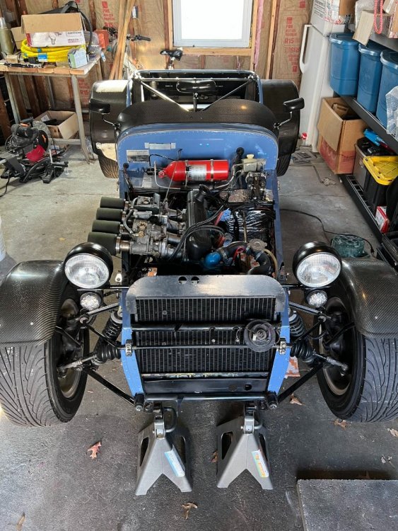

First, Here is a photo of the car as she sat prior to the start of the refresh. exterior wise i don't anticipate changing much. She sits on 14" panasport minilites with yokohama tires that are old but we'll be swapping for some toyos this season.

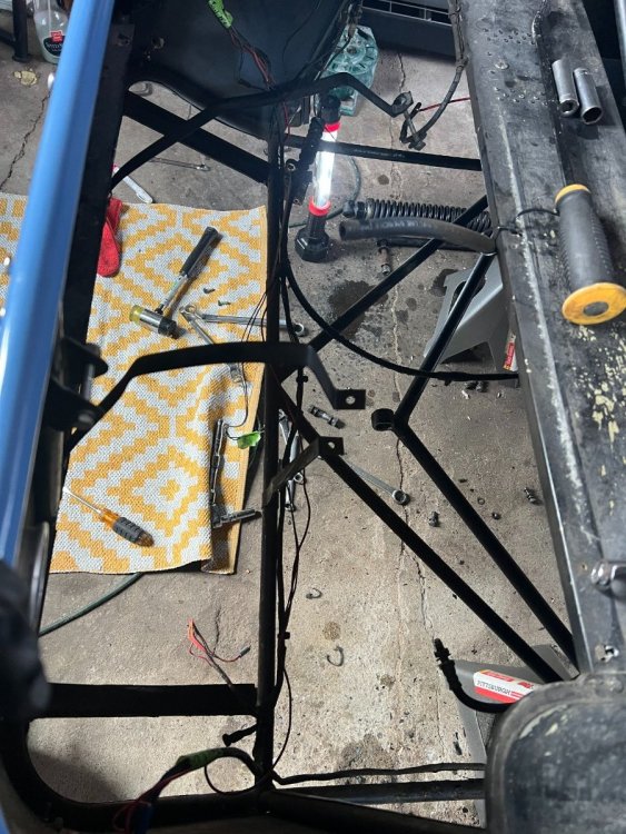

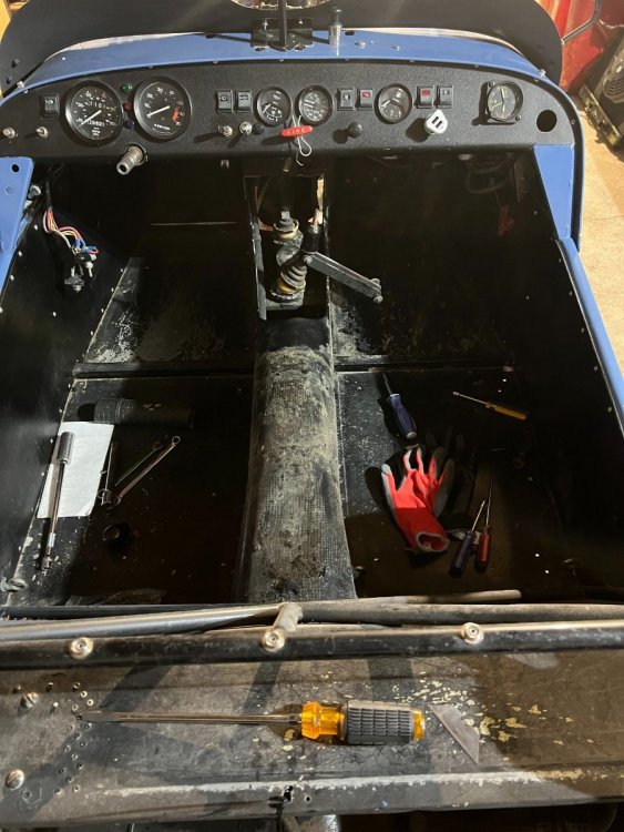

-Interior seats and carpet have been stripped out (The panels over the outer chassis members will remain). Contemplating if i want to remove scuttle, but will most likely have to as i will need it off for sorting, rewiring the car. lots of loose wires, cut ends and dodgy connectors there!

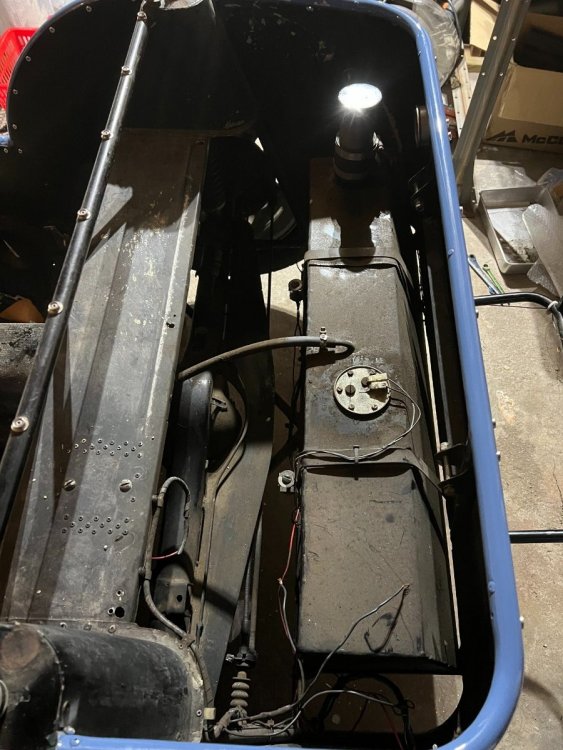

-trunk has been stripped out (removed and inspected fuel tank). Lots of 30+year old dust built up there!
I plan to add some anchors for harnesses, however i have noticed that most Caterhams have a square stock or flat cross brace at the top of the seat back (which makes it easier to add said anchors). Many parts of the chassis in my car is round stock including this cross brace so i need to decide what to do about this. May cut and weld in square stock or drill through and reinforce with bracing... more to come on that.

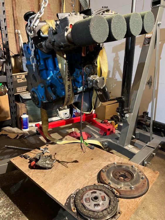

-removed engine and trans today. Plan to relocate the radiator forward to under the nose cone area. Still deciding which rad to use. I have a brand new rad that was supplied with a 1984 build but not sure if i want to run that. Thinking of a new aluminum rad instead. Also will be installing header tank.

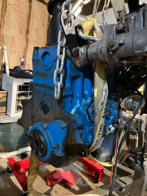

This is where i am today. Taking stock of the parts i have and still learning the platform:
Engine:
Was rebuilt and runs strong but carbs need dialing in. some oil leaks under carbs (cyl 1 and 2) and a few other minor leaks but other wise all good. front and rear main seals look fresh but will will replace regardless. I have a lot of consumables i purchased from Chris at redline but is there another source for crossflow parts in the states?
IMG_0533.thumb.jpeg.7c488bbd2cd46031c5273172766e57cc.jpeg    IMG_0532.thumb.jpeg.bb09c05f5f1fdbadb2be0581ac45c96a.jpeg

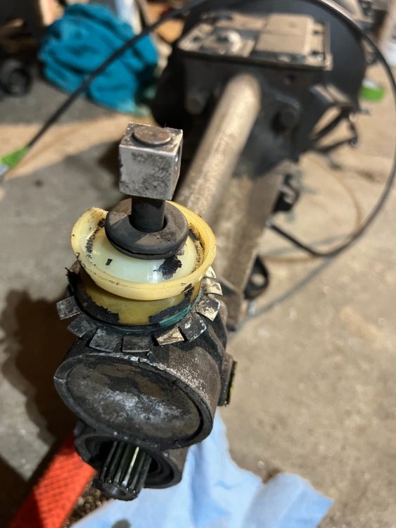

 Trans (4speed Ford):
In overall good shape. Will change fluids. Need to make sense of he clutch slave cylinder used here. Also the clutch fork was not connected at the retaining clip in bell housing and not connected to throw out bearing...very strange and explains why clutch actuation was dodgy... Clutch itself appears fairly new and will likely be reused. Any help positively ID'ing this trans?
IMG_0511.thumb.jpeg.668ee053248919cbd3af9774e35a75c9.jpeg     IMG_0512.thumb.jpeg.5f26845dc79e2d5b13cc8dbaf0e600b9.jpeg
Does anyone know if / where i can replacements of these shifter bushes on the trans?

What a great project!  The transmission looks like it could be the Ford Type 2 as shown here in the Burton's catalog.  Might be a starting point to pursue if no one knows definitively.

Thanks! why didnt i think to check Burton! i order alot from them already for my other cars. I just confirmed with Burton, that it is a Type 2 box, and Anthony who i spoke with promptly suggested that i consider changing it out if i plan to do any sort of hard driving!
The goal is to make your 7 better, and changing the gearbox from a Type 2 to a Type 9 is... 7 better. :classic_smile:

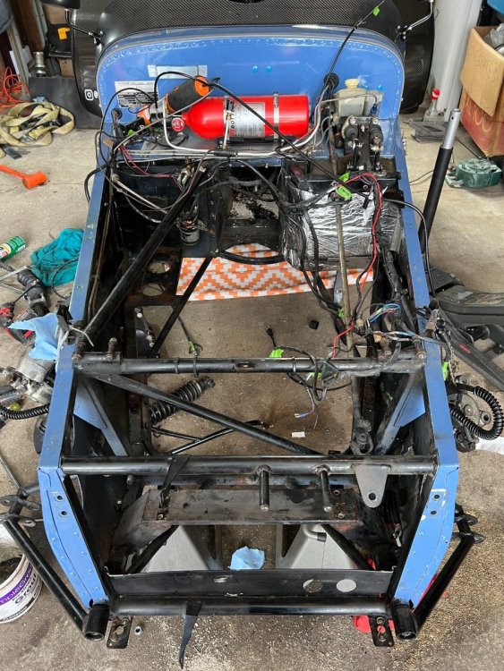

That said, Made some progress today disassembling the front end ( lots of consumables need replacing, bushes etc). Will also be refinishing hardware.
Front end disassembled, less lower control arms:

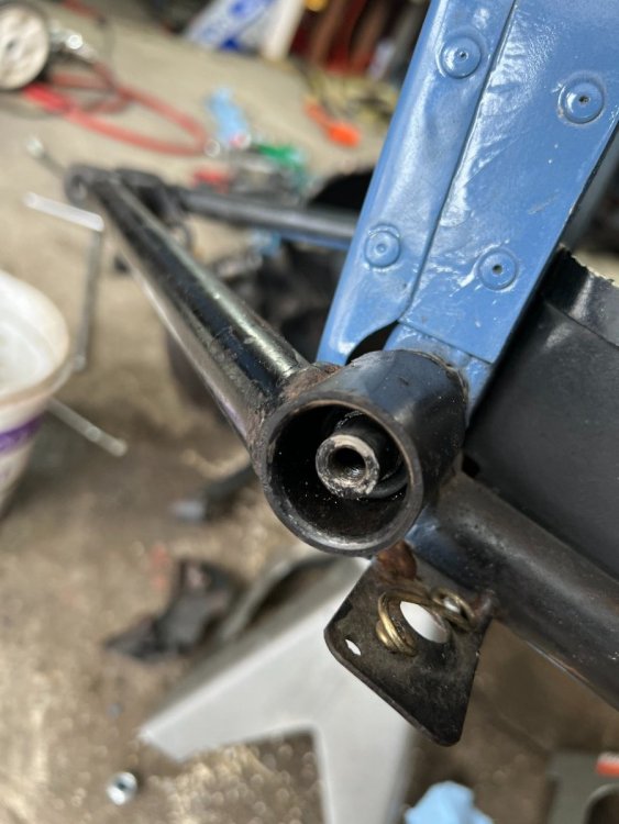

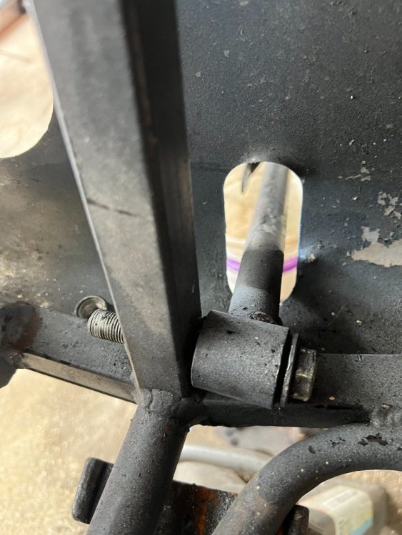

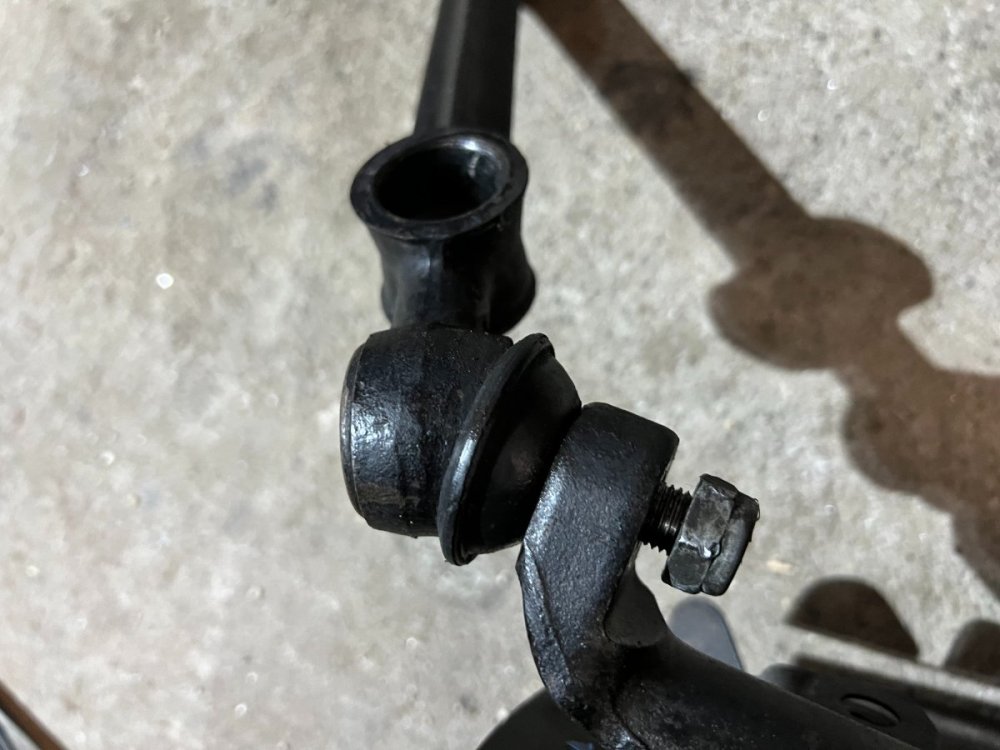

Question- Does anyone know what two perpendicular brackets coming off the upper and lower front chassis rails are/were for?
Having a royal pain in the rear getting the lower control arms off the chassis and the upper control arm off the hub...have thrown the book at them but they wont come off.  Any tricks to this? it shouldn't be this hard to get off. The bolt in the back appears to be seized on the bushing on both driver and passenger side, but i wonder if i can get the whole arm off even if i got those bolts out, since there's not enough play in front of the rear section of the arm (to the square stock chassis member), to slide the front section of the arm off it's threaded sleeve... hope this all makes sense. it essence, it appears to be wedged in.

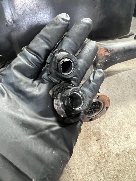

The good news is that the bushes on the lower arms are in very good shape and the arms move freely, so worst case, i can keep them on the car for the refresh. It would definitely be easier to get them coated/painted off the car but nothing some careful masking wont do.

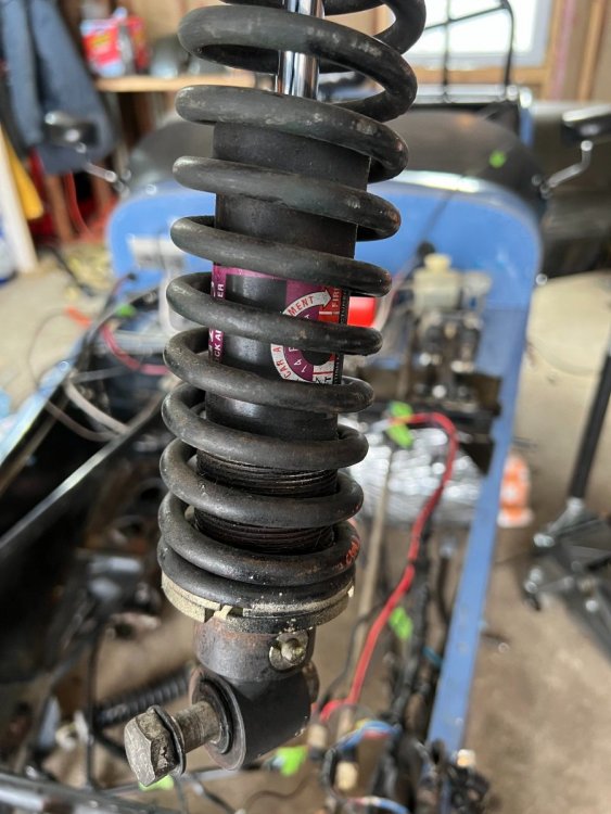

Coilover assembly - Appear to be cosmetically beat but still in good working order without leaks. Ride height and dampening adjustable-  Part number Spax G775. What is the good word on these? Would they have been original or upgraded units. I suspect they will be good enough to run after cosmetic refresh.

Re. upper arms
the best way I've found to remove a ball joint/tie rod end is to whack it with a dead blow hammer.
in your pic above, you want to hit it down on the end of the upright  what you'll do is compress the sides of the tapered hole just a bit, and it will squirt the stud out.
don't worry about distorting the hole, the stud being inside will prevent that
leave the nut on, in case you miss

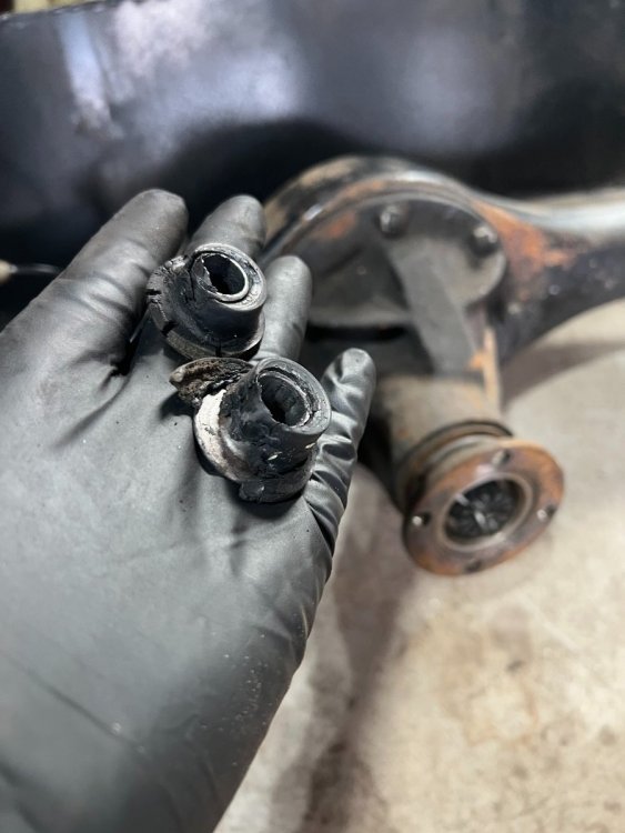

I'm assuming the lower arms have want they call a silentbloc or metalastic bushing in them. This is an inner and outer steel sleeve with rubber molded between them. Bolt thru center and outside presses into end of arm. For the bolts stuck in the bushing, your only choice may be to put a big bar on the bolt, and just rip the rubber center out.
For replacements, call Eileen @ GMT Racing, she can send you a list of the sizes they stock  -about 20  -in your neighborhood, and good folks
Have you tried this style of ball joint separator?  I used this one from HF on a particularly stubborn set of front ball joints on a 993.  I cranked it down really hard on the first one until I feared something would break, then let it sit in place while I prayed to various deities.  After about a minute, there was an unholy bang and the ball joint popped out.  The tool created enough force on the other ball joint that it actually bent the threaded end which then had to be removed with a cutoff wheel.
-John
Assuming you aren't going to reuse the ball joints, then I'd try a pickle fork.  And if you don't care about destroying paint or bushings, then heat may be the answer for the upper control arms.
Regarding the coilovers, I'd go ahead and have them rebuilt.  Springs are probably fine but imagine some oil loss and that which remains is probably due for a change.  If I'm wrong and they are actually gas units, then I'd assume that gas has escaped.

So earlier this evening. I got the rear end off! after reading Mike (Croc's) thread about the bushes on the rear A-Frame, i was eager to check mine out as well...Take a look!
Question: is the a readily available (somewhat direct swap) LSD option for the live axle? Just out of curiosity and for my personal edification i will check out quaife.
@Pokey Any leads/ideas on where to get a rebuilt done? I remember a few years ago, i asked all the race shops around me about rebuilding the bilstein shocks on my Cossie coilovers and none were willing to take it on. I looked online and the pricing for new units doesn't seem too bad for all four corners, even with UK shipping; will have to compare that with rebuild cost.
Edited by NSXguy
first, you need to know if your shocks are rebuildable at all. Can't tell from the pics. Do they have a top that can be removed, or just a welded cap?
I checked into it a few years back, mine were not serviceable, but new ones weren't much more than rebuild would have been. I called Spax on Monday, had them Thursday.
I believe Spax has a deal plan for the Westfield club, you'd think they do Cat too.
