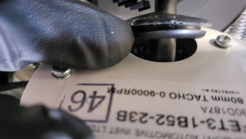

KnifeySpoony Posted May 17, 2022 Posted May 17, 2022 1. That idle sounds right - what happens after that? 2. check the dipswitches on your tach - CC seems unable to set them properly 3. TADTS 1
sainthoo Posted May 17, 2022 Author Posted May 17, 2022 1 hour ago, KnifeySpoony said: 1. That idle sounds right - what happens after that? 2. check the dipswitches on your tach - CC seems unable to set them properly 3. TADTS Please assume I am the dumbest person you have ever met… ”dipswitches” you say? TADTS you say? It surges constantly at the moment- normal, little RPM increase, then back to normal.
Austin David Posted May 18, 2022 Posted May 18, 2022 (edited) The ODB reader will help. My idle was low on first crank, and the tach was way wrong. I read the manual and found a switch configuration that works, eventually I "should" get the ECU flashed correctly, apparently. For now it's right. https://usa7s.net/ips/topic/13594-360s-in-charlestonish/?do=findComment&comment=125828 With an independent signal from the ECU (not the tach) you can set your idle correctly, and deal with the tach later. Like when everything else is correct. The fuel gauge seems very pessimistic, and mileage (mine at least, during break in) is absurdly high. Below 1/4 it will maybe take 5 gals, and I believe capacity is near 10? In the garage (as you are) I basically kept the needle where I could see it at all. The first 2g was enough, then added more as I went around dealing with various coolant issues. Edited May 18, 2022 by Austin David 1
