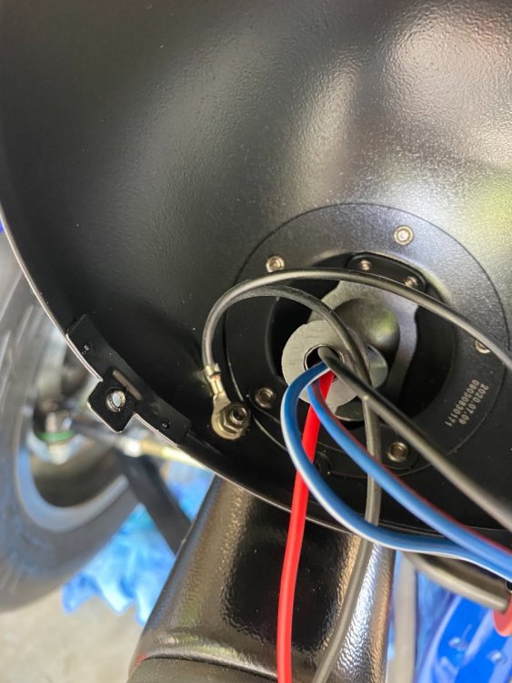

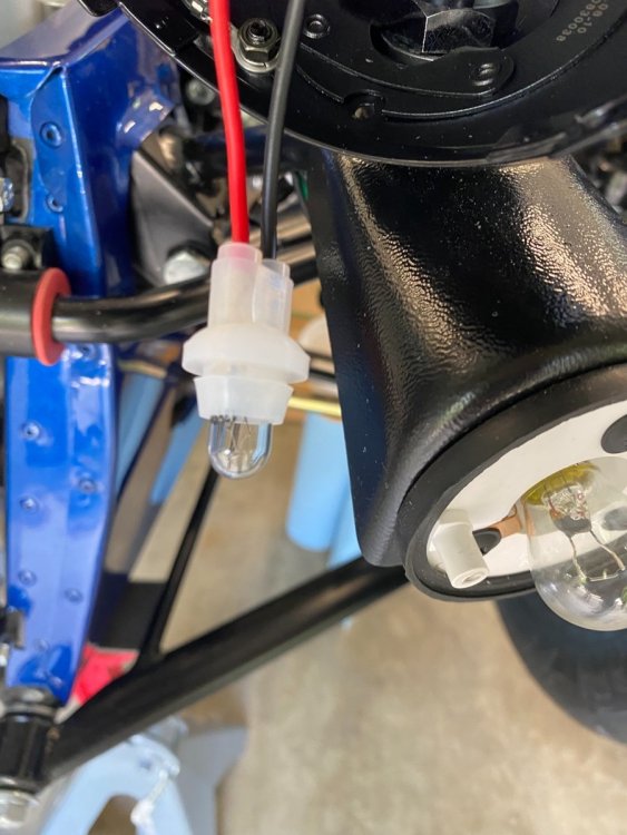

New fun: little bulb inside headlights (seem pointless?) would not work. On the left- connection for bulb was bent. In the right- ground was faulty.
left:
right:
I got the LED headlamps and I LOVE them.  I assume that bulb is for a "parking light" function?
In terms of the ground, you're going through a few layers of powder coat at the shock tower and at the headlight base -- it doesn't conduct well until you at least snug up the mounts at both ends of the little support arm.

Yep all settled- just aggravating that this is necessary.
Tell me you're still early in your build without telling me... :-P
Count yourself lucky if this is the weirdest of it.  The upside is, having built it you'll be best able to debug it later.

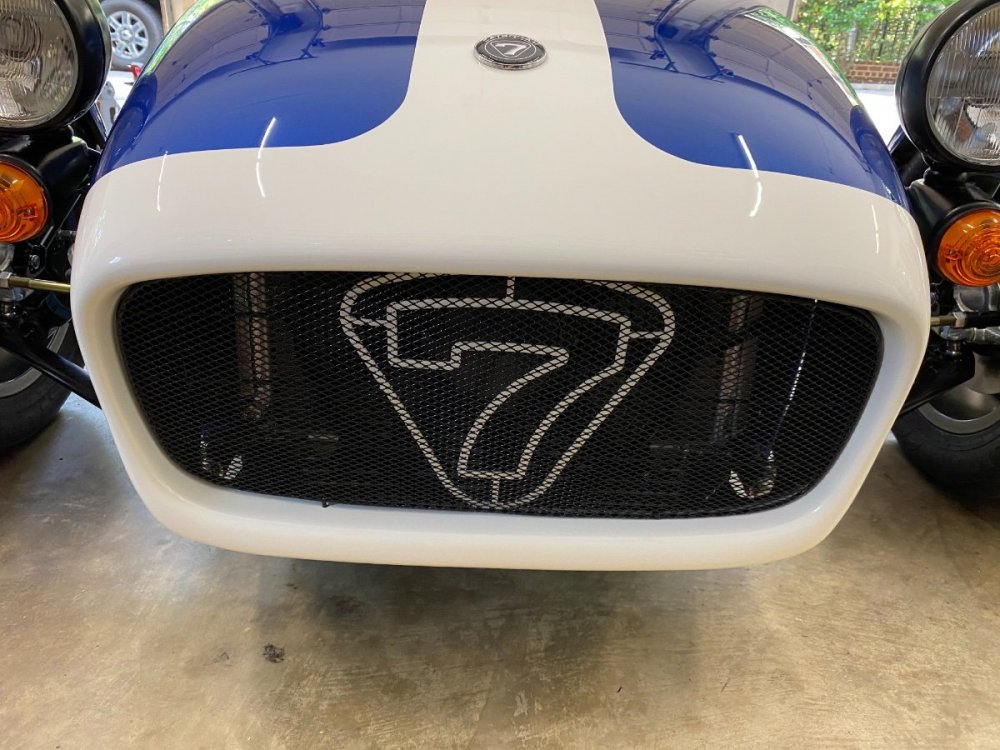

So, I can’t believe it, I’m basically done.
(I still need to sort out speed sensor. I need to get brake pedal a bit more firm)
Josh sent me back my ECU with the most up to date tune (with this tune, I had to adjust TPS from 1.23V -> 1.33V). It was like magic- car running perfectly in 2-3 min.
Not quite on terra firma:
First time on the ground:
a beauty:
F38B6929-F50F-4995-8D50-CB6D8AC43923.thumb.jpeg.61110178a6f3440841ae9e665ca691a9.jpegBC176FA9-C7A7-4D83-8C06-8592508CA56F.thumb.jpeg.467aa03baa251cd1eccc2cb8c1f40321.jpeg
Any advice on speed sensor or getting brake pedal more firm- I’m all ears.
