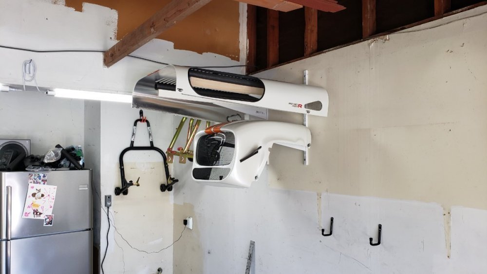

KnifeySpoony Posted March 7, 2022 Posted March 7, 2022 Definitely worth setting up something like this, IMO. 1

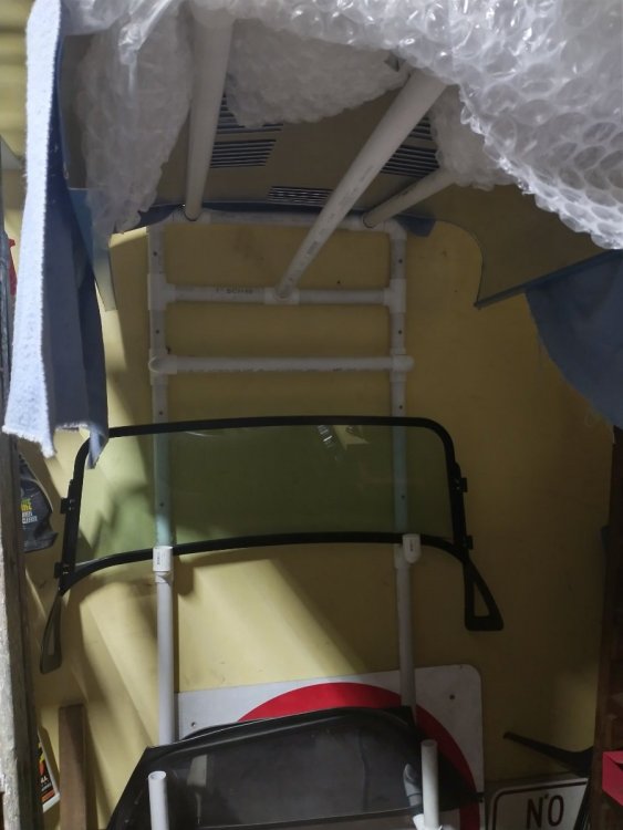

Vovchandr Posted March 7, 2022 Posted March 7, 2022 46 minutes ago, KnifeySpoony said: Definitely worth setting up something like this, IMO. I've seen that and built something very similar. Nose cone isnt on it right now but hangs in a similar fashion, just faces the other way. It also holds the doors and the windshield. My hood part also folds up when not in use. Pardon the mess, too cold to clean the garage over winter so things pile up

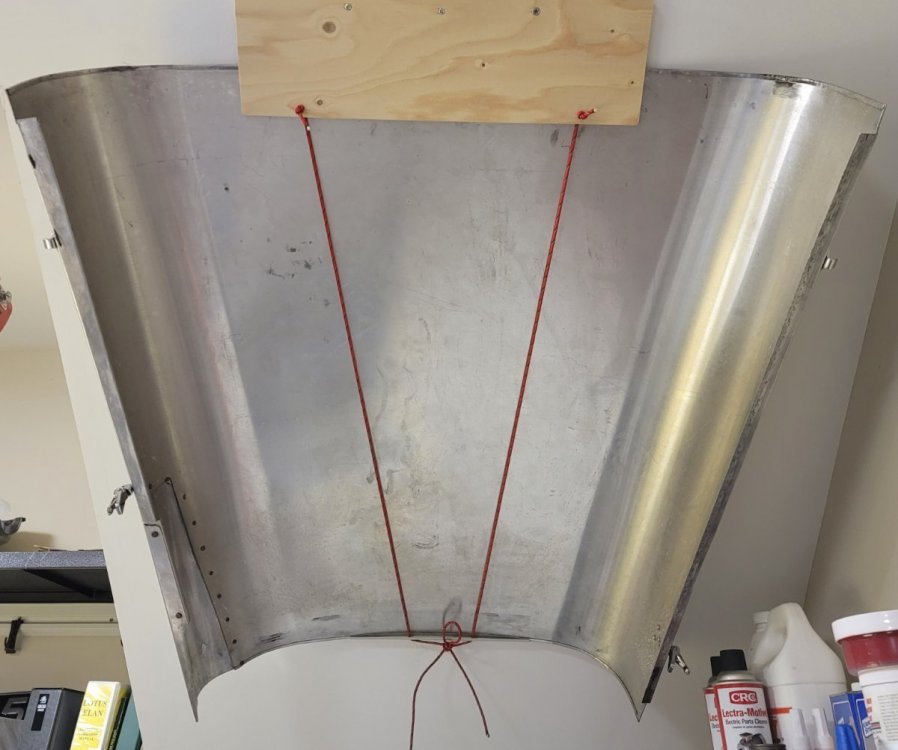

IamScotticus Posted March 7, 2022 Posted March 7, 2022 Just did this today. No I didn't like drilling into my bonnet but I decided the storage benefit outweighed the mutilation.

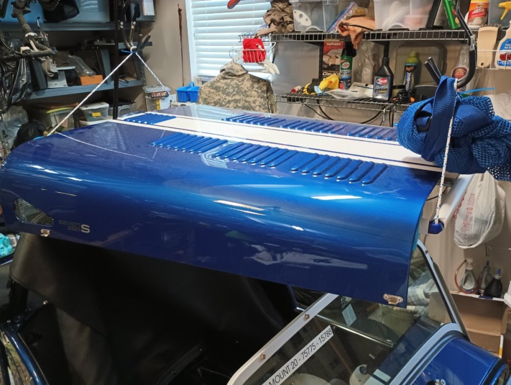

Taber10 Posted March 7, 2022 Posted March 7, 2022 Ben Wolford of Rocky Mountain Sportscars gave me the info for this bonnet rack, and practically insisted that I get one, as he didn't want me to damage my bonnet. Of course, I only use them for a few minutes normally as I check oil, coolant, etc. I haven't done any prolonged maintenance in these garages. Basically some plumbing fixtures, and a "pool noodle" for padding. 1

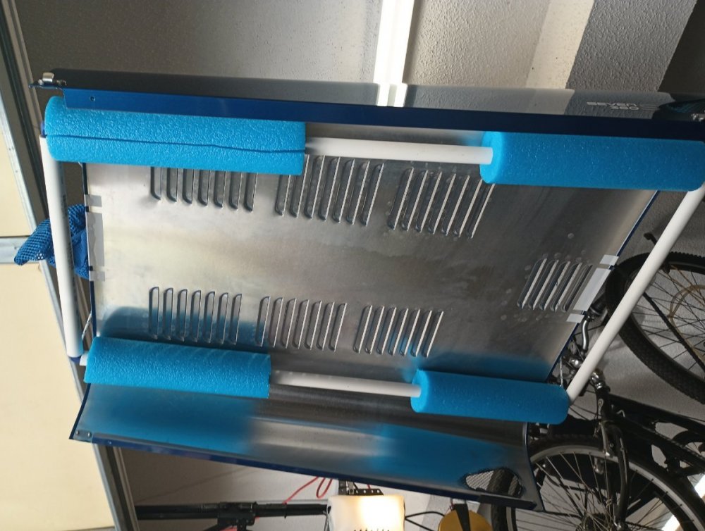

Austin David Posted March 15, 2022 Author Posted March 15, 2022 Thanks to all for sharing your ideas. I mocked up a frame with 10' of 3/4 PVC, a pool noodle, and some 3D printed elbows. I hung that from my existing kayak sling, which formerly held a top for a different car. This works great. I can mount the bonnet with the car in its spot, and it can live up and out of the way. But hopefully not for much longer. 1
