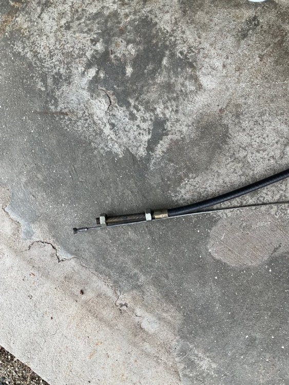

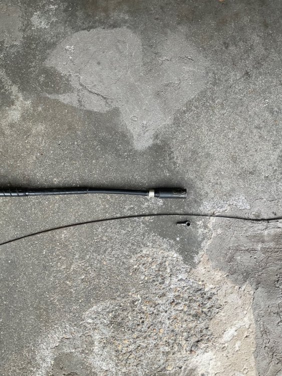

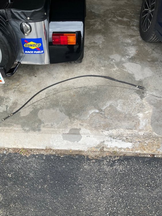

ChuckM Posted April 16, 2022 Posted April 16, 2022 My cable broke this morning so I’m in dire need of a replacement unit, measures approximately 67 inches, I have attached pictures for clarification. If you have this item please let me know as soon as possible, thanks for looking!

MV8 Posted April 16, 2022 Posted April 16, 2022 Just in time for Spring! Looks like mk3 cortina or escort ends but 2-3 times as long. There are companies that swage cables while you wait but it is a question of having the right ends and if they are willing to make a part for a road vehicle or swag a new rope in a used housing. I don't know of any domestic application using similar fittings and length. A universal six foot 4300 series marine control cable is likely much better quality than the original cable and comes with 1/4-28 threaded ends but if going to that much trouble, why not hydraulic? By the time you do all that, your new cable and spare that you probably ordered in March will have arrived. The bicycle and bike parts are very thin rope which will stretch.

IamScotticus Posted April 17, 2022 Posted April 17, 2022 (edited) assuming you're LHD with a right side fork, you want the 5 foot cable, they are the last two on the Burton site, CCESCYB1 170 cm / 5.5ft CCESCYB2 173 cm / 5.67ft What makes our cars made for the Mk1 Escort difficult to cable is the eyelet on the pedal end...that didn't continue on many other cars. Also, cables from "First Line" are notoriously unreliable. if that's all you can get, get a few. thats where they break at the eyelet. Edited April 17, 2022 by IamScotticus

MV8 Posted April 17, 2022 Posted April 17, 2022 4 hours ago, IamScotticus said: they break at the eyelet. Problem solved but thinking out loud, a mod to reduce eye friction and keep the cable from flexing at the base of the rigid fitting with something semi-rigid would greatly extend the life. Maybe a split piece of plastic then wrapped with the fitting shank in a good tensile strength tape would do it but not pretty. I wonder if the other design pedal with the hook and oval-squarish eye turned 90 deg works better. At least the design is more common. A 300 lb tensile is about all that is needed considering around 45 lbs of foot pressure with a 5:1 pedal.
