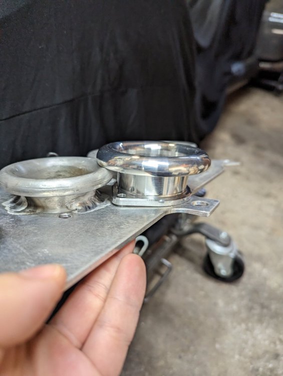

Vovchandr Posted February 2, 2023 Share Posted February 2, 2023 (edited) 21 minutes ago, 1turbofocus said: Any Focus Zetec Core even the stock 130 whp Tom Can't help you with a stock one. I only have a modified one with ITBs that makes 130whp I finally ordered the proper venturies. Maybe I'll get a few more hp after them - Vlad Edited February 2, 2023 by Vovchandr Link to comment Share on other sites More sharing options...
wemtd Posted February 2, 2023 Share Posted February 2, 2023 May not help you; but I have a set of ‘spare’ ATpower ITB intake horns. (I received the wrong part, so it’s a spare now) Link to comment Share on other sites More sharing options...

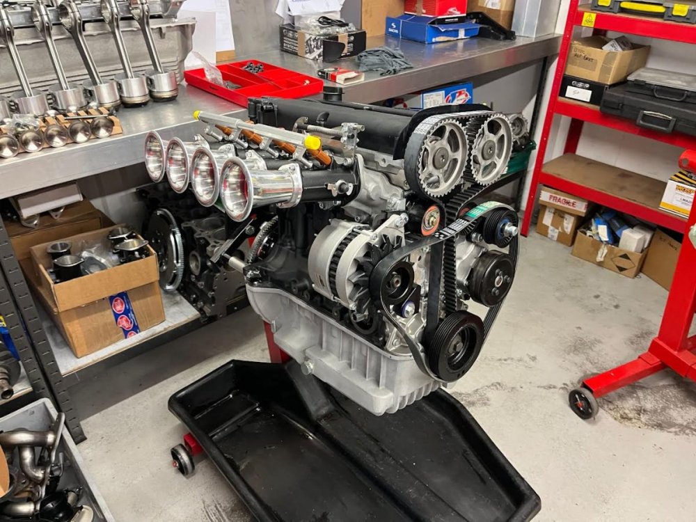

linenoise Posted July 25, 2023 Author Share Posted July 25, 2023 Getting closer... replacement Raceline Zetec engine will be headed to the dyno soon. 4 1 Link to comment Share on other sites More sharing options...
linenoise Posted October 7, 2023 Author Share Posted October 7, 2023 She lives! New Raceline Zetec installed and running beautifully. 1 Link to comment Share on other sites More sharing options...
