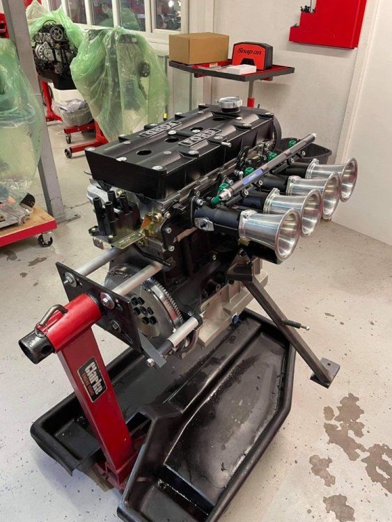

Hi there,
I followed a similar route as you and ended up with a New Raceline Zetec, I went for the 250 HP option which when run on the dyno actually topped out at 261 at the crank, attached are the dyno results.
I decided not to use the Omex ECU as I wanted to use paddle shifters and the choices were Omex ECU with a geartronics GCU piggybacking on it or using an ECU that had the facility for real timed and monitored closed loop flat shifting, I finally went for the MBE9A9 ECU with a pneumatic shift as I hope that a single unit rather that two separate (ECU & GCU) will be more reliable with one less point of failure, the whole thing is a little complex but not so hard to figure once you get into it and the software they (SBD) use to map is pretty easy to understand.
I cant speak to the harness needs of the Omex, but for the MBE I had to make an entire new harness, which was, errr.... time consuming and expensive ! I leaned heavily on Andy Jupp at PGM motorsports in the UK for that he was really good and very attentive to the details, I attached the as built version of the harness below if you're interested.
Overall I am really happy with Raceline, they can be a little slow to respond to emails so I always called Chris or Peter if I had questions and they were super helpful. In the end I have what I wanted. I expect to finally have the whole ensemble on track in March so then I will really know if I chose wisely or not. Either way I am in the same boat as you, I will never get my money back if I sold it, but I did not build it for that, I plan to track the tires off it for years to come.
