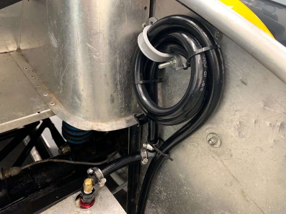

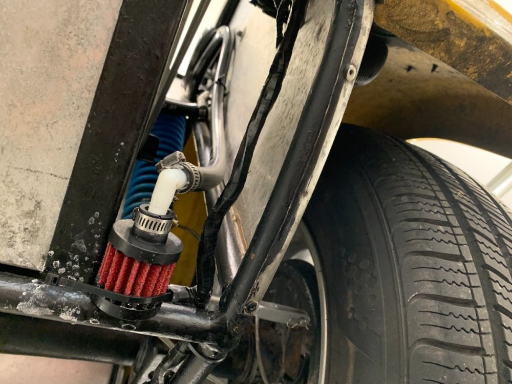

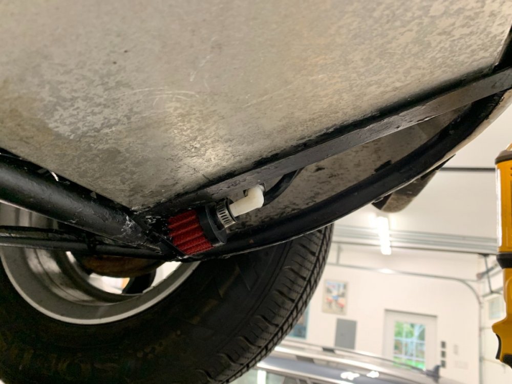

wdb Posted October 4, 2022 Author Posted October 4, 2022 (edited) First bit of sorting is to control the vapors emanating from the fuel cell. Our garage is insulated and fairly airtight, and the fumes build up in there when the car sits overnight. I poked around and found that the fuel cell vent was just sitting there open to the atmosphere. No kind of piping at all. Taking a left turn 'with enthusiasm' would cause fuel to slosh out. I bought a little vent filter from Summit Racing, which looked very cute but did little for the sloshing and zero for controlling vapor emissions. Google to the rescue, I hope. I found some general instructions on reducing vapor emissions from a fuel cell and used them to fashion a solution for my situation. The basic idea is to have a few loops in the vent line, higher than the filler neck. Easy in my case because there is none. From there the vent line should run down to a point below the the bottom of the fuel cell. http://www.radiumauto.com/Fuel-Cell-Vent-Kits-P1518.aspx First image is from that link, the next 3 show my interpretation for the Caterham. Hopefully I've made better use of the cute little Summit Racing filter. This morning the garage still smells of 93 octane, but not as strongly as before. I may need to do another cleanup of the overflowed fuel to get a full, fair test of the vent. Edited October 4, 2022 by wdb 1

wdb Posted October 4, 2022 Author Posted October 4, 2022 The fuel cell vent connector contains a rollover valve. It's logical when I think of it a bit, because this car was originally intended to be raced and subsequent owners have maintained that objective. I did look into charcoal canisters but didn't love any of the solutions I saw. Short of designing and constructing my own version of a modern fuel vapor recovery system, which seems to me to be antithetical to the car. I'm not completely abandoning it as a solution though. I'm not certain of the full science behind how the loops are intended to function, but part of it is definitely to stop vapors from escaping. If this afternoon's whiff of the garage is anything to go by they are working. Also I think the rise from tank to top of the loops is sufficient to keep sloshed gas from making its way up and over, especially if I am careful not to fill the tank too much. (A functioning gas gauge would help but this cell is not so equipped.) 1
Croc Posted October 5, 2022 Posted October 5, 2022 Your solution with the rollover valve, the loops of tubing, and careful placement of the vent is how I did it on my 65 Mustang and BMW. Works just fine. I'd vent the garage and see if it stopped the problem. If not then have a look at all fuel hoses to make sure you don't have a vent somewhere else that you should not. 2
MV8 Posted October 5, 2022 Posted October 5, 2022 That's why I mentioned "works properly" because a vent line with fuel in it doesn't vent. It will push the fuel out to the ground if the delta is great enough. The loops are essentially the same as a P trap on a sink preventing vapors from escaping the septic tank. The tank must vent out for thermal expansion and in to allow fuel to leave the tank to reach the engine. The details of actual use and conditions will determine the balance and how effective it is at keeping fuel from being pushed out of the hose on to the ground. An evap system does not have to be bulky, ugly, or complicated. The simplest system removes the odor, reduces moisture collection from using ethanol blends, and cuts fuel evaporation emission by about half. For a passive purge evap system, assuming a filler cap that normally only vents into the tank, you need: 1) a small charcoal canister 2) a roll over/pressure check valve with a hose fitting 3) a 5/16 fuel hose between them 4) a 5/8 heater hose on the atmo side 5) To keep out water and bugs, some window screen and zip tie to hold it on or a breather like you have on the other end of the canister that cannot let bugs and water enter the can. That's all it takes. Weight is minimal. No engine driven purge. Direct tank mount: https://www.fisheriessupply.com/perko-tank-mounted-fuel-tank-vent-line-valves-epa-compliant/0588f00 No tank mod inline fuel/air sep/surge tank: https://www.fisheriessupply.com/perko-air-fuel-separator-epa-compliant/0488001 A 1/2 liter can that will last as long as you keep water and fuel out of it: https://www.fisheriessupply.com/perko-marine-carbon-canisters-epa-compliant/0486005035 It is best to have the can above the vent valve or separator. For no tank mods, a line off the tank vent horizontal to a corner to put the separator as high as practical near a coilover, then down to a low mount canister should prevent any fuel reaching the can. Since this is not a required system, you can use whatever you want. For lower cost, automotive valves, a diy surge and can could be used. The can is just that; charcoal aquarium pellets with filter material on each end to keep the bits from migrating out and a spring loaded plate to keep them compacted so they don't move back and forth from vehicle motion and abrade/crumble into powder. Auto cans typically have a plug in the purge line somewhere with a tiny hole to limit the amount of engine driven vacuum applied to purge so that could be removed and left open to passive purge with water and bug protection. 1

wdb Posted October 6, 2022 Author Posted October 6, 2022 (edited) On 10/5/2022 at 5:25 AM, MV8 said: That's why I mentioned "works properly" because a vent line with fuel in it doesn't vent. It will push the fuel out to the ground if the delta is great enough. The loops are essentially the same as a P trap on a sink preventing vapors from escaping the septic tank. The tank must vent out for thermal expansion and in to allow fuel to leave the tank to reach the engine. The details of actual use and conditions will determine the balance and how effective it is at keeping fuel from being pushed out of the hose on to the ground. Thanks for the details. That setup is pretty much where I was before finding the looped line solution. I don't think the loops function the same as a sink trap. Those keep liquid in the trap section to prevent gases from passing. They're one-way valves. I suspect the loops in the gas vent might allow the vapors to condense somewhat rather than escape, or perhaps they take advantage of the difference in density between air and fuel vapors. Given the vertical rise and the number of loops I do not expect to see liquid fuel making it all the way through, except perhaps if I were to spend a few minutes maxing G's on a skidpad. I'll just have to wait and see if the system is capable of affecting fuel delivery to the engine if liquid fuel does actually pool in the loops. The remnants of Hurricane Ian finally decided to mosey off late yesterday, so maybe today I can finally go for a romp---errr, perform some real world testing. Edited October 6, 2022 by wdb
